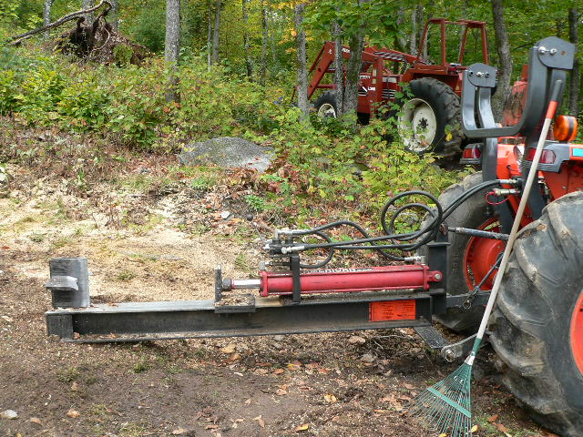

I have a 100 HP tractor and it is VAST overkill to run a splitter. I run it off a Kubota 3710....... 35 HP..... vastly more torque than needed. I will overload the hydraulic pump into PRV mode way before I even notice a drop in rpms of the 3710's diesel engine. 100 HP tractor is just going to use 3x as much fuel and you will get nothing out of it.
The hydraulic system on the Hesston 100-90 I have puts out about 2500 PSI, pre PRV actuation, essentially the same as what the hydraulic system on the 3710 puts out.
If I had to use my big tractor to run my splitter, I would have purchased a stand alone splitter instead. The 3710 was the perfect size tractor for me to run a TPH splitter, not the least because the exhaust pipe is pointed towards the front of the tractor, rather than out back towards the work station.....

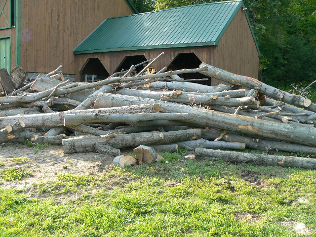

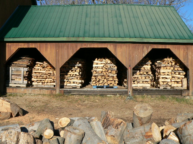

I skid all logs to a cutting yard immediately in front of the wood shed..
Doesn't this end up getting dirt all over the wood and result in dull chains?
   / Log splitter buying ? #26
Technique, brother...... all in technique.
I noticed your pile of logs looks remarkably free of dirt, so you must have it perfected. Do you drag them high?
HP is not the reason some guys might run a 100HP tractor on a 3pt splitter. Hydraulic pressure also is not the reason. The reason is hydraulic flow which translates into cylinder speed.
Everyone's idea of a fast splitter is different, which hopefully won't turn into an argument as it usually does.
I built a 3pt splitter and ran it on my little Kubota B2910. But I used a PTO pump. I hate waiting on a splitter.
Wouldn't that be "carrying" them Tom. :)
I can't do the drag em thru the mud/dirt/snow thing. You'll end up shoveling some of that crap outta the ash box in the end.
   / Log splitter buying ? #35
Well, I don't know, he said he skids them. I often cut trees at the edge of a field so I can grapple them back to where I want them, but that doesn't work well in the woods unless you cut them short or have a wide roads between the trees. I thought maybe he skids them with the tractor end up high and just gets the ends dirty.
   / Log splitter buying ? #36
Yep, whenever possible I carry logs with the Grapple as well. Also block them using the Grapple. No more bending over, cutting into the ground, etc.
Yeah, I'd like to see his skidder as well.
