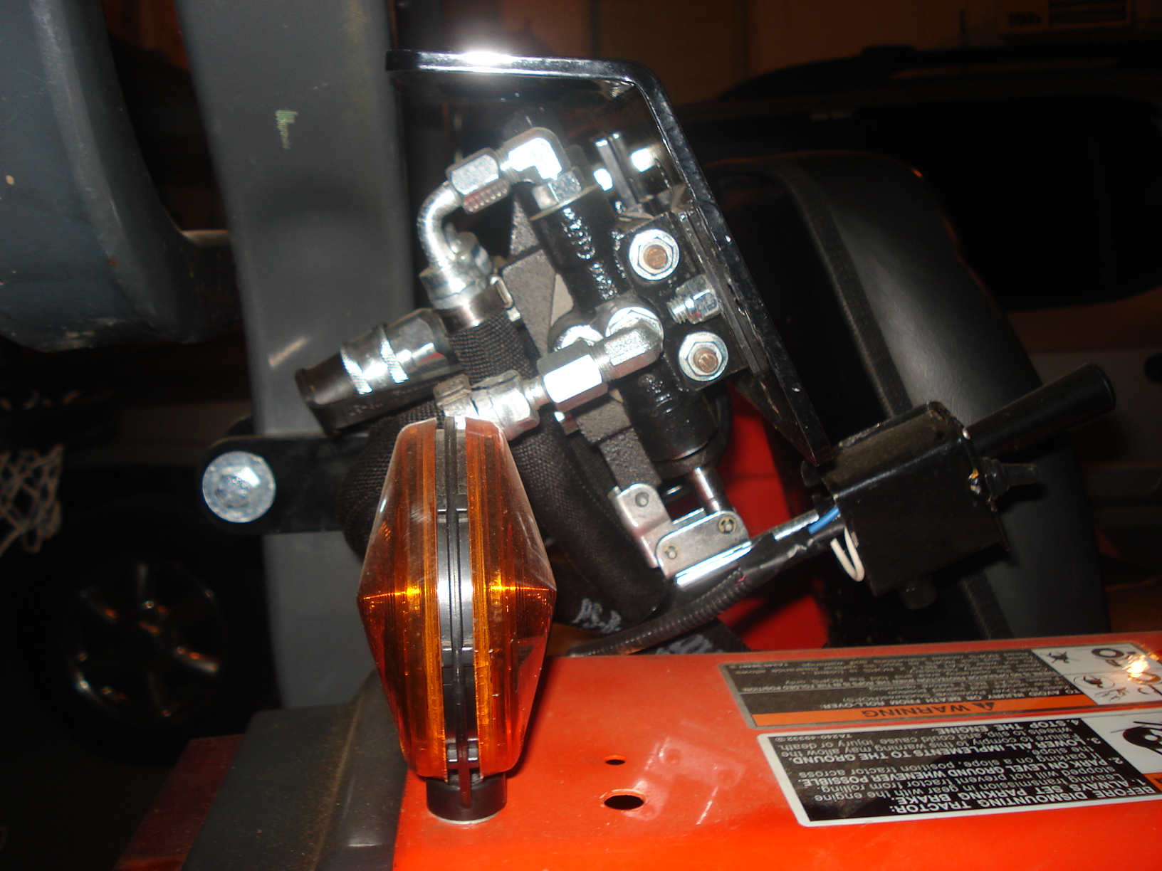

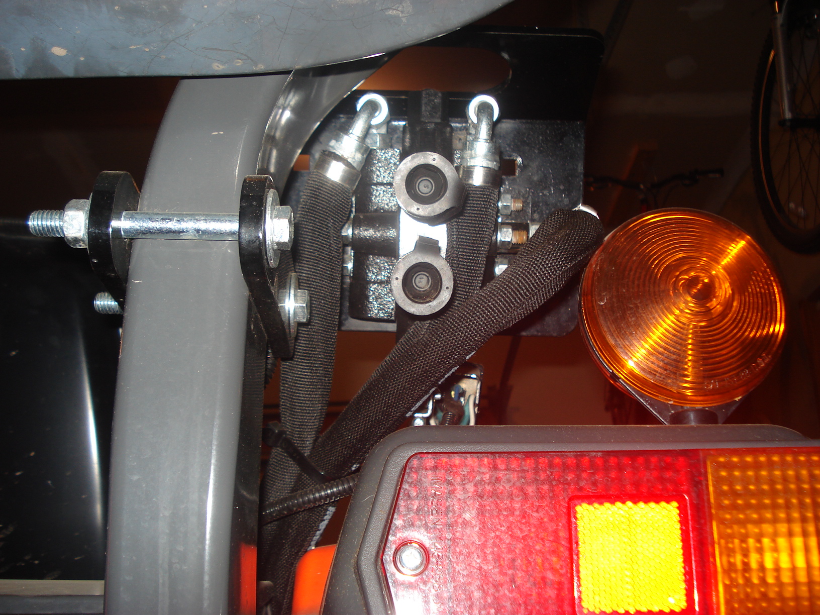

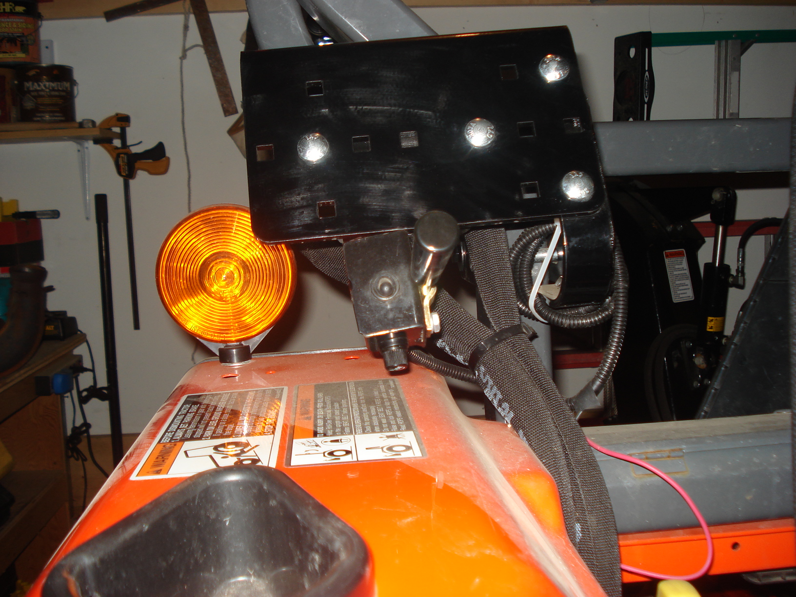

I am trying to get some good recommendations on how to tackle the installation of a 3ph mounted logsplitter. I have been looking at a ramsplitter 20T version, but don't know how to best install it based on my existing hydraulic setup. The attached pictures are of my BL7303 rear remote for the BL2664 snowblower's hydraulic chute & deflector. Should I install a separate set of rear aux hydraulics (if it's even possible) or connect the log splitter to the BL7303? How would I go about either? Thanks folks.

But..... you can A) Use your existing valve to feed the splitter by using a bungee cord or other device to hold the valve open (so the valve on the splitter is getting a constant flow), or B) install a 'power beyond' loop, the same as you would do if you were adding a backhoe.
/ Log splitter dilemma #4
I see no issue hooking it up to your existing remotes. The only issue is that you will have to use a bungee cord or some other means to hold the valve open so there is a continuous flow of oil to the splitters valve. The hydraulic oil will flow through your existing valve out to the work ports, through the splitters valve and back to the tank. When you pull the splitters valve, oil will be diverted to the ram to operate it and then back to the tank. I would neutral the tractor's valve (remove bungee) before using the 3PH or FEL as a precaution. I basically had this set up on my old BX1860 with dual rear factory QC's to operate a Powerhorse 13T splitter.

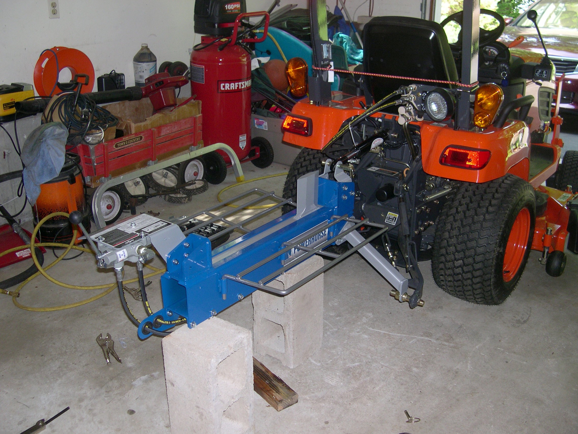

Here's a pic when I was installing it. I ended up plugging the splitter into the two open QC's at the back of the tractor and using a wedge to hold the tractor's auxiliary valve open.

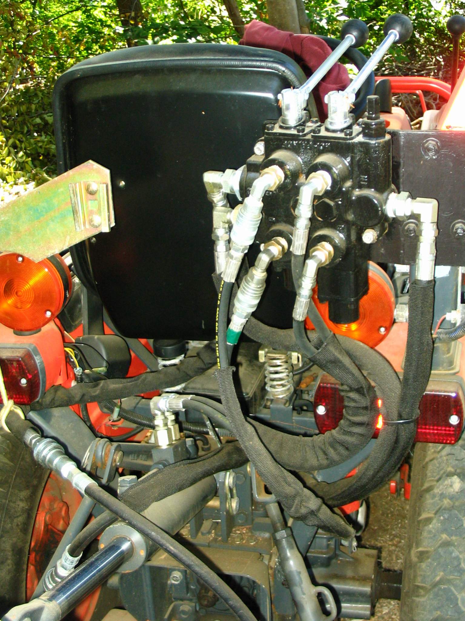

Do the above recomendations or replace the valve with one that has a PB (power beyond) and install a loop with quick connects (like a BH loop). Thats what I did...
I have dual remote, valve 1 = one bucket grapple, valve 2 = hydraulic top link, and PB for splitter
