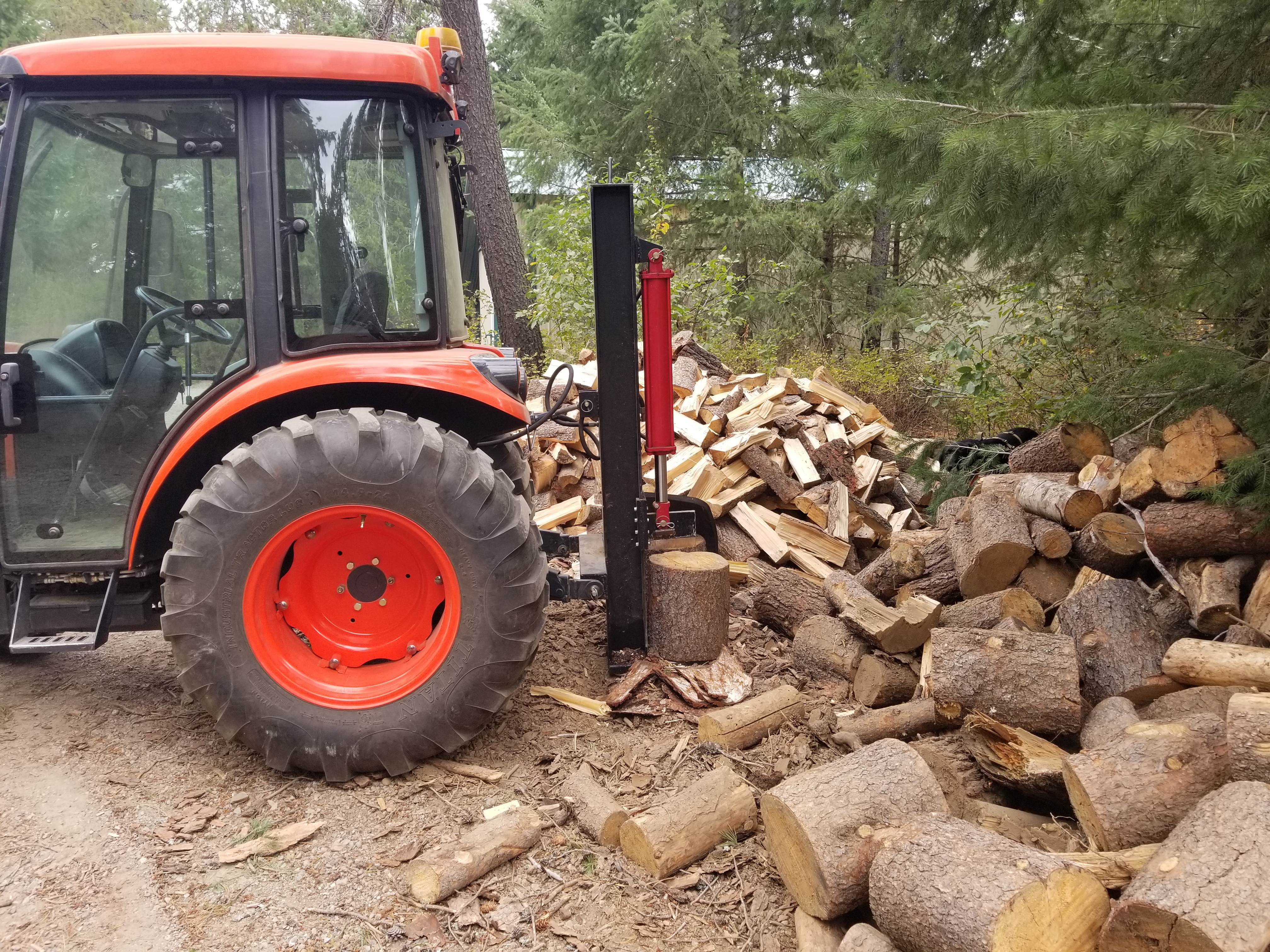

What type of valve is needed my a splitter do auto return of the ram hands free?
A "splitter valve" is made to do that.
Check "Hydraulic Supply" or Northern Tool.
A Prince Splitter valve sells for a bit under $200.
Be sure to match the valve flow to the pump flow (gal/min) or you will not be pleased with the sensitivity.

My splitter is vertical. Dont have to lift anything. Just roll it into place. I sit next to splitter. Easy peasy
