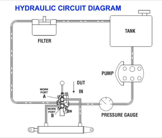

This s HF motor I used... Harbor Freight Predator 6.5 HP - 212cc - OHV (SKU 69727)
Seems adequate, though my splitter is rated at only 22 ton... Motor does grunt for a moment when pump drops in to secondary (?) mode and governor needs to play catch up...... But not a functional issue...
This was graphic I found, but does not show strainer in suction side...
Dale

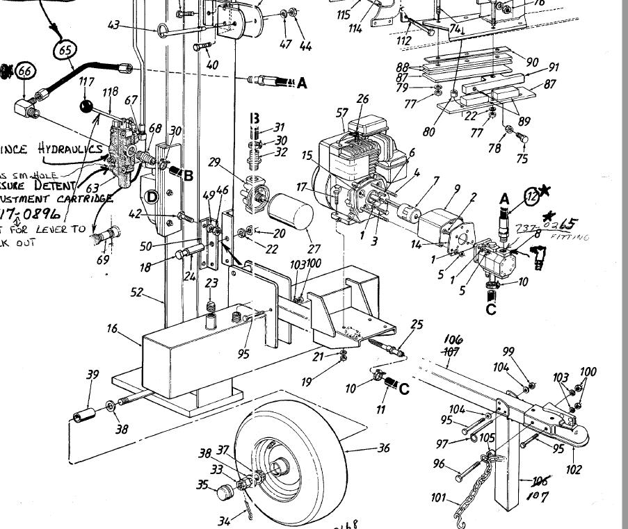

This is the part diagram of mine. Filter is #53. You can see it located at the tank before feeding the pump. To me, this is the best place for a filter (well, outside of the tank would be better so it's easier to change). It's low pressure and any impurity in the tank is filtered through before reaching the pump. The hydraulic diagram above makes no sense to me. Why would you filter the fluid AFTER it went into the pump?

You can call it a filter and parts list may call it a filter, but by design and placement its a strainer...
And having a filter after control valve and before tank its on 'low pressure" side (easier to prevents canister bursts) and it is readily accessed to change ... Not like having to deal with all the fluids in tank when trying to clean strainer between tank and pump....
Edited to note: his is incorrect graphic for my splitter, graphics is for DUERR 622/623.... My splitter is a DUERR 620...
Dale
/ Log Splitter Question... #12

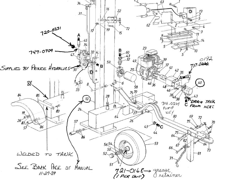

Ok, looking at your diagram, #58 is your filter connected to hose 'B' and hose 'C' is the input hose to the tank ('A' being to output hose to the valve). There is no 'strainer' between tank and pump. Again, to me, this makes no sense. Why would you let possibly dirty oil enter the pump (dirt could come from oil being poured in, through the breather cap or simply rust particles pealing from inside the tank) and then filter it? The damage is already done.
From my understanding, hose 'C' is also low pressure, only hose 'A' and the hoses going to each cylinder ends are high pressure so strainer/filter attached to the tank before the pump is on low pressure, not high.
My manual mentions replacing the filter when changing oil, so dealing with replacing the filter with a full tank is a non issue. Beside, why would you clean it between oil change? If it's clogged, that means those particles already went through your pump because there is nothing preventing them from reaching it.

OK.... I see you comment and it made me look at graphic again...... BUT graphic I posted above was in error, it was for DUERR Model 622/623....
Corrected image (below ) is for a DUERR Model 620 which is actually what I have... Please note strainer at tank outlet (#25) and a 10 Micron filter (#27) where fluid return to tank....Obviously the engineers who designed you splitter, and the engineers who designed my splitter went to different engineering/hydraulics schools....
Sorry if the misinformation in previous post confused anyone....

/ Log Splitter Question... #14
Actually, different engineers designed the DUERR splitters since some models don't even have a strainer :D I'm wondering if some beans counter dropped the strainer from some models to reduce the cost because I doubt a engineers would design one without any protection before entering the pump!
Edit: It's interesting that in the theory of operation of your splitter (page 15), they don't mention the return oil filter and call the strainer a filter. Talk about wanting to confuse people lol.
