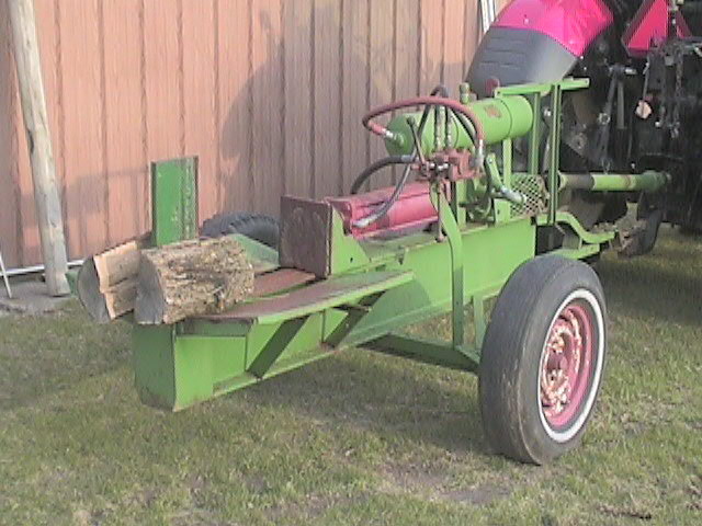

I have a the 3PH splitter from TSC. Works just fine.
One of the reasons I bought it was because the splitting is done standing up as opposed to bending over a trailer mounted splitter like the Troy built I was looking at buying.
My 48 HP tractor engine is burning around 1/2 GPH when splitting wood. It burns 1 GPH when running PTO RPMS. I have a 17 HP Kawasaki engine on the DR that burns about 1 GPH. I figured the engine mounted splitter would burn 1GPH as well thus the tractor burns less or maybe the same GPH. Its one less engine to maintain if the splitter is for the 3PH.
The tractor has 730ish hours and its seven years old. 400ish hours where in the first two years. IF I put 100 hours on the tractor per year now a days and IF the engine needs a rebuild at 3,000 hours, that is 20+ years from now. I bought the tractor to use it not have it sit. It looks like it takes 6 hours or so to split a cord, 4x4x8. I use 4-5 cords per seaon so I might put 30 hours on the engine splitting wood.
I stage my work with the tractor anyway and splitting wood is no exception. I bring the logs to where they are cut, split and then stacked. The logs are put in a big pile that sits on ceder trees to keep the wood off the ground. Behind the pile have put down 12-15 pallets. The logs are cut into rounds which are stacked on the pallets. When it is splitting time the splitter is hooked up and I split the wood from the pallets and then place the firewood on more pallets. :D This way I don't have to switch out attachments. Its just takes a bit of planning ahead.
