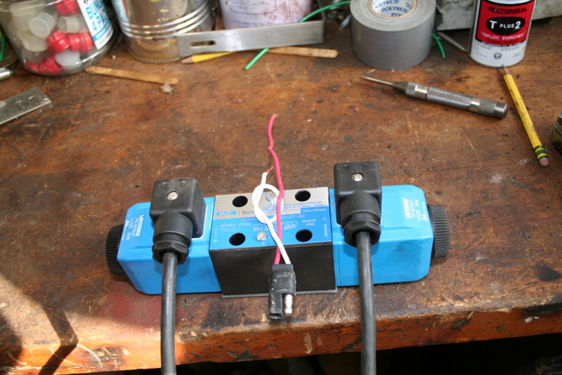

I am going to use the tractor hydraulic system to flush the new hoses. The return line to the tank runs through a filter so it catches everything before the transmission/tank. I took the winch motor out of the circuit ( it is new), tied the two motor lines together with a connector fitting and will use a flush cover block on the valve manifold . This is an electric solenoid valve that mounts on a manifold block. Just take the valve off and put the cover on in it's place. Then just run the system with the remote valve on the tractor. Fluid runs right through everything and back through the return filter to the tank. About 30 seconds ought to do it.

Flush block cover came . Flushed the system and put the Vickers valve on. Hooked up the winch motor. Closed down the needle valve. Had it wide open for flushing. Maybe 20% open. Temporarily wired up the electricals till I am sure it works. Magic Wireless . first button spool in, second button spool out. A lot of speed control with the needle valve. The two speed gearing on the winch is obvious. Of course I ripped off the dipole antenna 30 seconds after I was in the woods. I think I will stay with the monopole and raise it up. It has some give so it should not get broken off. I spoke with a friend of mine who knows all this stuff and he said an antenna on the transmitter would help a lot. But it looks like a garage door opener and it would be kind of difficult to stick an antenna on it. Next is to winch something maybe a log.
