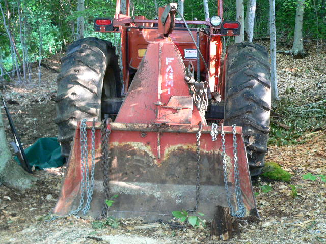

I also have a small Farmi. I like the fact that it pulls from the top. It really helps when the tractor is backed to a rut or ditch or on a bank to have that upward pull when the log gets in close.
You will not pull the tractor over if you have the upper link adjusted so that the force is directed at the rear axel or below ( which means use the lowest
hole on the tractor end of the upper link).
The Farmi unit will definately not dissapoint you.
