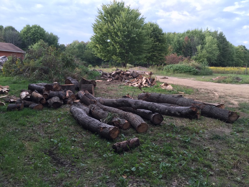

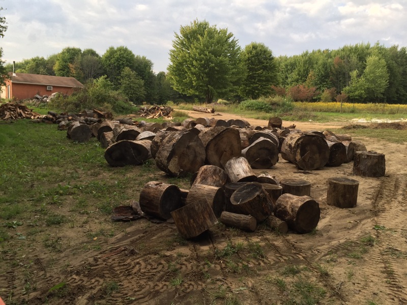

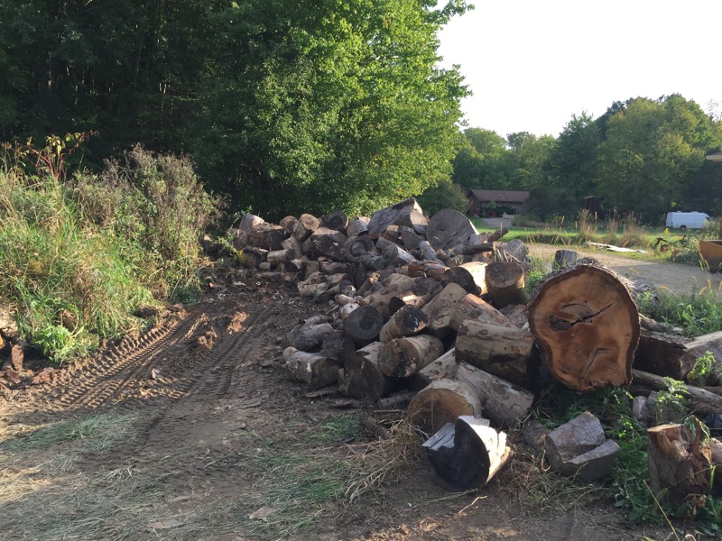

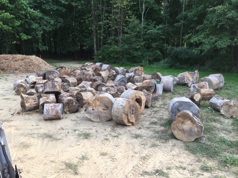

Spent most of the day tearing into the huge pile of rounds:
... and pulling out the bigger stuff and staging it for splitting tomorrow. The two rows on the right are ash, the stuff behind it is sycamore ... there's a few rounds of sycamore that are around 48" in diameter or better. And there's small pile of pine behind the sycamore that isn't visible:
The pine (in the foreground):
Red oak (in the foreground), some of which needs bucked ... and way in the back behind the pile of splits is another pile of smaller ash rounds:

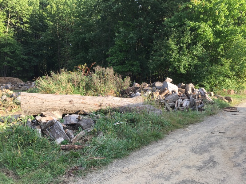

A red oak log ... probably 12' long and 24" diameter. Need it cut in order to move it.
Another red oak log that's still on the pile ... this one is even longer and larger in diameter than the previous one:
