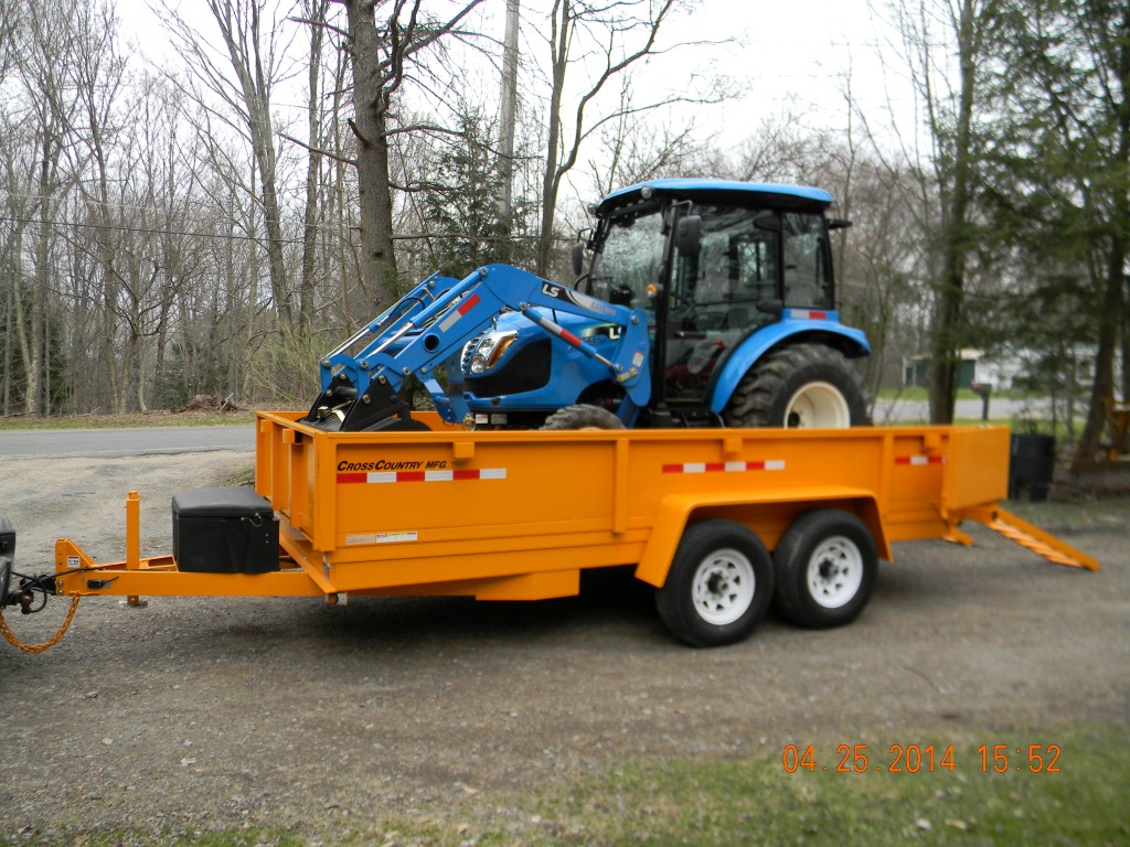

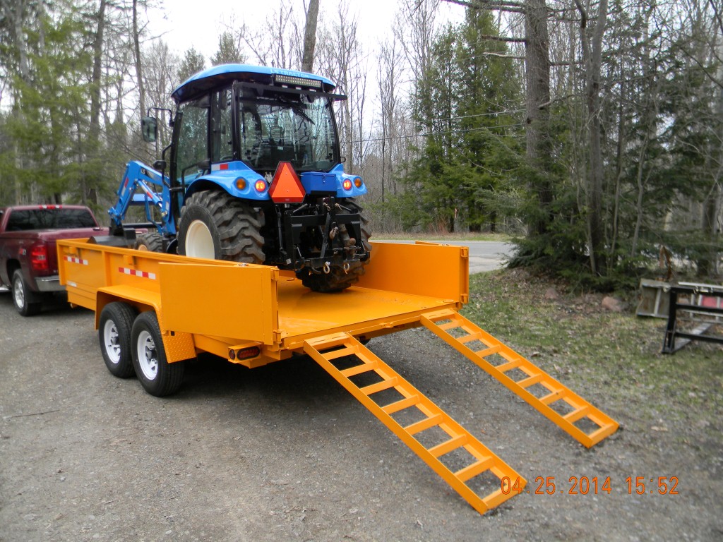

I have a 14K BP 16' dump trailer made by Cross Country Trailer here in NY. I have used it once to haul my tractor but usually use my tilt bed PJ for hauling vehicles. It has ramps and D-ring tie downs in the bed which is 80" wide.
You are correct that dump trailers are usually 10,12, or 14' in length. Longer ones are usually special ordered. Mine was special ordered by someone else who later backed out of the sale order. I saw an ad online by Cross Country and was able to make a deal.
For me its much easier to use the dump trailer to haul materials and the 22' PJ for vehicles. Tieing down without sides and loadin / unloading is easier too.
Here's mine.

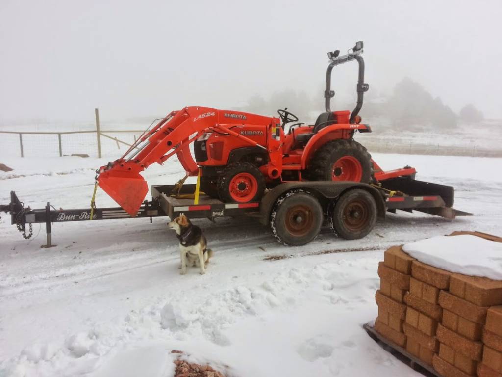

My old 16' tilting deck trailer barely h
Fit my 3,000lbs L3200 & that was only because it had a really long tongue to rest the loader on. Any impliments would usually hang off the back s bit.
Even if you can fit the tractor on the deck or in the box, it's a crap shoot if it balances properly when there is no slack space to adjust it.
I thought about a dump trailer as well for similar reasons. But due to the conflicting objectives ended up with a deckover power tilting deck.IMG_20140209_110007.jpeg

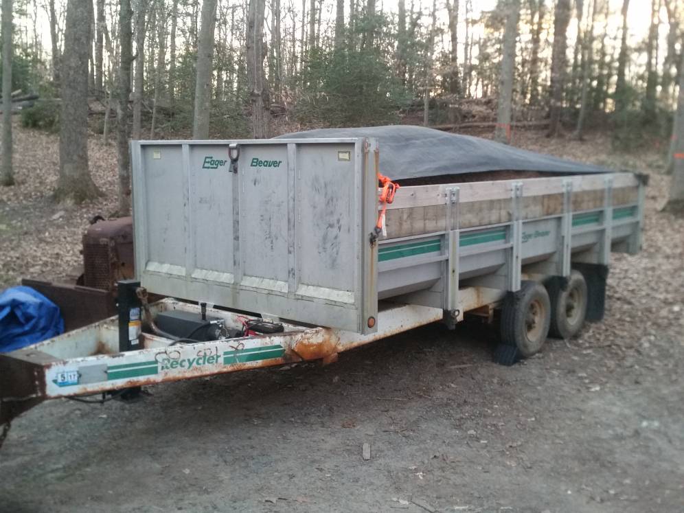

My 16ft deckover dump is lighter, but that's due to having an aluminum body.20170223_175217.jpeg
