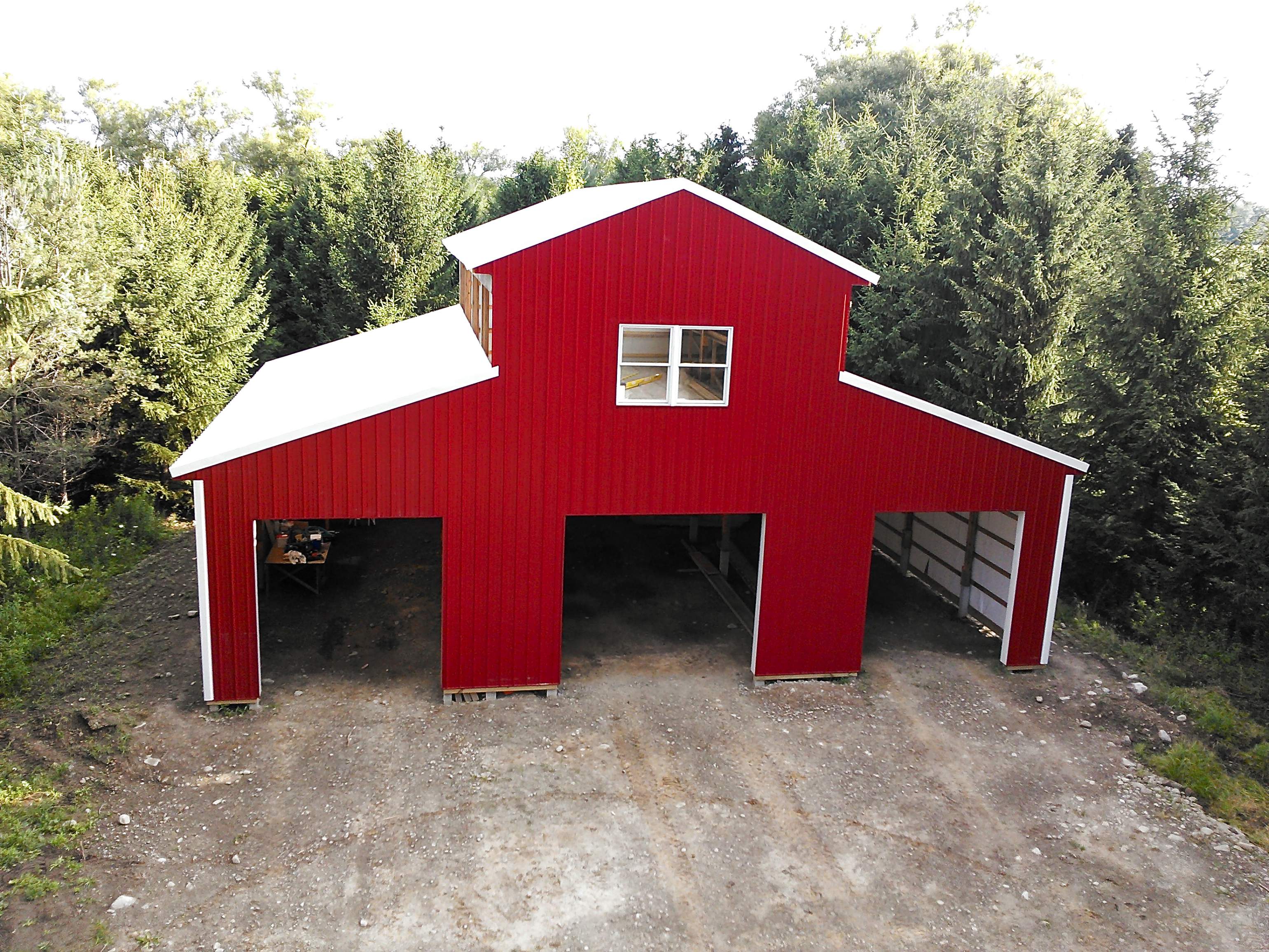

Looks great, Lee.....I'm envious...!
   / Long road to home. #244
Just love the barn Lee.
It's great when a plan comes to fruition!
Great Job!
What do figure your material cost per square foot when it is all done?

Thanks everyone, although there's plenty left to do it is nice seeing it so far along.
Great Job!
The total square footage is 2800 counting the second floor. I have around 30k into the building, that doesn't include site work. So, if you do the math, the per square foot cost is just under $11/sq.ft. That almost makes it sound cheap.

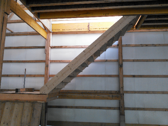

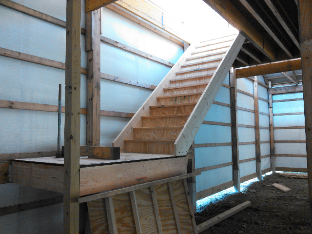

Came out for an overnight trip. I got the upper stairs in place, will frame up and pour a pad to set the lower set on tomorrow. Hope to ste them next week.
