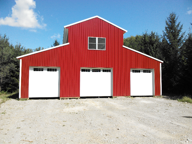

I finished up the barn doors today. Well, finished except for the fake handles and hinges on the outside.
The boxes around the door panels all said "installs in less then 30 minutes". Let me tell ya, it takes a bit longer then that. The first one took 3 hours. Mostly because I didn't bother with the directions. I have installed dozens of this manufacturer's doors in the past so I figured I would just jump right in and skip the paperwork. All went well getting the panels up, until..... I got all four of the non glass panels in place and wall track up then realized there's small numbers stamped into the caster brackets, 1-4. Guess what, I put the panels up in the wrong order, number one was ok (has the bottom weather stripping so it was obvious), the other three weren't. So I disassembled the door, reassembled in the correct order and put up the top tracks. Then in went the top panel, attached hinges. Everything was going smoothly again, time for the torsion spring. The 10' wide doors had one spring each and the winding hub was painted red. I couldn't remember if that meant left or right hand wound. Had to check the directions, red means right hand wound, cool got it. Get the spring assembly mounted, started winding it according to the chart, nine turns. Door only goes up half way, uh-oh. So I stare at it, scratch my head, swear at it, check the paint color again, still red. Back to the directions. A right hand wound spring gets installed on the LEFT side of the center bracket, crap, more swearing. Unassembled the spring assembly then reassembled correctly. Wound the spring, opened door 3/4 of the way and realized the cables got twisted when I reassembled. So, more swearing, more unassembling and reassembling. Finally got it after the three hour mark. That was enough for yesterday.
Today I put in the other two doors, correctly the first time, and then took the tractor out and disced the food plots.
That's what I get for not reading the directions.

Hey, your average time per door wasn't bad at all, that's what counts. :D
Looks good!
   / Long road to home. #276
The doors were a good choice, they look great on your barn.
