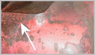

since you are really keen on wanting a jube.. lets go a step further and make sure it is one. that 50$ badge can be swapped easy.
look on the trans bellhousing aft of the starter.. there is an angled boss there that will start with NAA and then a serial number.
early naa were made in the end of 52, then in 53 they caleld them jubilee for the aniversery edition, then in 54 it was back to just being an NAA. both the 52 naa and 54 naa are technically more rare than the 53 naa dubbed jubilee. I've seen hundreds of naa sold as jubes.. that were simply naa.. etc.
post the sn.
if no sn on the trans bellhousing, look on the block, front, under the head, near manifold. very early models had a sn there. occasionally you get a unit that had an early engine, thus sn on engine, and it had a late engine repalcement.. and thus end up with NO sn.. or vs a vs.. and have an engine and trans sn.. etc.

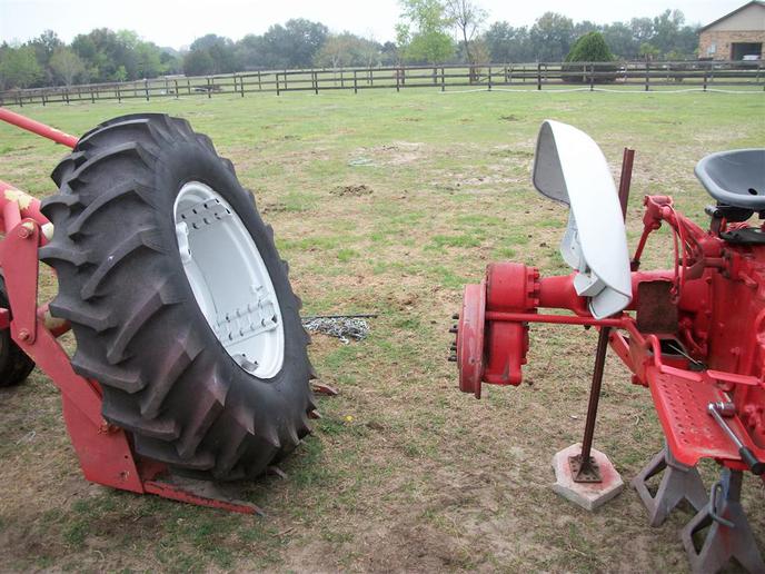

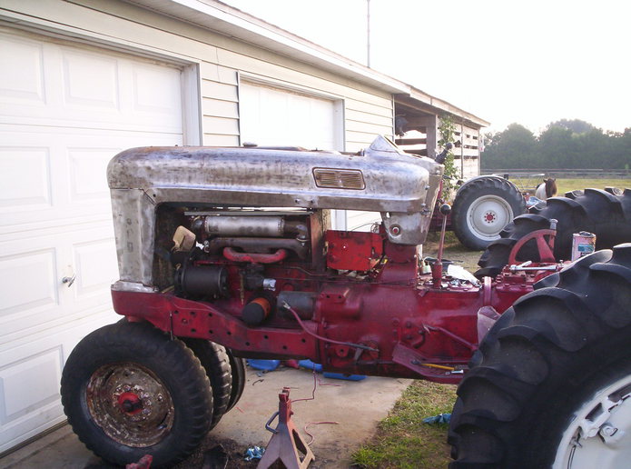

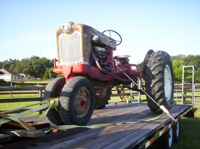

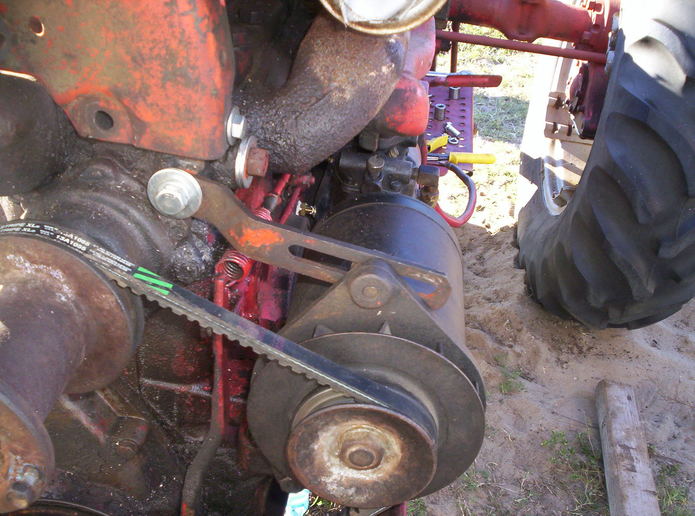

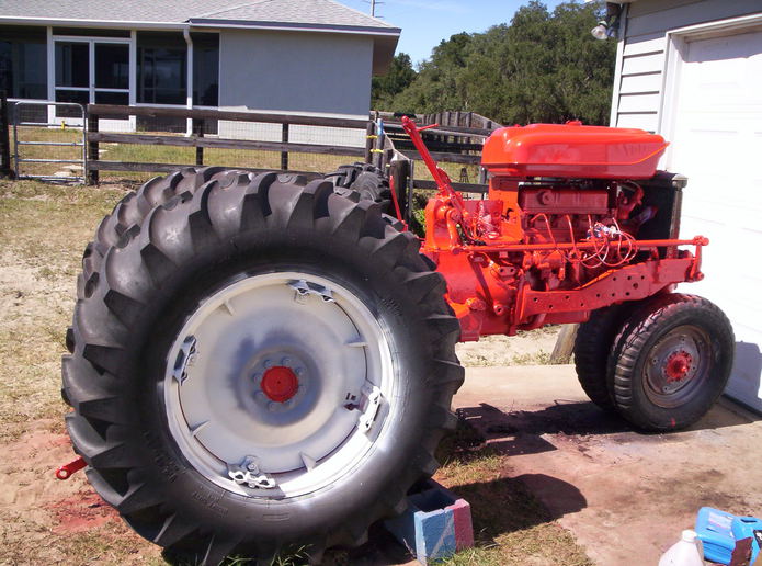

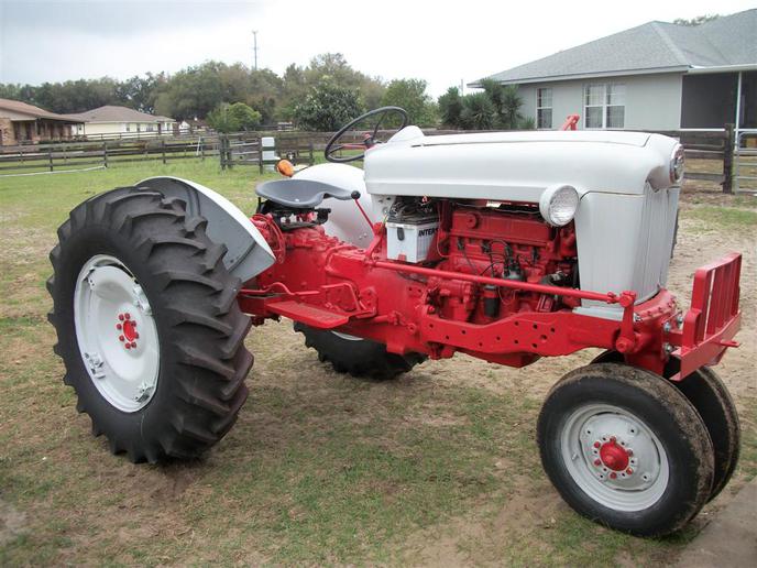

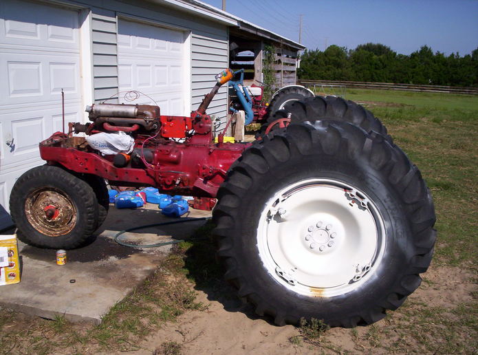

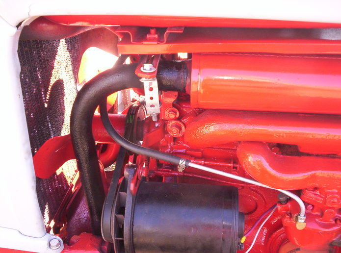

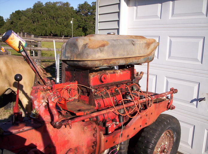

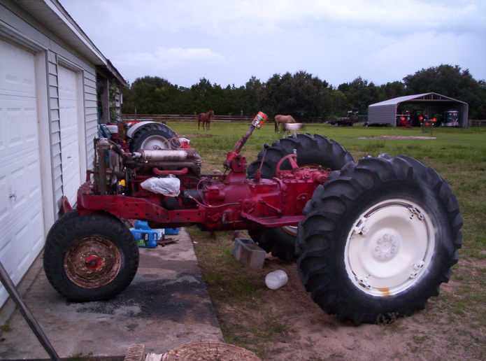

I grug home a naa that was down on tires and had a tree across it.. bad hyds and charge system.. took me an entire summer to rehab, and I paid more to rehab it than it cost to buy.. by a long shot.
same deal on a 950 rowcrop I drug home from a muck pond. had to go down to bare chassie on that thing, replaced half the parts on it that were wore slap out. easilly quadrupled my investment into it making it look and run good.
On the other hand I've bought better models that only needed a month of work and 500-600$ to make them look as good as units that took me entire summers or winters.. and 2000$ in parts and materials.

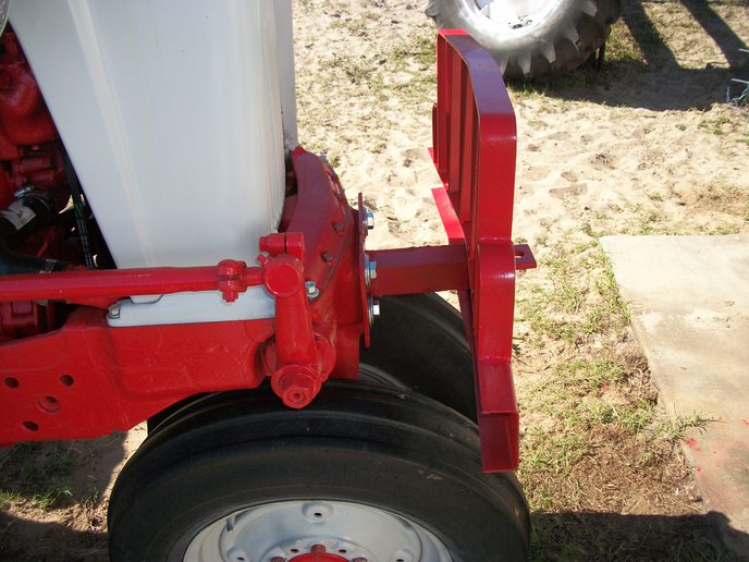

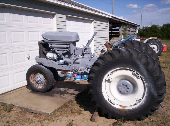

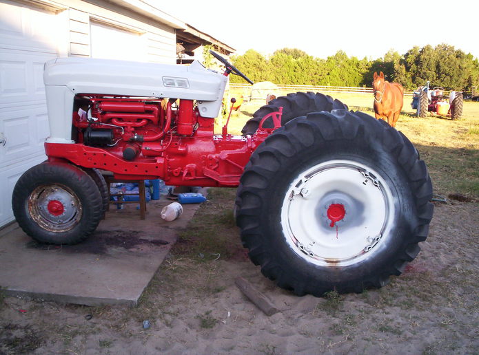

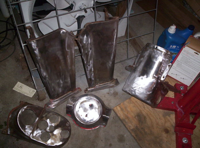

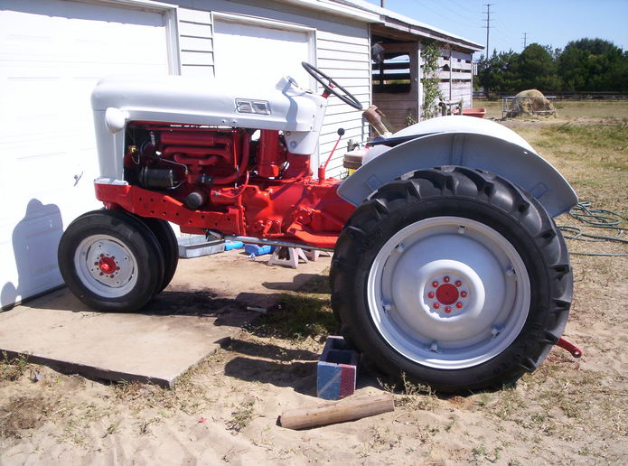

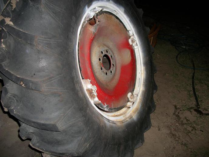

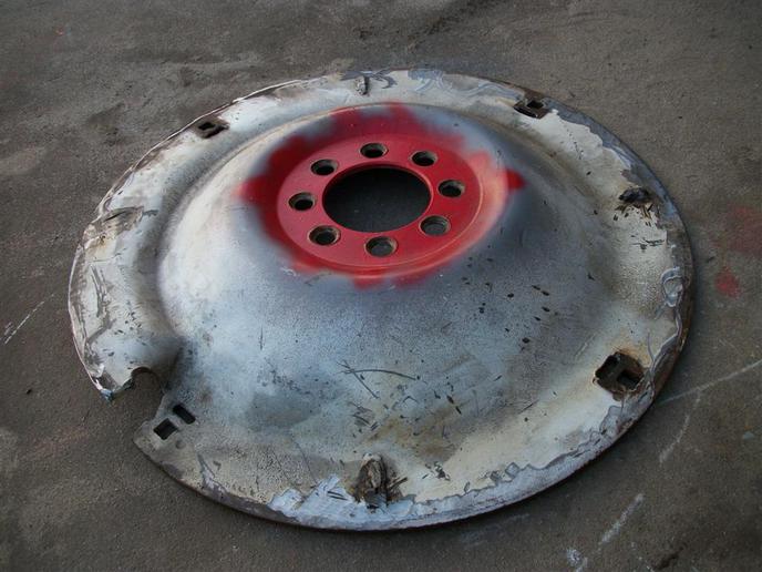

That 950 cost me plenty in sheet metal alone.. starter, genny, pto shaft.. had to repair 3pt and open diffy for lift arm pins.. 85% of the bolts and studs were broke off in it.. had to drill out / retap many.. had to buy all salvage brackets for the engine and fuel tank and battery box.. had to rebuild steering.. and parts for the front pedistal are hard to come by.. tires and rims were shot.. took me a full extra winter making the rear power adjust rims presentable.. .. everything on the tractor was pretty much shot, except the transmission. I would have been better off to have salvaged the trans, and parted the rest out.. would have actually made money on it that way..
that's the issue you can get into on one of these things. buy a 500$ tractor and put 2500$ or parts into it, and that's if the engine and trans don't need work. plus months of your time.. easy to turn into a 4000$ project fast!
Here's a video journal of my dealings with that 950. stretched out over a year to finish. tin that came on the tractor was unuseable.. it don't show.. but unit was originally on propane and they torched out the entire top of the sheet metal ruining it. and then only halfway did a working conversion to gas. i had to scrap all that and totally repalce the fuel system, including the vw fuel tank they used hose to tie into place... that job took me from a cheap, but runs, tractor, to a whole long ride of repairs and salvaged repalcement parts.
still.. it was fun.. :)

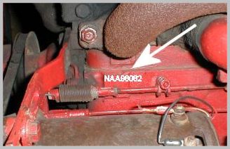

Sound, isn't this the number you were asking about to make sure it's a jube?
It reads NAA 70068
According to the web, that should be a true Jubilee.
It reads NAA 70068
Thanks,
Painer
NOOOO! I already mentioned back on page 1, post #7 that was a RAISED CASTING NUMBER.. not a sn...
you need to look for a HAND STAMPED NUMBER on the trans bellhousing!, or possibly the block, if an early unit.
here are pics of the early and late sn locations
