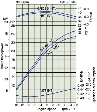

I've never run mine higher than 2800 RPM and the noise is tolerable. Book says max horsepower is 2600rpm.
Maximum horsepower on the BX2360's D902 engine is at 3600RPM.
