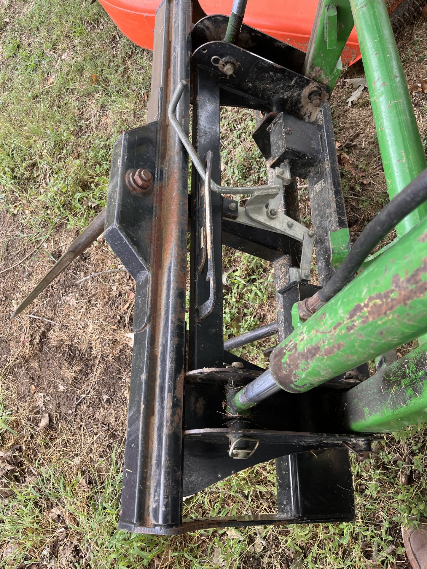

This is the kind of attach I have on the FEL, don't know what it's called....anybody know?
I don't know, but with that not being painted entirely John Deere green, that makes me suspect it may not be JD quick attach?
You might measure to see what you actually have.
I don't know where the JD dimensions are, but I think the SSQA dimensions are here: Skidsteer quick attach standards SAE J2513 | Farm Hack
