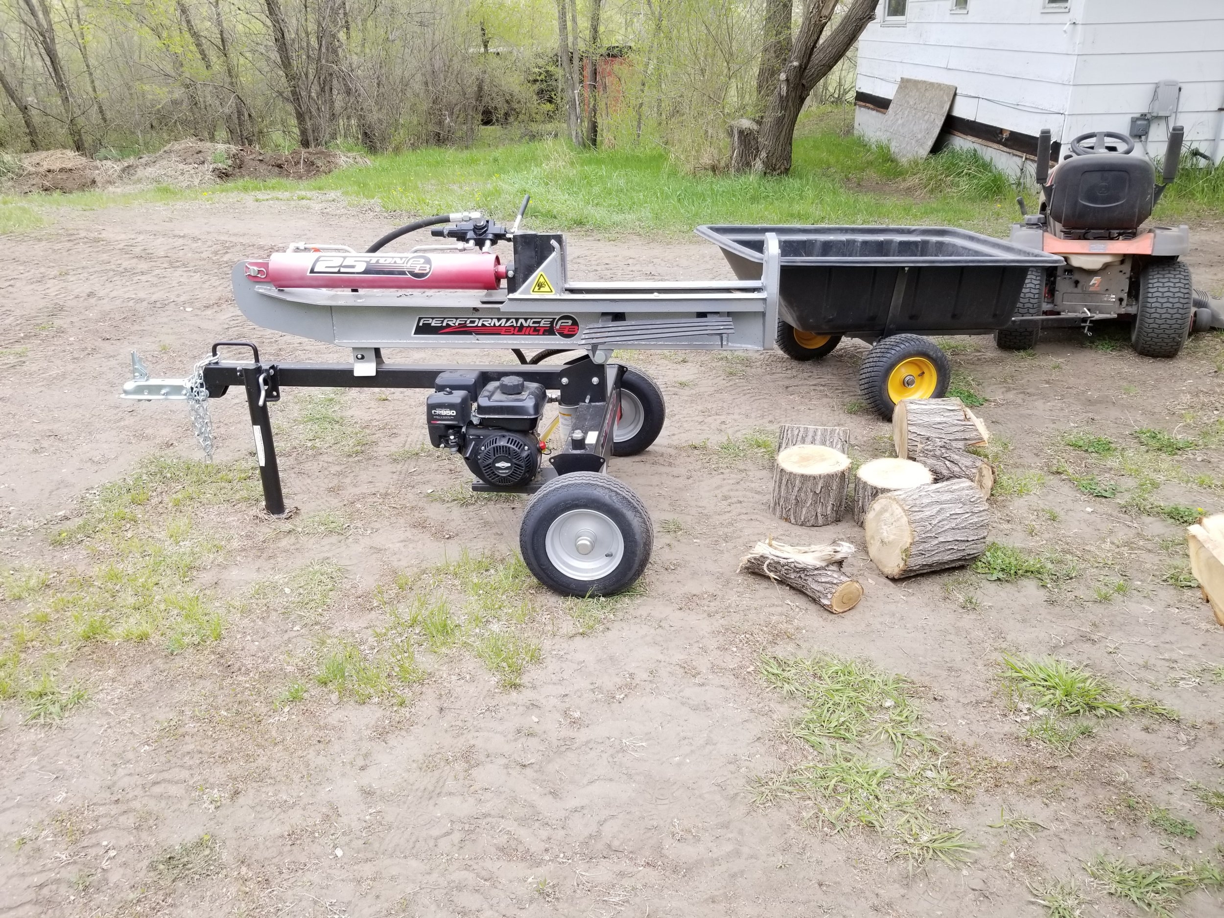

I've had a decent "homeowner" grade splitter for about 5 years now. I think it's got a Briggs engine on it, rated for 25 tons, and it does well enough for me. It can be used vertically, but I've never done it. It's got a small "table" on it, but it works. Most of our wood is soft wood, and I've split a ton of box elder (horrible stuff-wet, stringy, but burns hot when dried) on it. I don't heat the house with wood, but just augment our heat (we have a wood stove, but also electric furnace). The boss lady likes to sit out back at our fire pit when the evenings are nice. So our wood use is pretty minimal. Less than a cord a year, really.
I haven't even started it up this year, but probably start putting wood up again next summer.
Nothing special, but it's been reliable.
