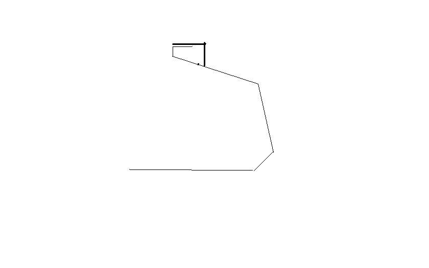

You should think about adding a vertical component to the back of the existing lip so that it forms a box and then welding it where the (shortened) leg touches the back of the bucket as well as where the other leg contacts the lip. I tried to attach a sketch.
If you make the angle iron longer than the grapple mount, you could weld some chain hooks on there while you're at it.

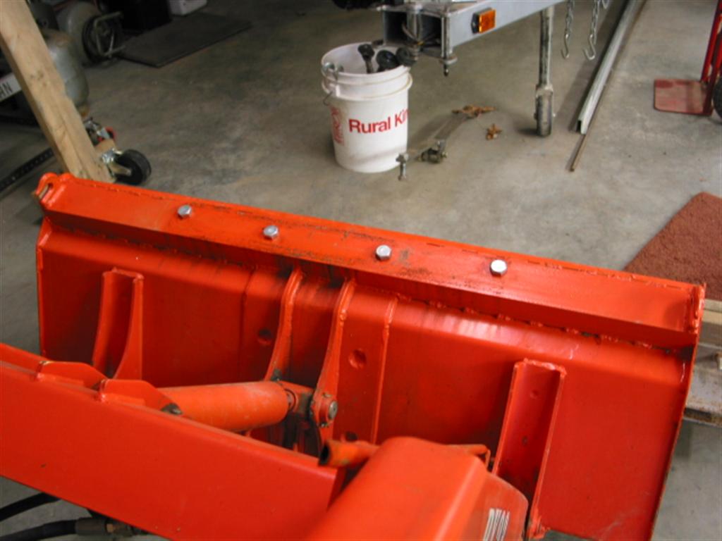

Trust,
This is how I reinforced the top of my bucket. 2x3x1/4 angle iron. Nuts are welded in place. I keep bolts installed when the graple is not installed to keep crap out of the holes. The offer I made before still stands.

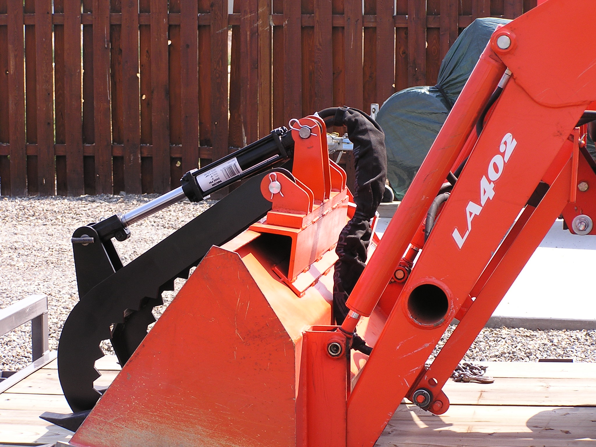

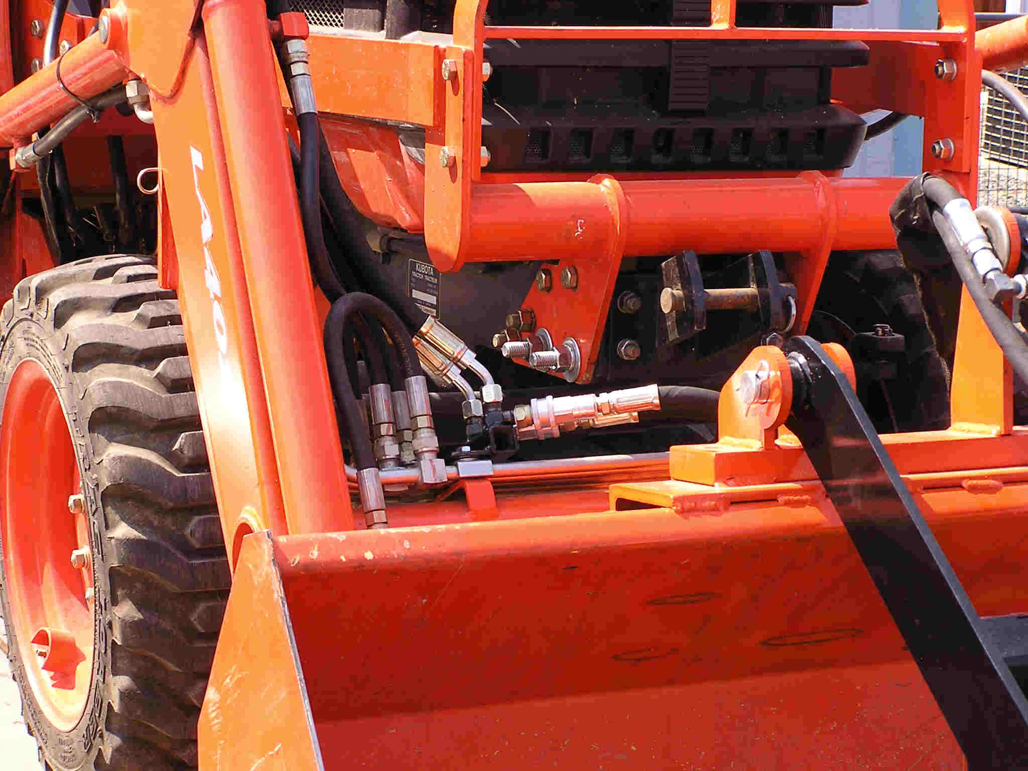

I stalled a Tatro Grapple on omy B7800 FEL and yours appears to be similar. I have included a couple of pictures of my installation which might be of help.

Well done, Richard.
John
