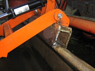

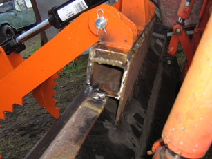

Well here are some bad welds, I bought a mig welder a couple of weeks ago and am learning (I hope) I'll need to grind a little more and then heavy paint so the guys don't laugh at me.
Anyway, I got a Tatro grapple and it was too large for my bucket (B21 Kubota) I knew it ahead of time. I made a spacer out of 3 x 3 sq tube and then used two 1/4" plates to reinforce it. I tried angle first in the back but the material was 90 deg and the bucket was something else. I like this so far it seems strong.
Now on to the hydraulics...I have no clue. I will be asking questions in the Hydraulics forum

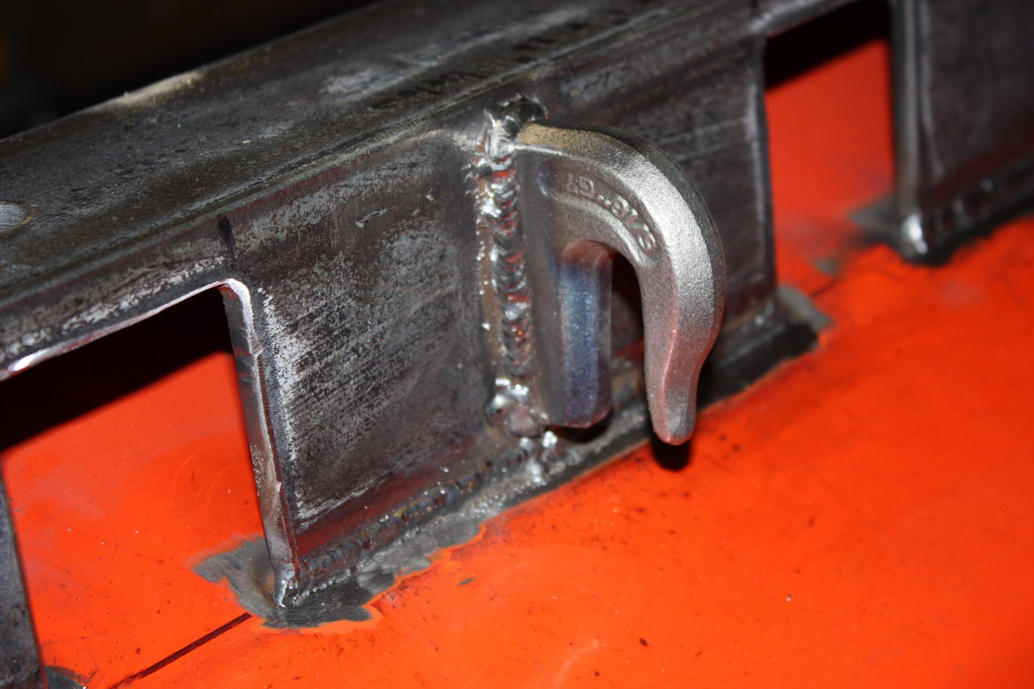

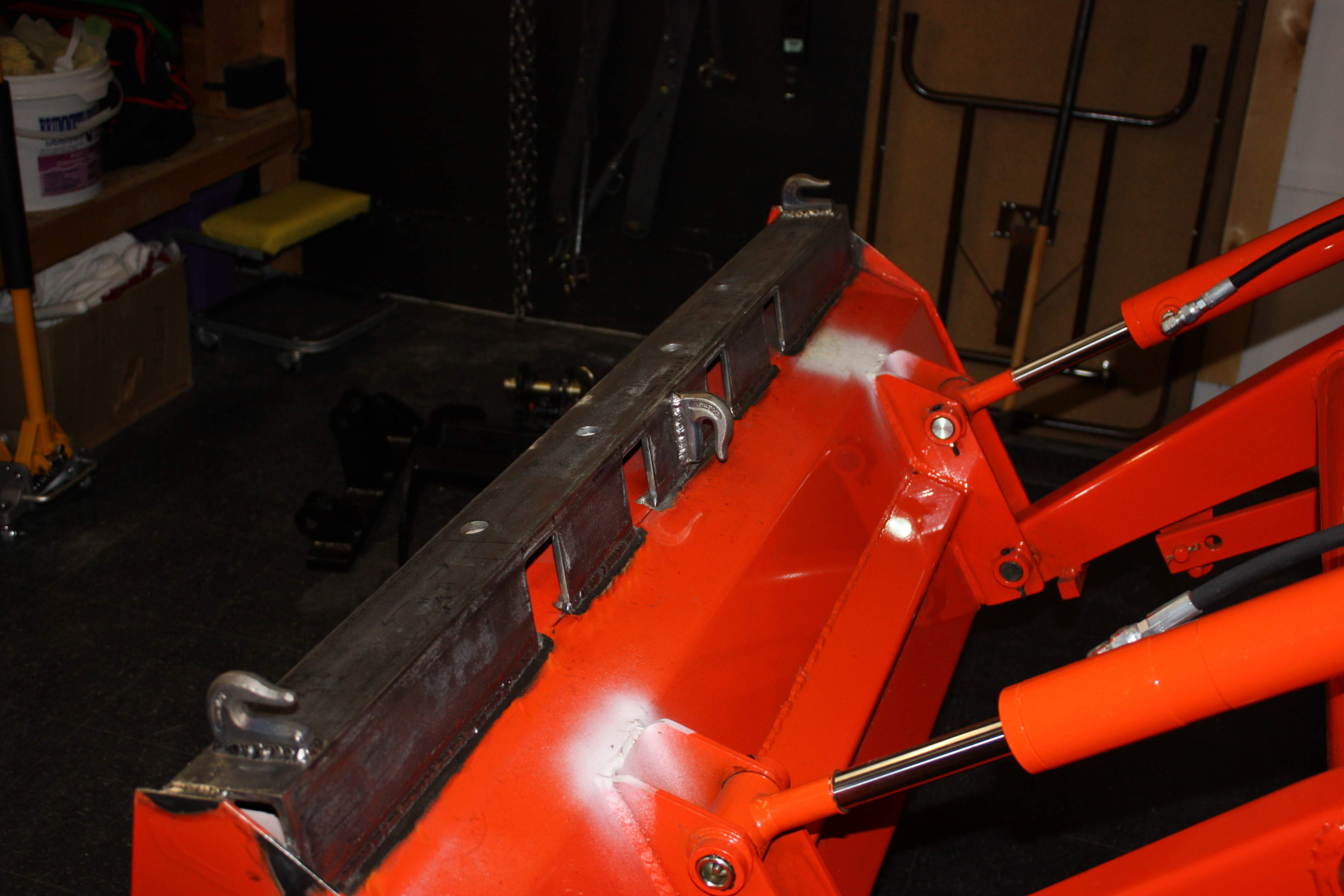

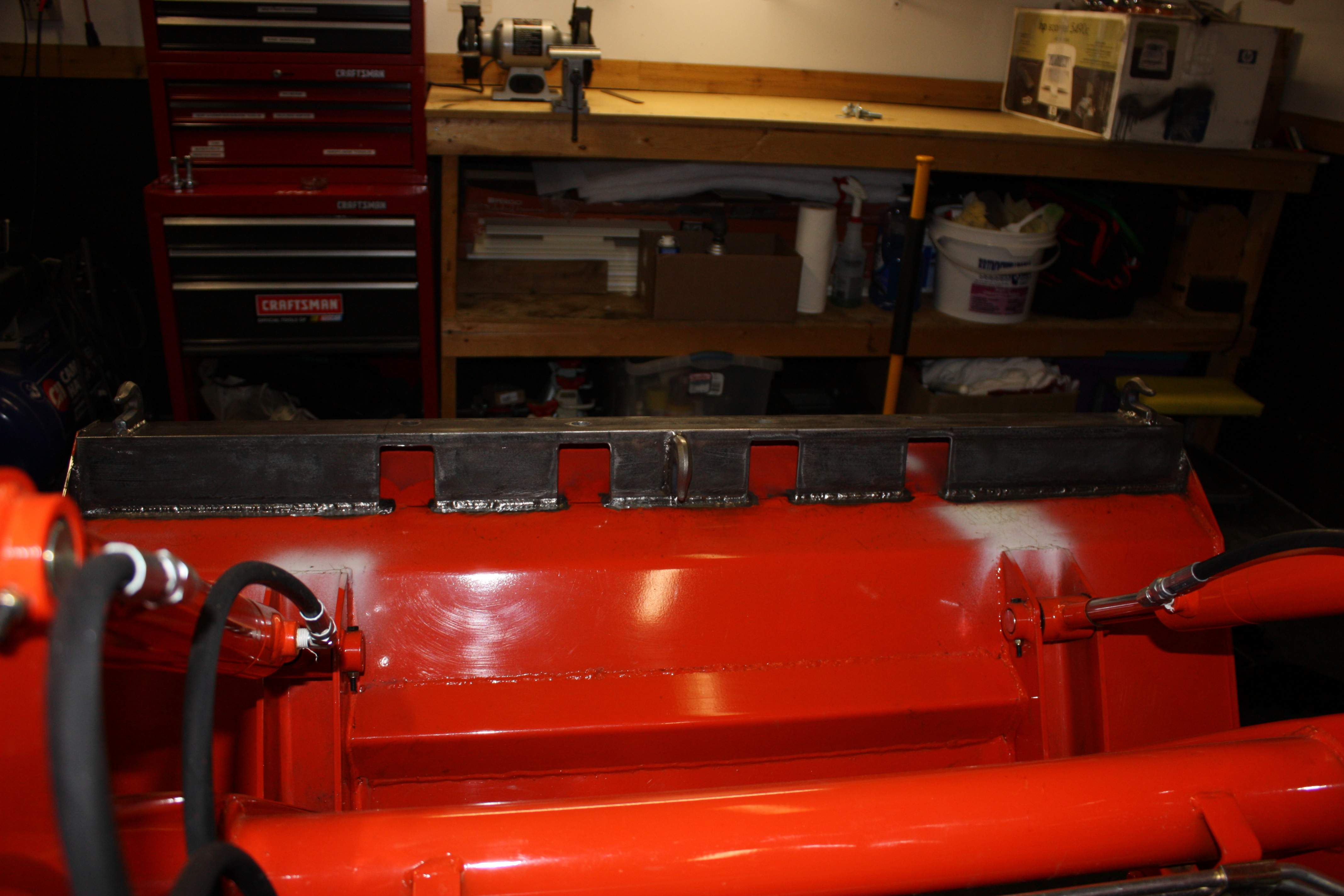

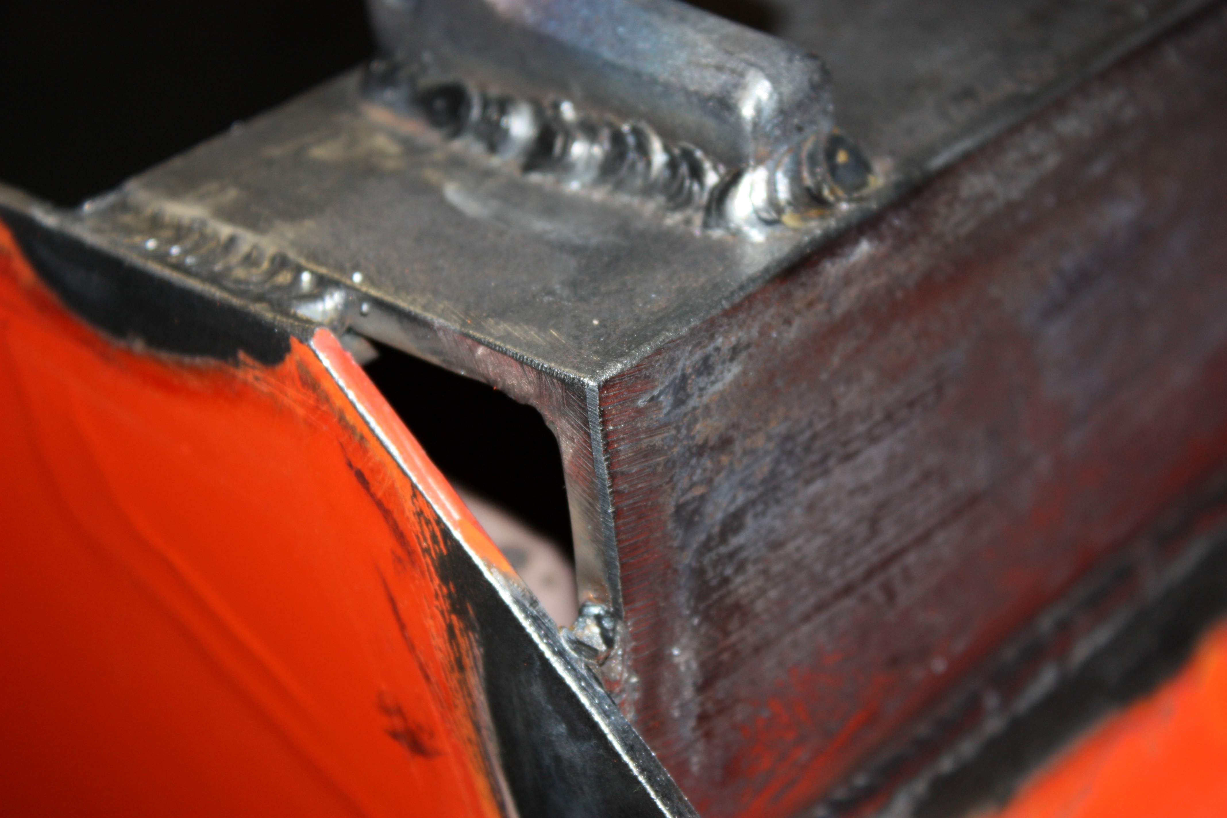

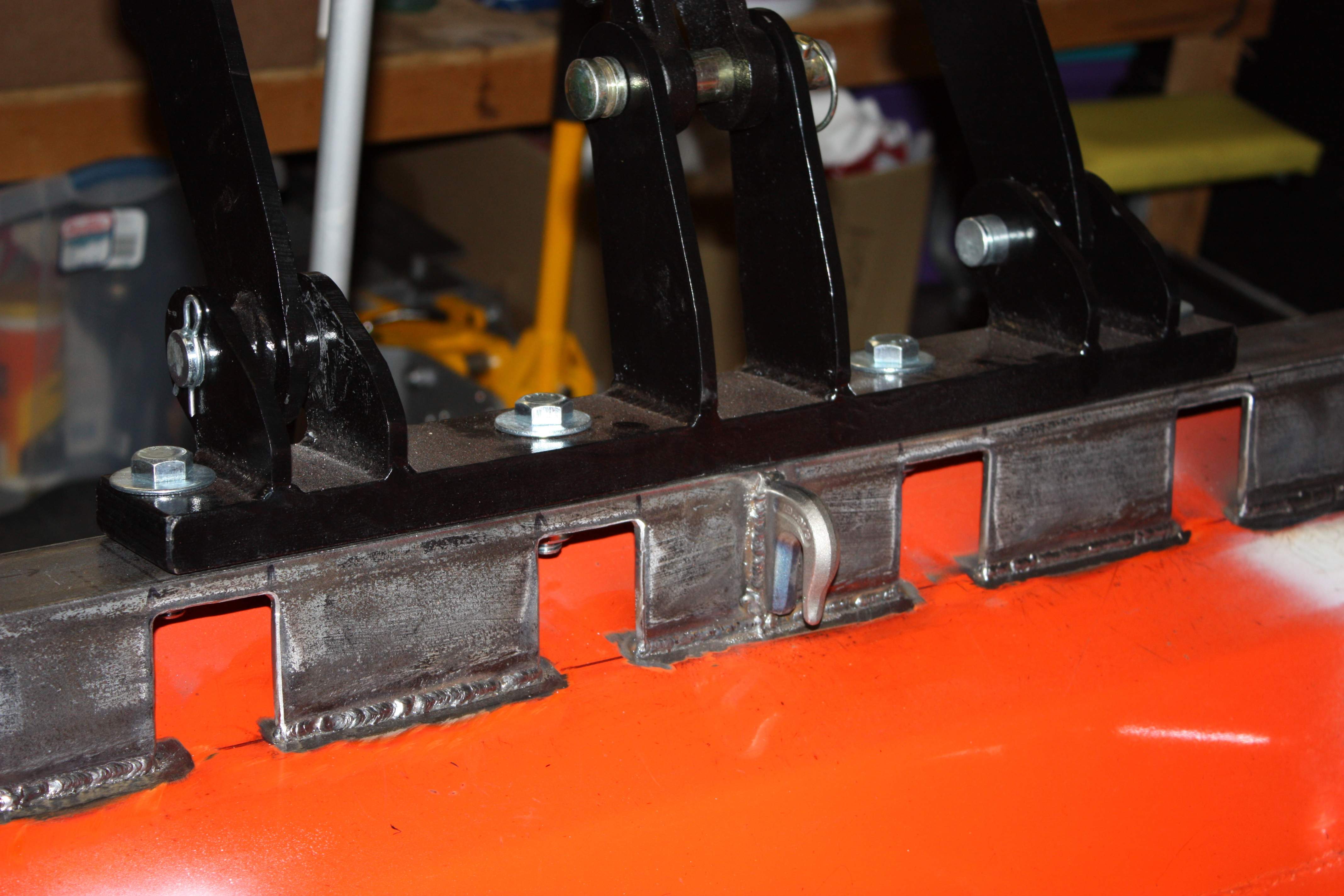

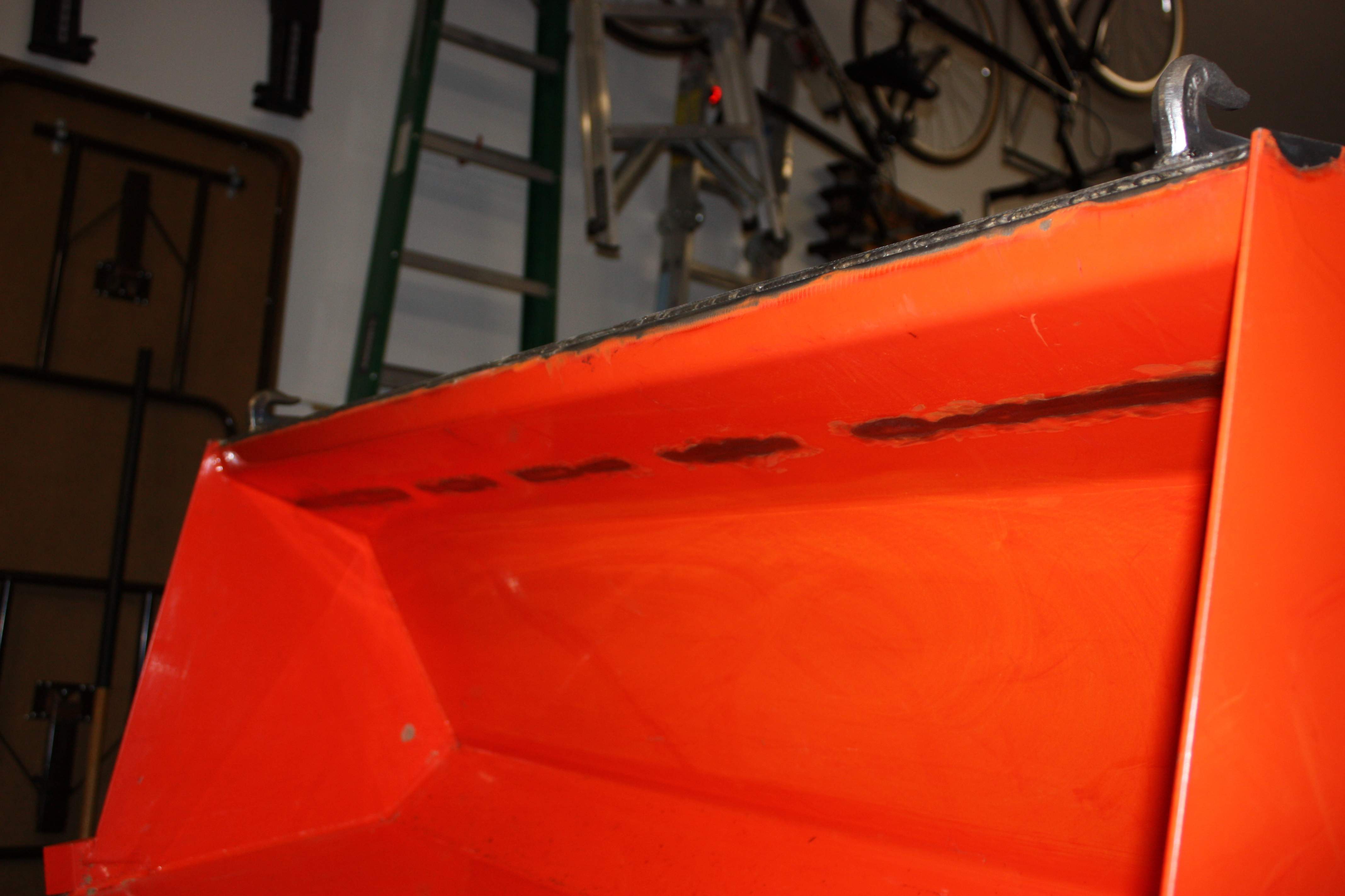

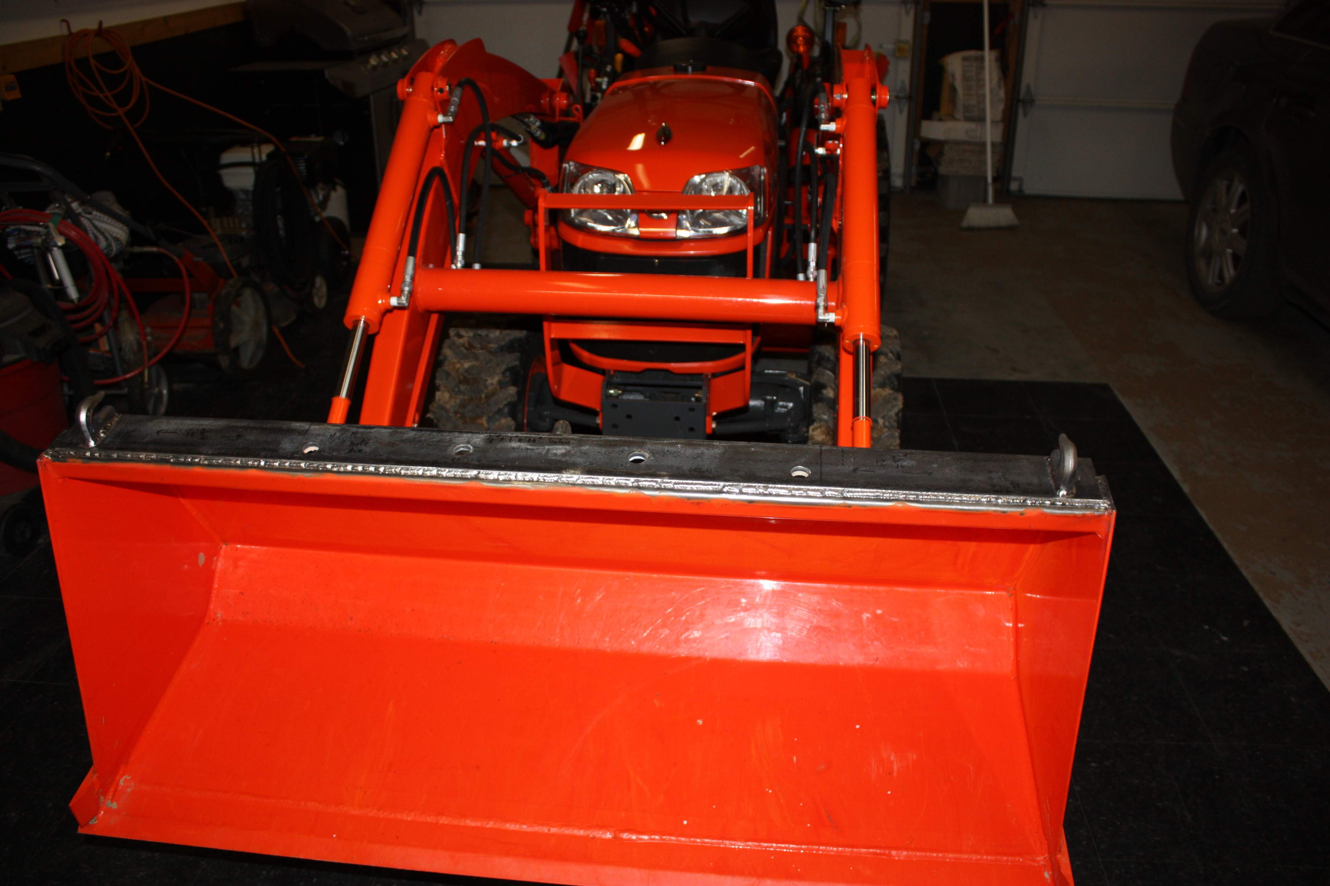

Here is the "almost" finished product, I will paint it up to match. I will need to have the hydraulic hoses made also. In all I'm pleased with the outcome. The tow hook on the center back side is like that because with the grapple installed a top mount is not possible. However when the grapple is on, a chain or strap will still pass under the piston, so I can still use it.

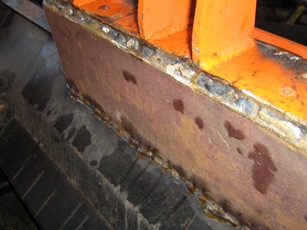

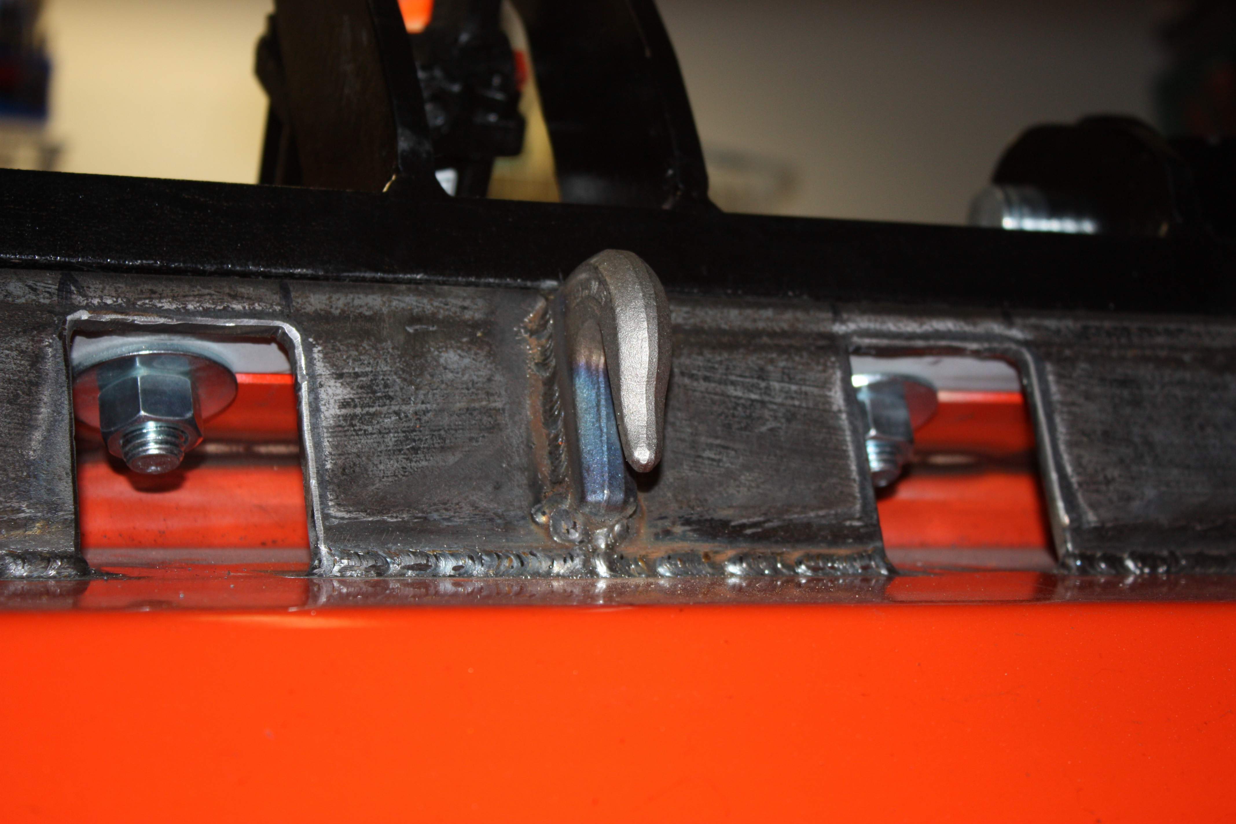

Here's more.
