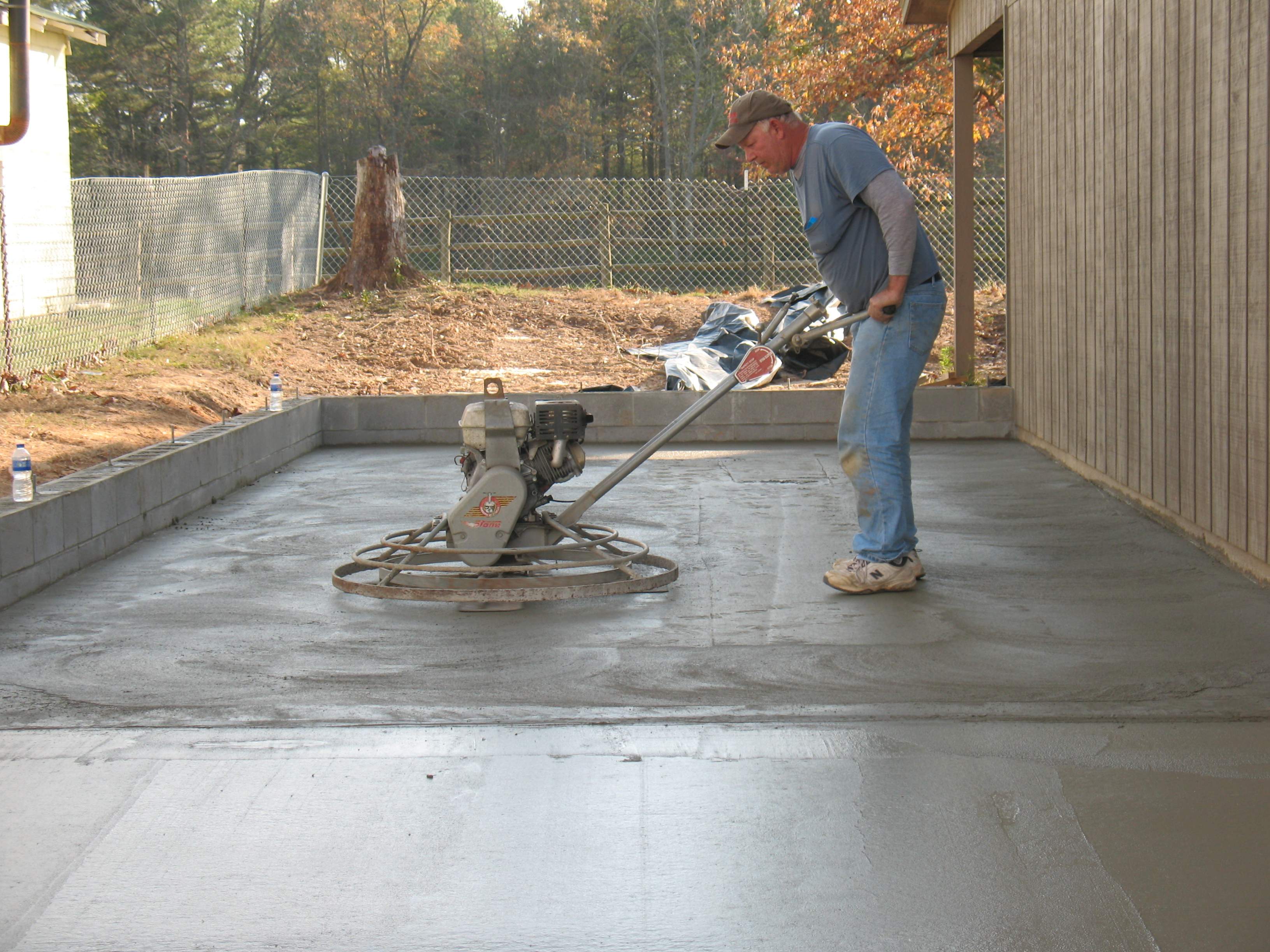

I just yesterday poured a 14 wide by 48 long slab for addition on my shop. 14 x30 had power trowelled finish and 14x18 broomed finish. It took from 9am to 6pm to finish up the power trowelling due to the cool temps, the concrete took a long time to set up. I had a professional crew do it also.

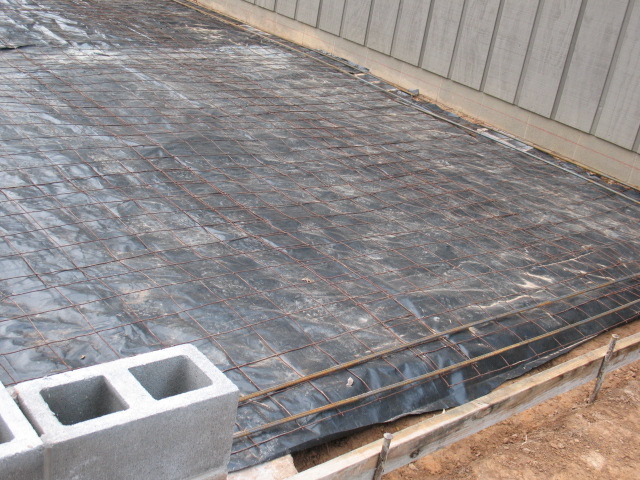

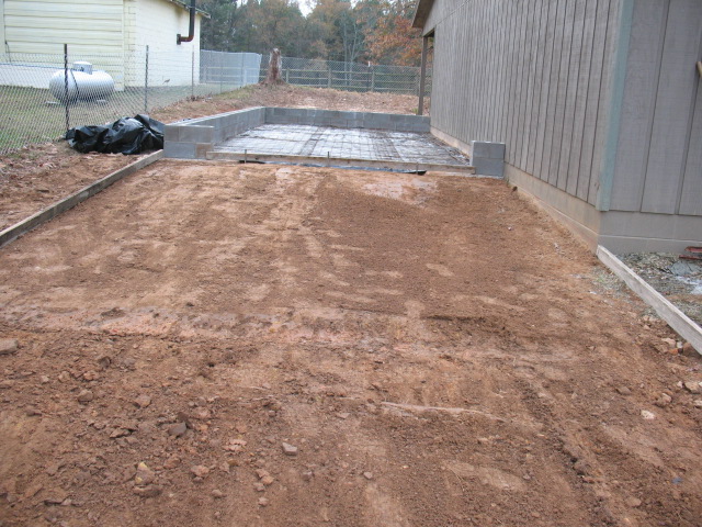

Attached some photos of yesterdays pour. As you can see, we had the grade beams already installed and 2 courses of CMU blocks on the perimeter.. The concrete blocks are to prevent water from coming in since it is built into a slope plus it allows me to hose down the inside without getting water on my walls.

The first thing we did was fill the CMU blocks with concrete, tamp it in and strike it off level then insert the anchor bolts for the wall plate then we poured the 14 x 30 slab and finished it off while waiting for the second truck to bring in the final 4 yards for the apron slab. Since everything is on a hill, the contractor elected to not use a 10 yard truck and split the load up to reduce the possibility of tip over and also deeply rutting up my yard.
