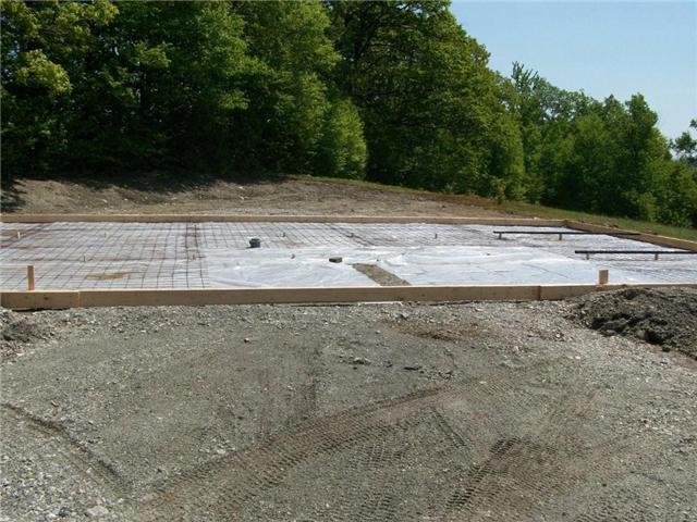

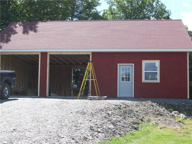

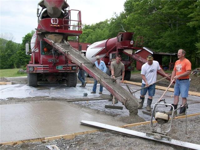

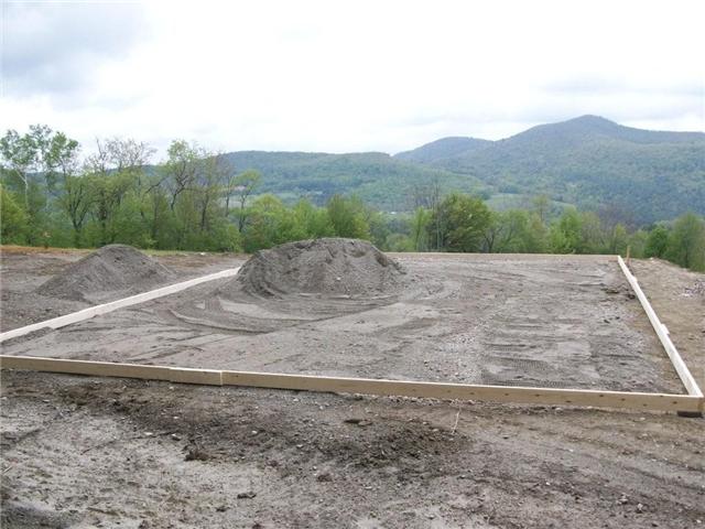

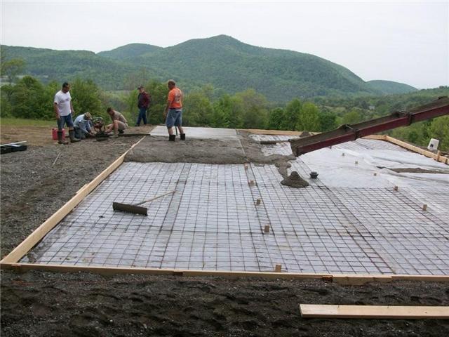

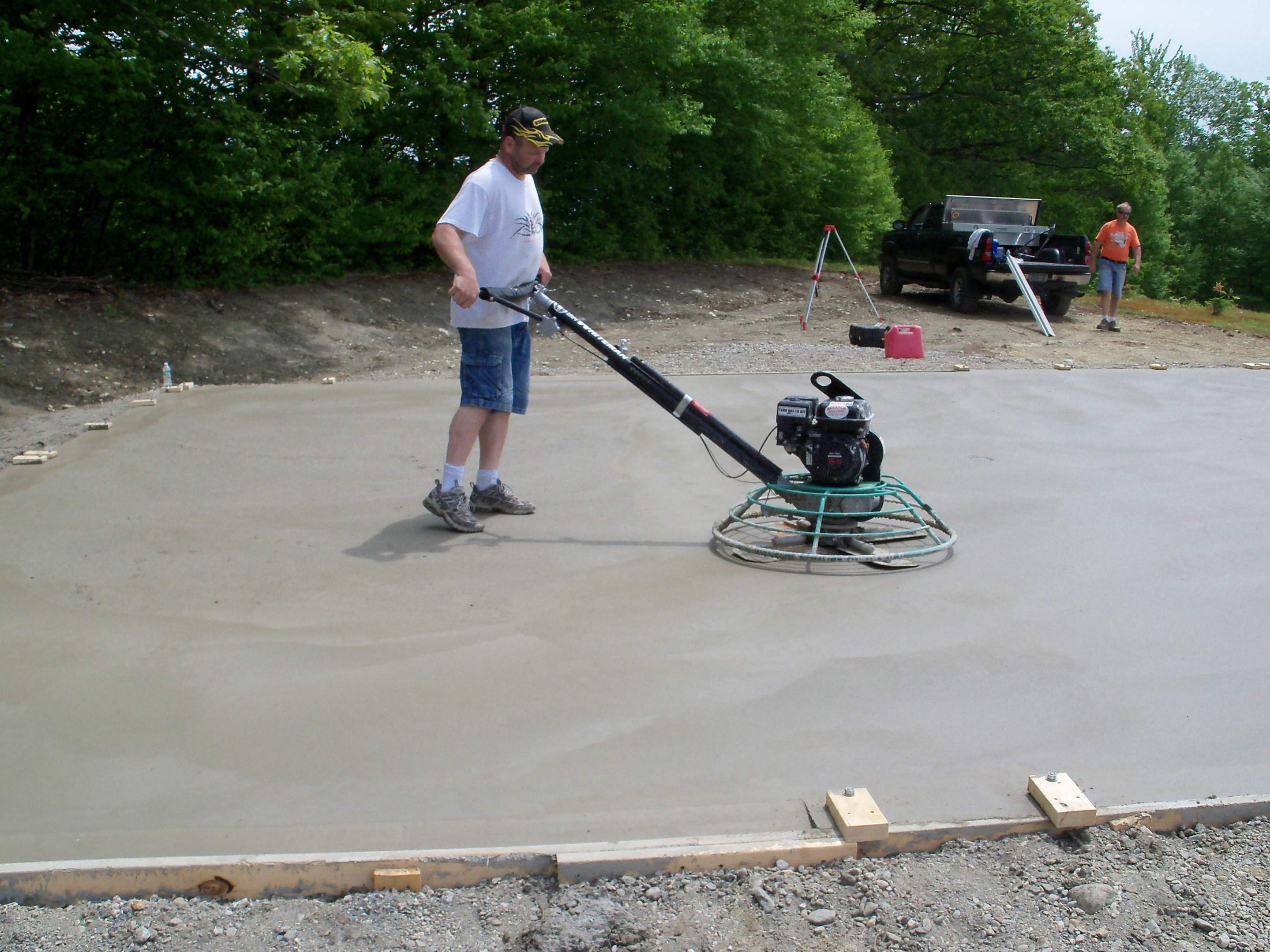

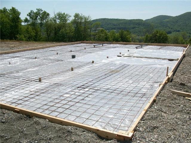

About 1 1/2 yrs ago we built a 28' x 42' barn. We had 3 guys inside the formed area moving concrete and power screting...
One guy on the outside, that was me, instaling J bolts around the perimeter. We had 3 concrete trucks each carrying about 8 yds each, showing up at my property way too quickly, they were supposed to be spaced out ..... time wise ! :confused:
This is a huge amount of work, believe me !
After all the dozer prep work was done we compacted the form area and then compacted some more, cant do enough of that !!! We also put dow plastic vapor barrier, and used wire reinforcing mesh over the whole slabbed area !
If your planning on doing it yourself make sure you have plenty of EXPERIENCED help around !
After the slab was completely poured , we got out there and power trowled it until it was smoth as a babies ***** ... lots of work but worth it JMO, as others have said once its done its done !
Good Luck ! :)
BTW the slab was 6" thick and about 10 to 12" just around the perimeter .

Do a Google on "Slab on Grade", " preparation for concrete slab" , "pouring/finishing concrete slabs", etc. :)
When you are ready to pour have one or two fellows familiar with concrete on your crew. One on the chute and the other finishing. It'll make your day go a lot easier. Try and pick a cool day if that is possible.:)

Personally, I would do it in one pour. Joints in a building slab are not desirable. Do what work you can and have the experience for and hire out the pour and finish work. You will be glad you did.
It takes at least 3 experienced folks to make a pour. You need 2 people on the screed and one with a comealong pushing or pulling the concrete to keep it level with the screed. That is assuming that the concrete truck has capabilty of moving the chute from the driver seat. If not, add one more person working the chute. If a large area of more than 10 yards, you need 6 or 7 so you can swap out and give the guys a rest(chute man shouldnt need a replacement) Even if the concrete truck driver is good and places the concrete evenly, there is still a lot of comealong work to pull the concrete into place, tamp it and rough screed it off. In cold weather, you have much more time to do this, but above 75 F you better have it down in 2 hours or so or you will be in trouble.
