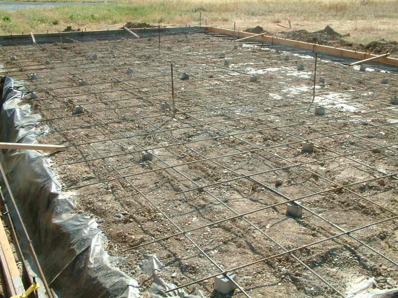

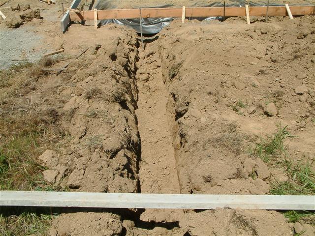

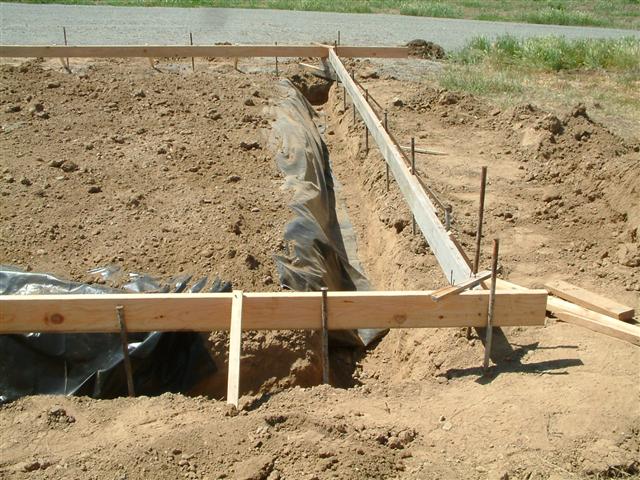

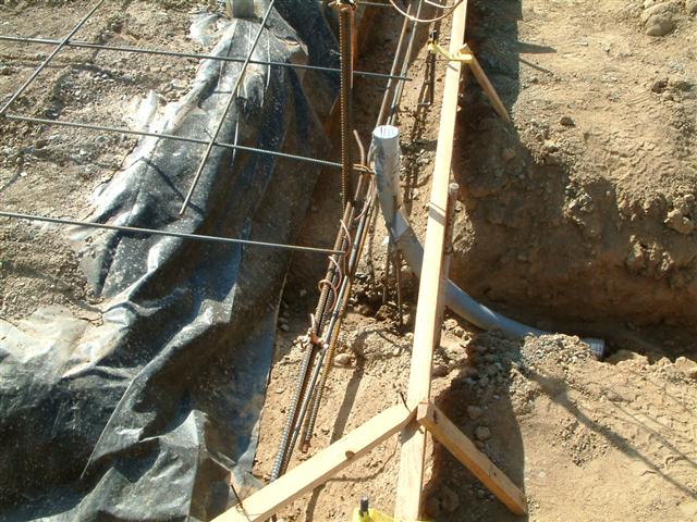

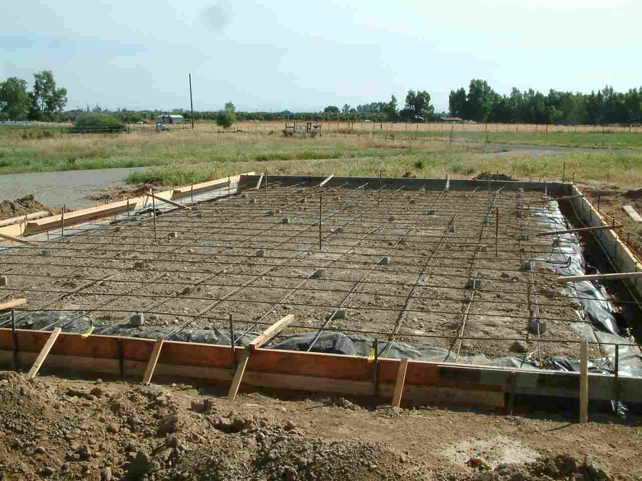

Here are a few photos showing the slab construction for my 24x42 ft shop (a metal building with 12 ft high walls, two 10x10 ft rollup doors). The slab is 6" thick, 4000 psi mix, #4 rebar on 24" centers, 6-mil Visqueen vapor barrier over 1/2" gravel base.
DSCF0037 (Small).JPGDSCF0040 (Small).JPGDSCF0047-small.JPGDSCF0061-smal.jpgDSCF0064 (Small).JPG
Trench for perimeter footings (essential to prevent slab cracking).
You'll need a TLB to dig the trenches and a lot of 2x lumber for the forms.
Good luck.

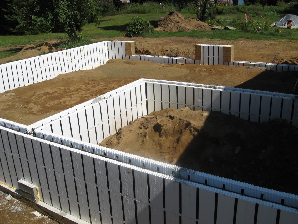

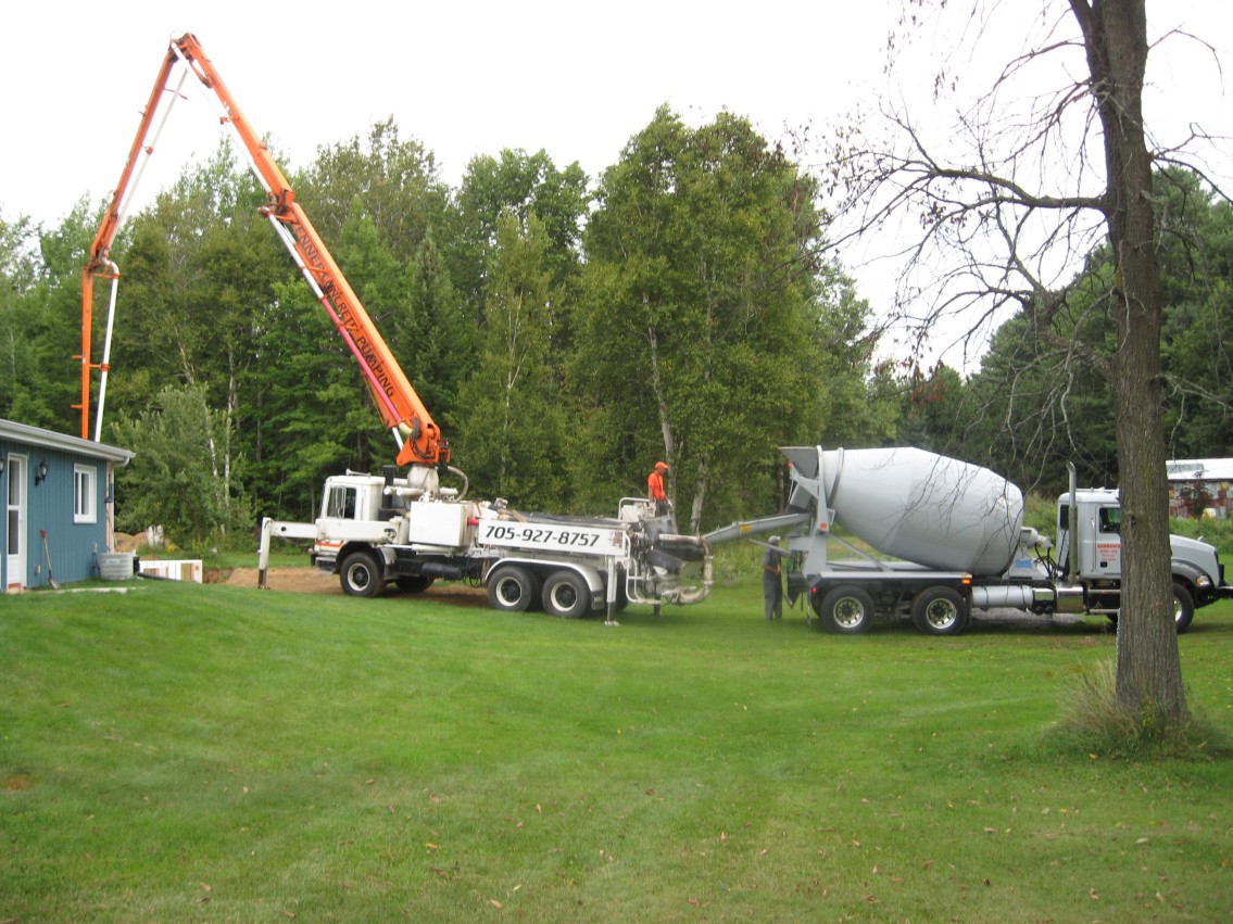

I have to do my garage floor this summer for an addition that I started last summer, twenty years ago it was a no brainer then it was mostly brawn now it is almost beyond my physical abilities so more brain is required. I will probably use a pump truck and some friends, lol, the problem is we are all getting older.:laughing: 828 square feet at 6" is 15.33 or 16 yards, lol counting the waste for the pumper. I attached some photos from the the ICF foundation.
   / Looking for info on how to pour a slab #33
So, I should be good on correct thickness and how thick it needs to be around the perimeter.
Looks like my main problem is that I have no mean to compact the base mateial.
As for the services, under the slab, I'm only going to have a drain. Power and water can come in above the slab.
