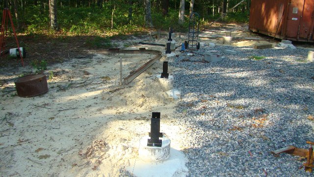

Thanks for all the great input. Right now I'm leaning towards the "bigfoot" footers, from what I've read, if I scrape down everything soft and get a layer of concrete on the hard layer underneath it right away (<24 hours), it should seal pretty well. I'm thinking scrape off the soft shale with the backhoe, place the footer with rebar mounted vertically and pour 12 inches of concrete into it. Let it set and then drop the post in place and pour concrete around it to fill the footer and sonotube above it. Planning to backfill with gravel as much as possible to provide extra support around the footer.
I put my barn on 12" round piers and attached them with angle straps that I made in my shop. I made them out of 2X2, 1/4" angle iron that I cut in 5 1/2" lengths. Then I got some flat bar that was 4 to 5" wide and I cut those into 6" pieces. I laid the angle pieces on my welding table and welded a piece of flat bar to each of the angle pieces until I had enough of them. When I was done the part ended up being an angle bracket that was 2" X 7 1/2". I drilled a 1/2" hole in the center of the 2" part and two 3/8" holes in the upright part several inches apart.
I then mounted the brackets to the piers using 1/2" anchor bolts and used 4" long 3/8" SS lag bolts to screw through the two holes I had drilled in the bracket and into the post to tie it all together. I used the 12" cardboard forms to build my piers up to my finish floor grade once I had poured a pier footing of 24" sq. I braced the footing with rebar and in the center of the footing I placed 3 pieces of upright rebar 6" apart in a triangle like shape all the way up to within 3 or 4" of the top of the pier.
If you are going to sit your barn on top of piers it seems it would be easier to use the form tubes rather than piers already made because they all need to be the same height once put in place but maybe I'm missing something.

Why did you decide to put the poles into the concrete, rather than mounting them on top of the concrete? You can buy galvanized pole brackets such as MX842 built that are inserted into the wet concrete after filling the forms. The poles will always be dry if you mount them on top. They will always be damp in the concrete IMO.
Or if you intend to pour a slab floor, following what Dutch445 did, you could dig down to solid shale everywhere then build it back up with compacted sand and stone to create an Alaskan or floating slab foundation. You could put in pipes for some floor drains if you want, they are nice to have. I guess that depends on the nature of the shale. If it isn't really bad, I think it will outlast your building by a couple centuries as a stable base for the slab :D
You would have a choice of standard stick construction--just as homes are built with a j-bolted down treated bottom sill plate with sill sealer under it -- or poles fastened to brackets, if building on a slab foundation. Or combine the methods if you want.
I think what you are planning works too, just throwing ideas out. I've never liked the idea of wood in dirt or concrete but I know it's done all the time. Last year a TBN poster took down a pole barn that was 15 or so years old IIRC, he said most of the poles (they were in soil) were still in real good shape.
A lot probably has to do with the soil type, the site drainage, the quality of the wood in the poles, and the quality of the pole treatment. I guess bottom line, keeping the poles in the air removes all of those variables.
I've been going back and forth on poles in concrete vs mounting on top. Mounting on top is easier, but with the drawback of less resistance to racking. Any thoughts on framing modifications to compensate for this? I'm sure it's possible, I just haven't come across it in my research yet.
