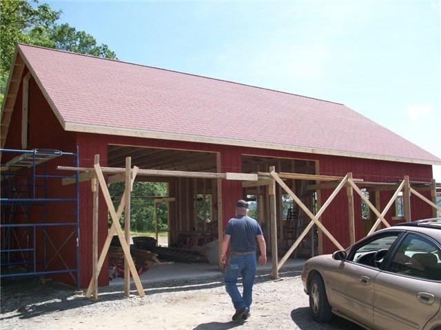

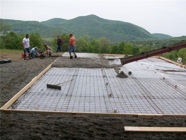

Good Afternoon hkhi,
I know Im kind of late to the party here, but are you completely sold on a pole barn building ?
I built my barn on a Alaskan slab, about a ft around the perimeter and a 6" floor thickness. The site was vibratory tamped, mesh reinforced, and then we poured 4000 lb concrete. I believe we used about 24 yds for a 28' by 42' footprint. Three 8 yd truck loads.
To date no cracks. Winter temps can get to 25 below, although we havent had any temps that cold in the past two years since I put it up.
I also used truss construction, those trusses are built for the type of snow loads we get in this area..
BTW the concrete was about $90 per yd at the time I believe...
I did consider an alaskan slab, but coudn't find a reasonable estimate. What did you pay for yours? I was being quoted ~$16K for a poured foundation and floor in my 40x60. Maybe that was reasonable, but adding 16K to almost 20K for materials, trusses etc.. was getting overly expensive. With a pole barn I can wait on having the floor poured.
