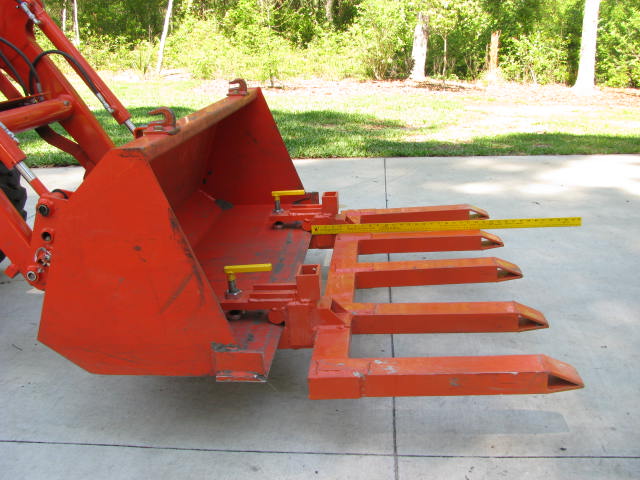

I have Debris Forks. I have to load entirely too much debris by hand. Get a Grapple.

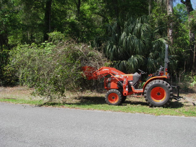

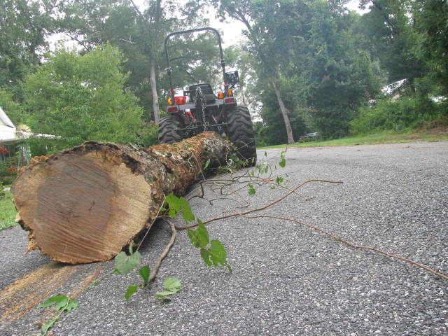

For pulled stumps you will probably tow them with a chain choking the stump at one end, with the other chain end attached to the axle-height center drawbar of the tractor. Due to those large rear wheels, creating a huge mechanical advantage, even small tractors can PULL heavy objects.
Tractor in the pictures is my old Kubota B3300 SU.
