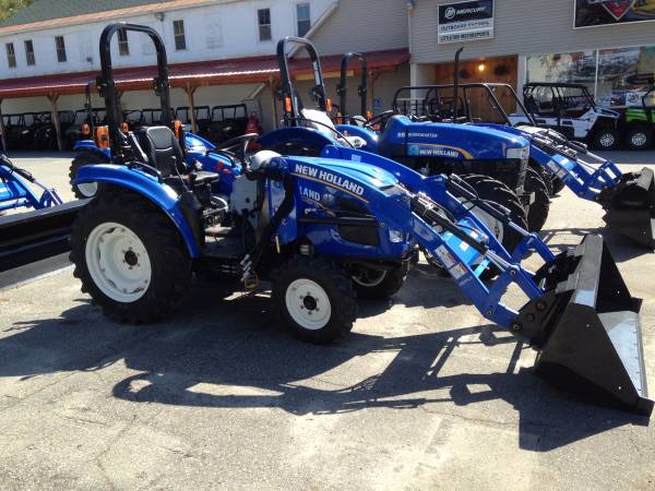

Here's a couple nice ones:
L.F. Trottier & Sons Inc. - L.F. Trottier & Sons Inc. Website
