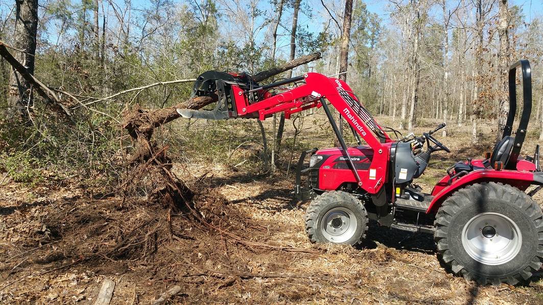

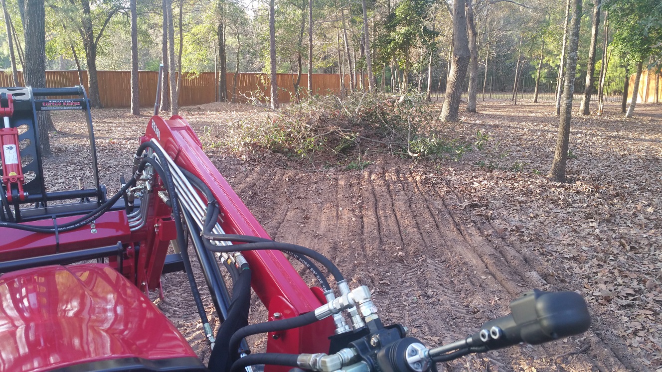

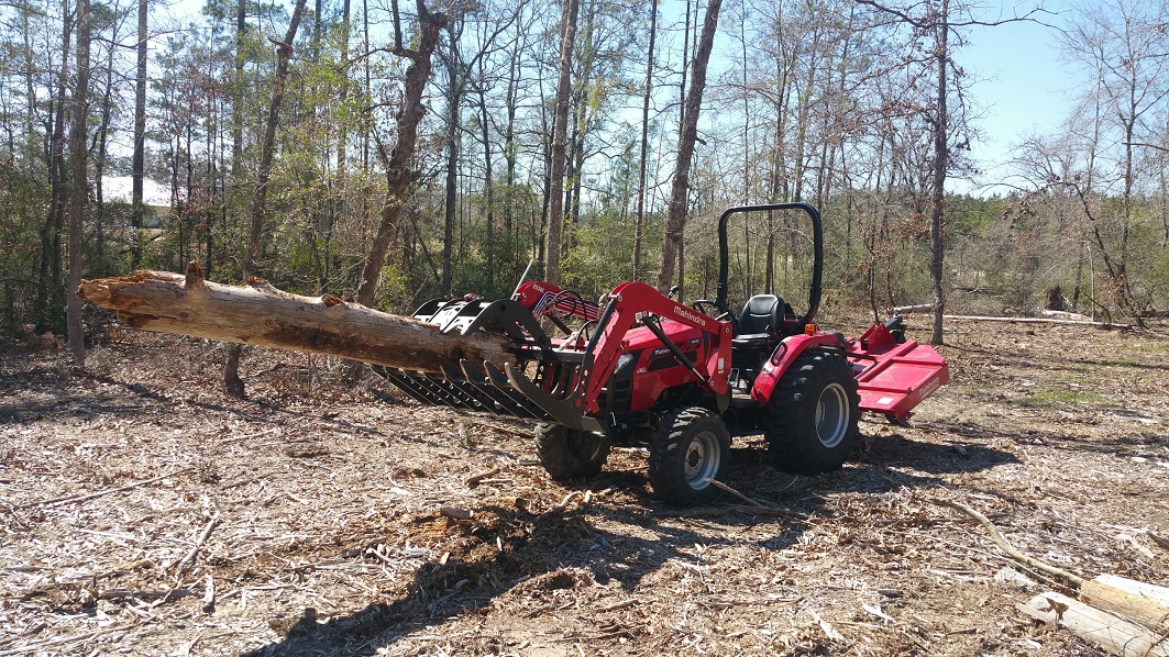

Excellent advice up above. Everyone, shares great wisdom here. I had a Max 25 SCUT that worked great on 2 acres with 1 acre wooded, but I found that it was no match for 16+ acres of partially cleared woods with remaining deadfall and dense brush. Ended up with a unit that I could still tow with a half ton, but was relatively heavy and capable. The Mahindra 2538 HST with grapple and 6' implements is a suitable fit for my tract and would be enough for your needs as well I believe. It competes with the Kubota L3901 and JD 3038 E which would be good options as well. Kioti's, Branson's, New Hollands, LS etc.. in that size/HP range would work too. 35-40HP +/-. For cost calibration, in TX you can get the Mahindra 2538 HST FEL with a 5' cutter and 5' box blade for +/- $21,000 pre tax, so it might be a bit more tractor than you were considering, but very close to budget. Maybe you can get an LLC running with Timber sales tax exemption for your ag and timber purchases?
For any major tree clearing or woods reclamation work I personally would recommend hiring out an excavator and couple of guys with saws if you wanted the firewood. Maybe start by bringing in someone with a skidsteer forestry mulcher to cut your trails through the woods and then have fun with your tractor until you decide on final property utility. You could do all of that with your tractor and some chainsaws, but it would take a lot of manpower and time. (Which is great fun too if you have time to spare.)
Grapples are pretty handy when you have any measurable amount of wooded area to maintain, so you really consider one of those with a 3rd function kit. (Or at least pallet forks, or a bucket thumb as a stop gap). A grapple would be my first major accessory if I were you, (after box blade and cutter), and also get a $12 steering wheel spinner which you'll enjoy on these power steering machines while in the woods.
Most importantly in my opinion is great dealer support. That personally would be my number one factor in considering your brand choice. I have Mahindra, JD, Branson and Kubota dealers equidistant from my place <5 miles. Far and away the guys at J5 Mahindra were most helpful and always willing to wait on, and work with me. That counts when things go sideways which they might just do with any brand.
Medium size CUT examples of capability: (insert any brand comparable tractor in here as they would all be fine...)
Good luck and stay safe while operating. Watch lots of video on safe operation and check out this great forum for terrific advice and key learnings from others. TBN'ers are really a great group of guys and gals and have helped me out tremendously!
