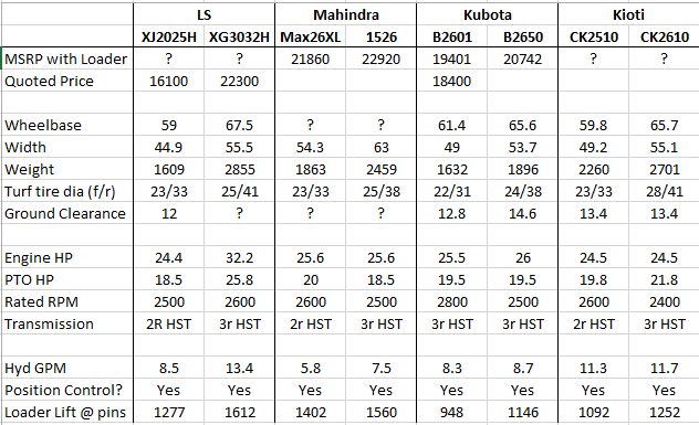

So I visited my new home today to see progress on the house and take another look at the "grounds."
Still just dirt for now but I'm going to estimate 2.5 acres of flat lawn. The driveway is closer to 700 feet long. Maybe a little more moving of dirt and debris than I originally considered. The loader will get a lot of use.
Leaning towards a 3pt finish mower for the bulk of the lawn. Might not mow as fast or as well as a ZTR, but will get the job done and minimize complexity for me. And it's cheaper. More $$ for the tractor.
So yes I would like something that won't destroy my lawn. Will get turf tires for sure.
I'm going to try to visit Mahindra and LS dealers in the next couple of weeks to see those up close and chat.
The B2601 seems pretty much perfect for my needs except for the low loader capacity.
The XJ2025H doesn't have a 3-range HST but checks all the other boxes. Dimensions about the same as the B2601, loader much better 1277 @ pins, and the least expensive option by far. Here is my spreadsheet so far:
Still surprised at how much I need to learn to make an informed decision here. Would never have expected so many options to consider.
Can't buy til May so I've still got plenty of time to change my mind.

I would add the Kubota L2501 to your spreadsheet.

Your spreadsheet looks good. I would add:
Transmission Type/Speeds
3pt lift @ 24"
SSQA nice for forks, grapple, etc.
Bucket Width
Foldable ROPS gets it in your garage
Extendable 3pt arms Didn't think they were a big deal until I had them
3pt stabilizer bars Didn't think they were a big deal until I had them
Drawbar Nice to hook a chain onto for heavy pulling (stumps)
Cost to add a Rear Remote? Nice to have if you need it (and you may not know now that you will need it later)
Cost to add Engine Heater
Cost to add Fluid to Rear Tires
You may not want or need some of these things, but could be negotiating assets.
