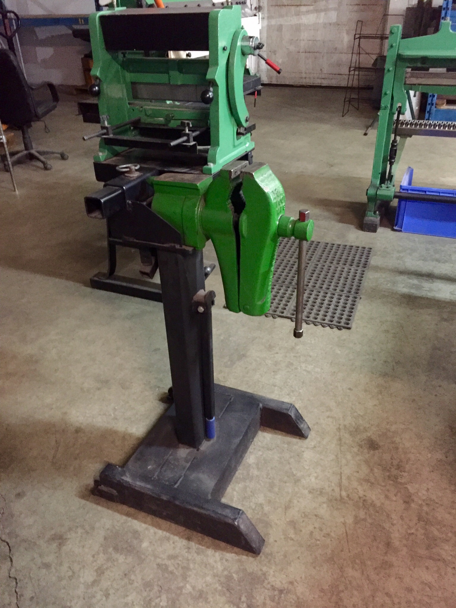

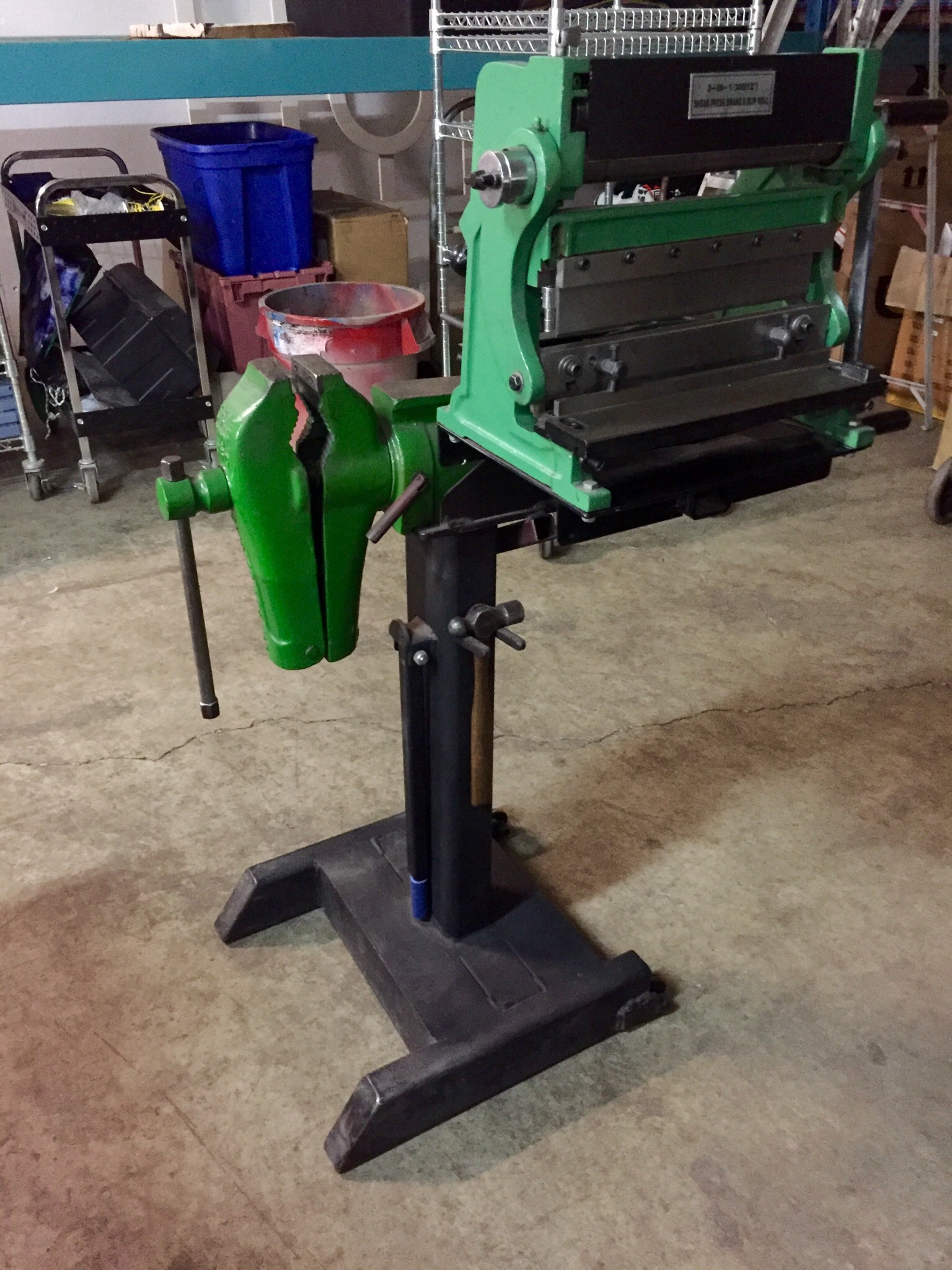

Here's a vice stand I made.
A 2" receiver which can hold attachments on either or both sides of the vice stand simultaneously. It moves easily by lifting the fold down handle and tilting to roll on a couple of 2" roller bearing inserts.
Picture shows a 12" 3in1 sheet metal machine on it (about 80#).

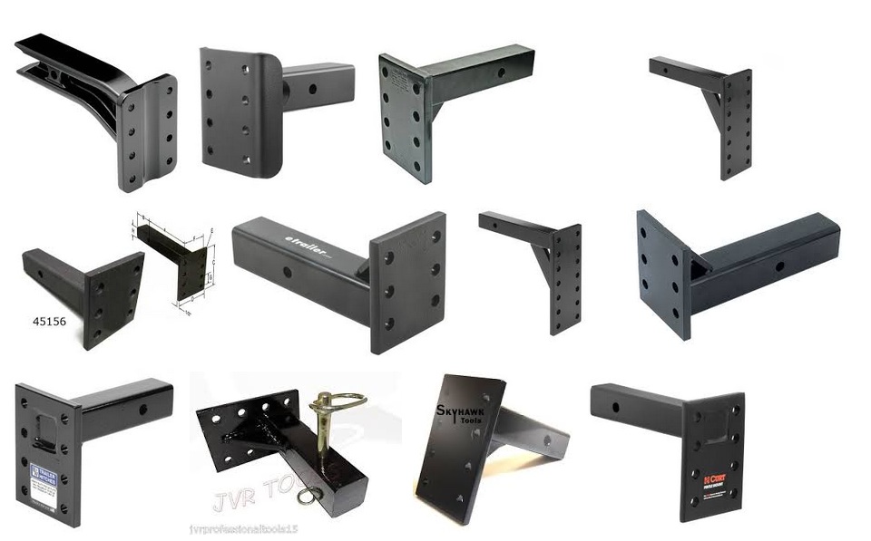

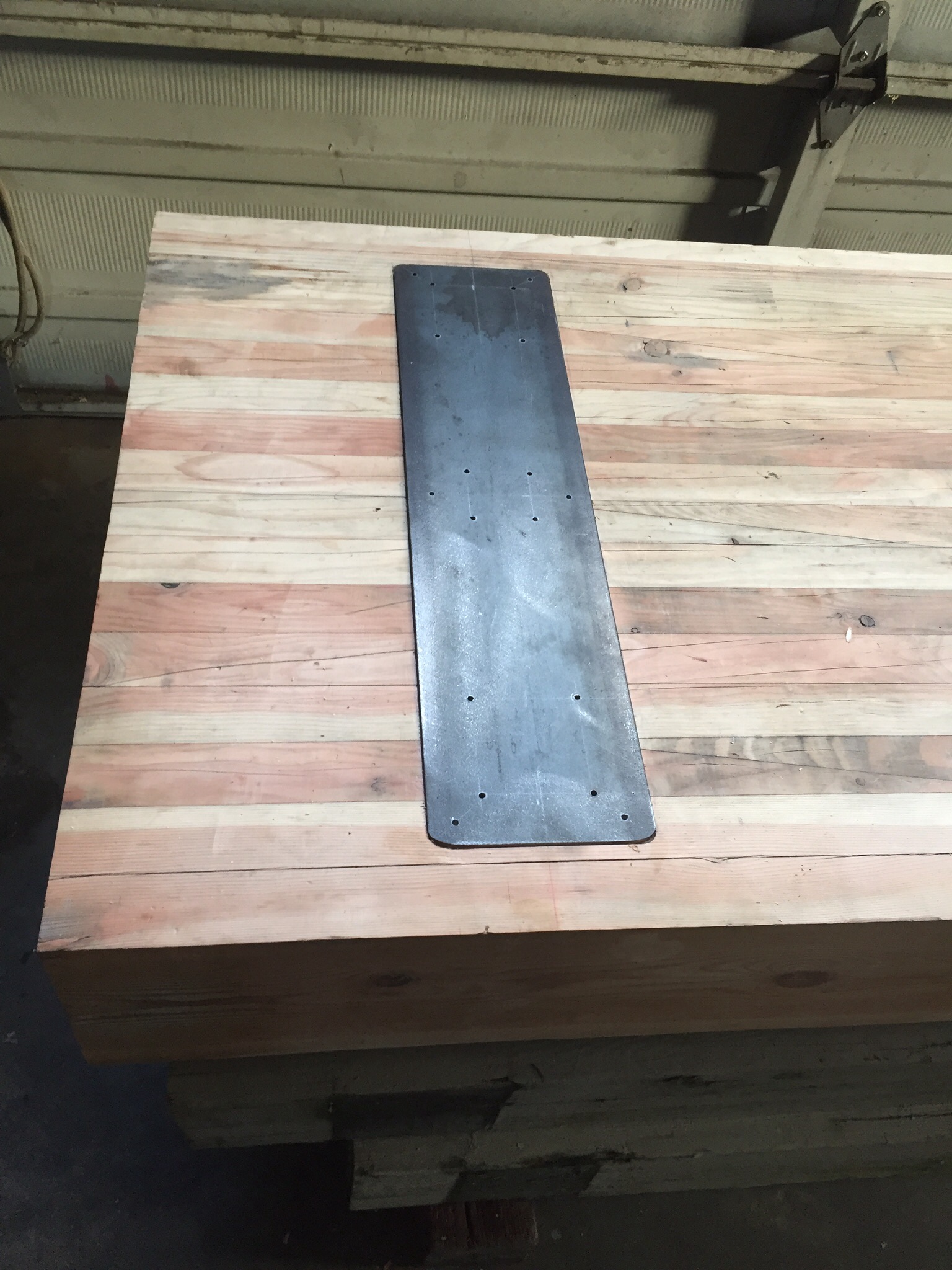

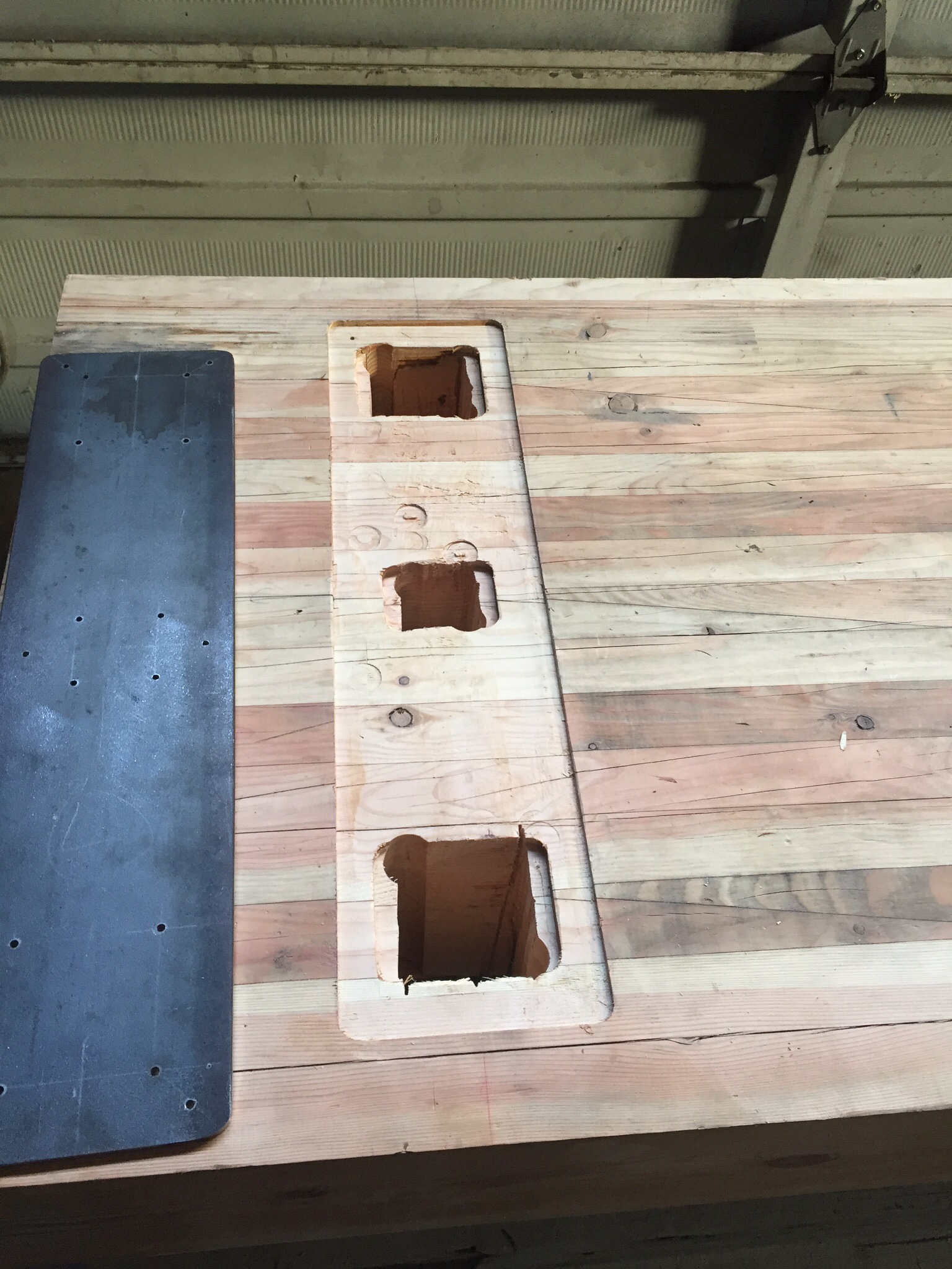

Coincidentally i'm currently working on my first VERTICAL receiver type application. I'm going to have two 2" and one 1 1/4" setup on each end of a wooden work bench I'm building. ((8' X 24" X 7")
Here's where I'm at so far.
Still have to cut square holes in the cover plate and weld receiver tube(s) to the underside.

That looks nice and heavy and sturdy. Are those feet and base solid steel?
   / Looking for vise attachment ideas. #8
Mark. No. Heavy wall rectangular tubing and (I think) 3.5"x3.5"x3/8" angle iron.

   / Looking for vise attachment ideas. #10
For vertical receivers in a bench, a pintle mount insert would be handy for mounting things.
