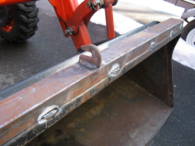

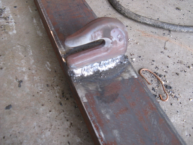

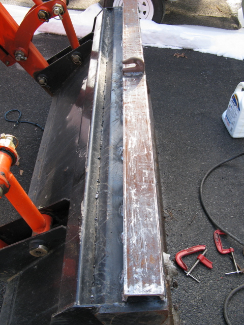

Thanks for the responses guys, here's some pictures of the results.
I ended up going with 7014 (what I had on hand, also have 6011 and 6013).
I went with 3/32 of an inch and approximnately 70-90 amps DC.
I used the 7014 as miller indicated they were medium penetration and used fairly slow passes.
I will definately try to take a community college shop course, I took welding in 8th grade, but as you can imagine that was some time ago. Just tough with working long hours at the day job, I'm sure you guys know how that goes.
I am anxious to use the hook, my old machine had a hook and I used it all the time, makes lifting stuff possible.
Thanks again for the great notes (I've printed and archived in my Kioti binder), I like the advice of 6011 or 6010 for first passes and then final (pertty) passes with 7014 or 7024.
Based on the lift capacity of the loader I think I should be good with my weld job, if not, will re-do with the deeper penetrating rods.

Wow Joel! Of course nobody has x-ray eyes but those are some good lookin beads!!!!

Thank you very much for the kind words.
I read through the miller guidance a couple of times last night. I think in the past I was rushing the weld, using sticks way too thick and running the bead way to fast and not focusing on the arc.
This time I went real slow, short arc and focused on the puddle, working to keep the stick at a fairly perpendicular angle rather than almost 45 degree as I had in the past. And I let the puddle move real slow, try to get a good blend of penetration and puddle.
What helped a lot was the youtube video one of the guys here posted, I realized how slow he was moving the stick compared to how quickly I had been moving the stick.
That with all the quality advice people like you and others offered, really improved my work product.

Looks like you can now use your improved welding skills to "fix" your C-clamp that gave its life for this project.
Nice Job!
/ Looking for Welding Advice #14
I suppose you are adding more hooks than the one in the photo. I would put one more on each side centered at the lift point attachment. Also the skip welds should be at least 2" long and preferable 3" on 12" centers and staggered across from each other on each side. This equalizes the forces along the entire length. Also for a stronger weld, weld from each end to the middle, in other words dont leave the end of your weld with the puddle exposed. THis is a weak point in the weld and susceptible to start of a crack.
7014 make pretty welds but sometime become highly brittle after welding. 7018 are much more ductile. For carbon steel with a DC machine, you cant bet the 6010/ 7018 combo. Use the 6010 for tacking and first pass and for anything needing deep penetration and then grind out all the slag and fill it and cap with 7018 carefully removing all the slag between passes and you will have a weld that will last a lifetime. One other tip, the angle of the rod is usually centered equally between the two base metals except if you are welding overhead then you want to point it toward the top piece more. I don't know if that is a clear explanation or not.

hello new to the forum not new to welding. I really like your 7013 welds but if you will slow your passes just a little more and when you flick your rod make them a little smaller you will get a little better fill and not have that concave look. what the call in my world undercut. And like some of the other guys said you need those skip welds alittle longer and closer together. But in the farm world that is a awesome job that you should be proud of!!!! I agree with the guys on the 7018 it welds the smoothest and also is some of the strongest welds that you can make. and with all of the talk about keeping them in a oven. I always heat my rods when i make xray welds other than that i dont worry about it or i just put the torch on them and heat them up till i think they are about 300 degrees (plenty hot to evaporate any moisture)!! the moisture will cause a little problem where the base metal and weld metal meet but is so small that I dont think it will hurt anything in the tractor world. but this is just my two cents worth!!!
