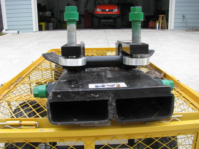

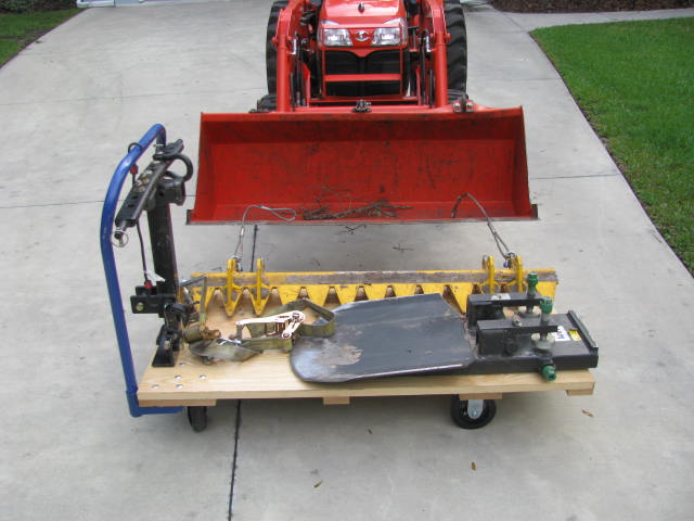

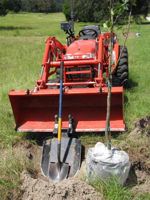

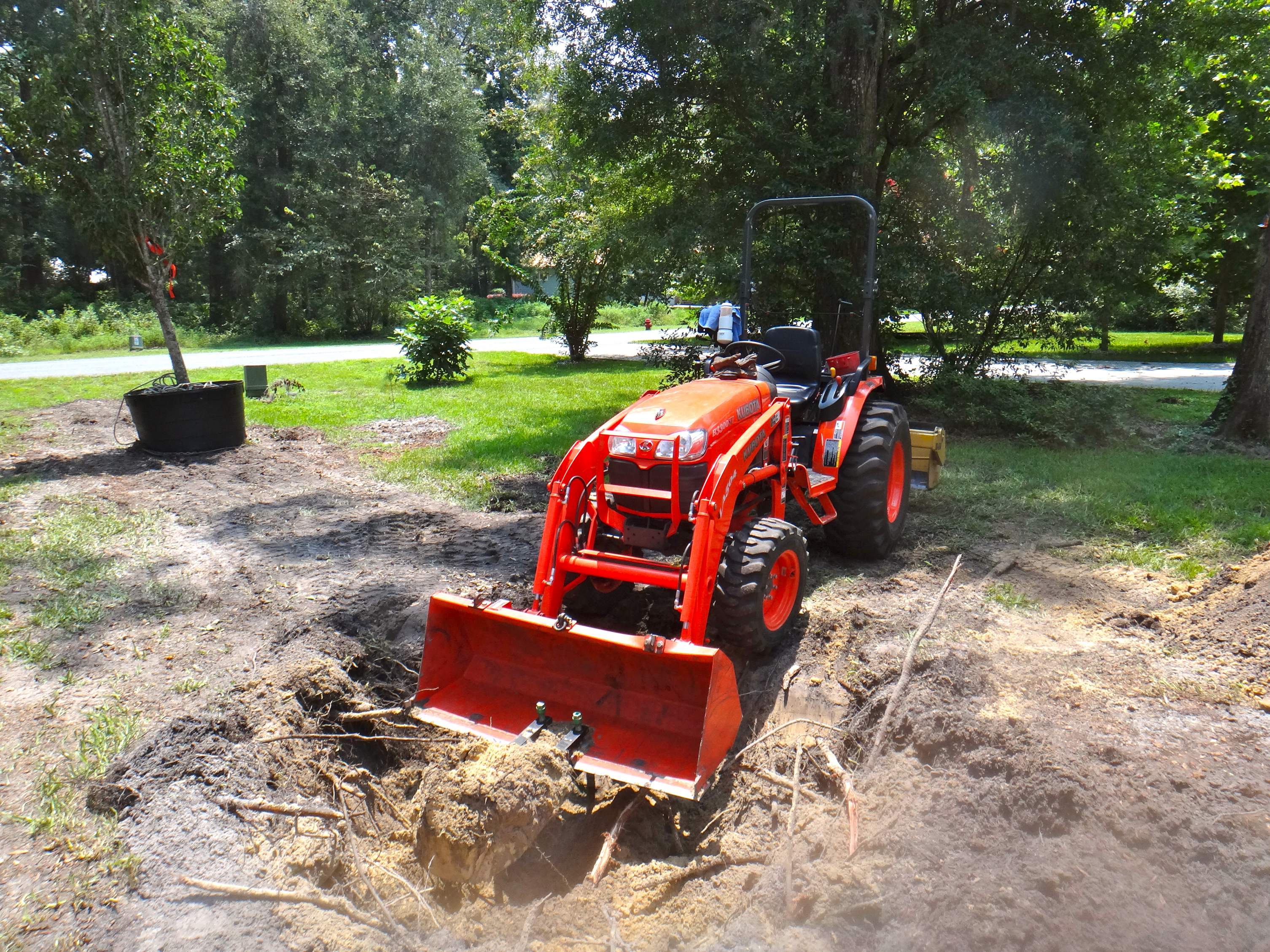

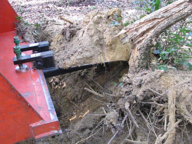

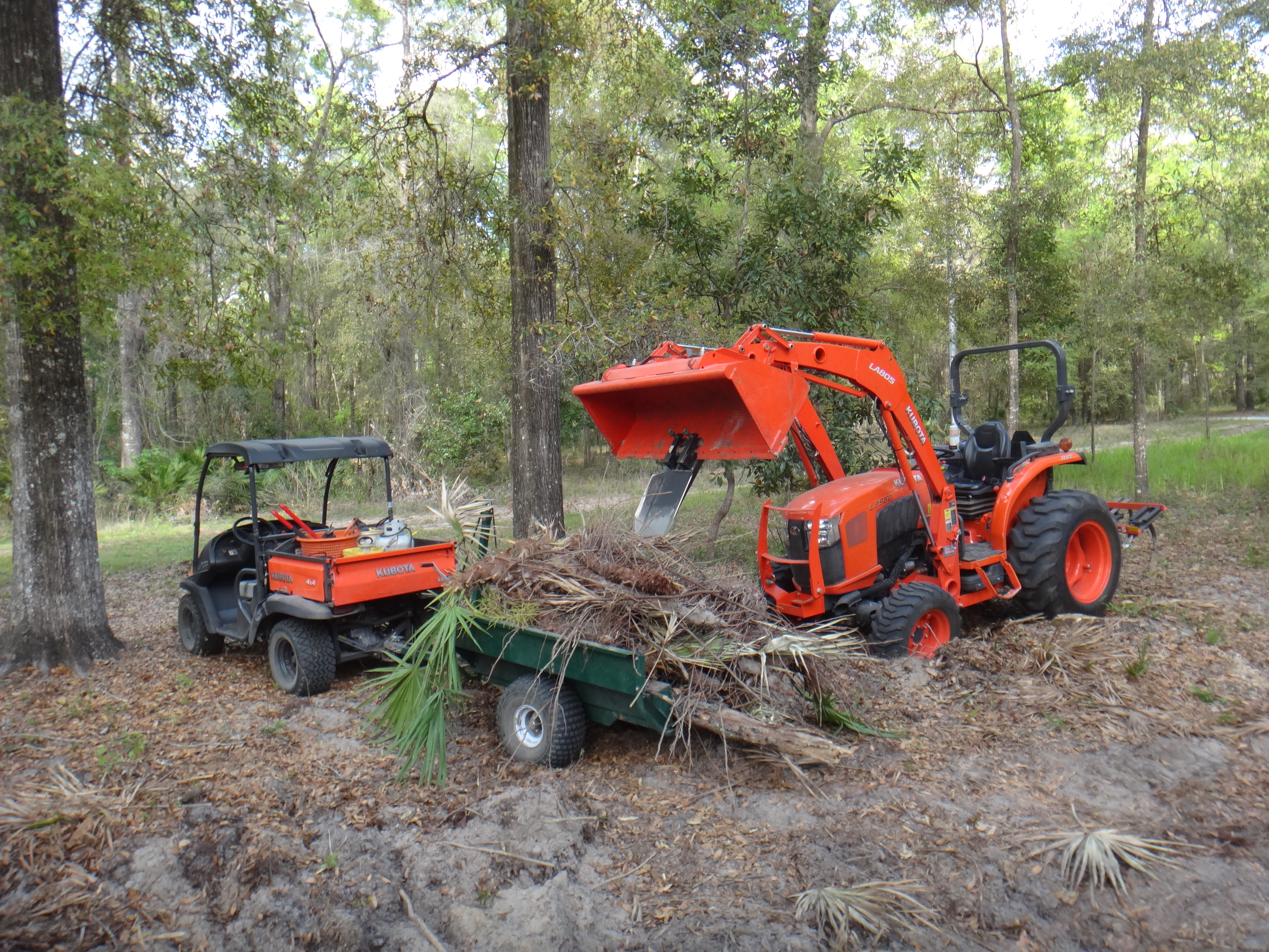

Be sure to order optional SSQA HEAVY-DUTY ROUND BACK-BUCKET for your FEL. You will be happy for its great strength working rocks. You will beat up the standard bucket in a short while.
Consider a Bucket Spade to save your back dealing with some, not all, those rocks. The Spade mounts rigidly on H-D R-B bucket. Better inserted into ground with some subtlety, rather than brute force. This attachment does 40% of what a Backhoe will do for $400.
I have been using the Bucket Spade for six years, on two tractors, and it looks like new.
LINK: Tractor and Skidsteer bucket spade shovel
Everything pictured here could be easily done with a bucket with tooth bar.
But 95% of what I've done with my backhoe wouldn't work with the spade shovel.
Example- 900' of water line ditch 40" deep, 700' electric line ditch 40" deep, 1100' ditch for perforated drain pipe 2' deep, digging tons sand stone out of the bank to build my road to the pole barn (Tooth bar on the bucket could barely scratch it let alone dig into it), Etc.
The spade my be handy for some things, but certainly does not do 40% of what a backhoe can do.
