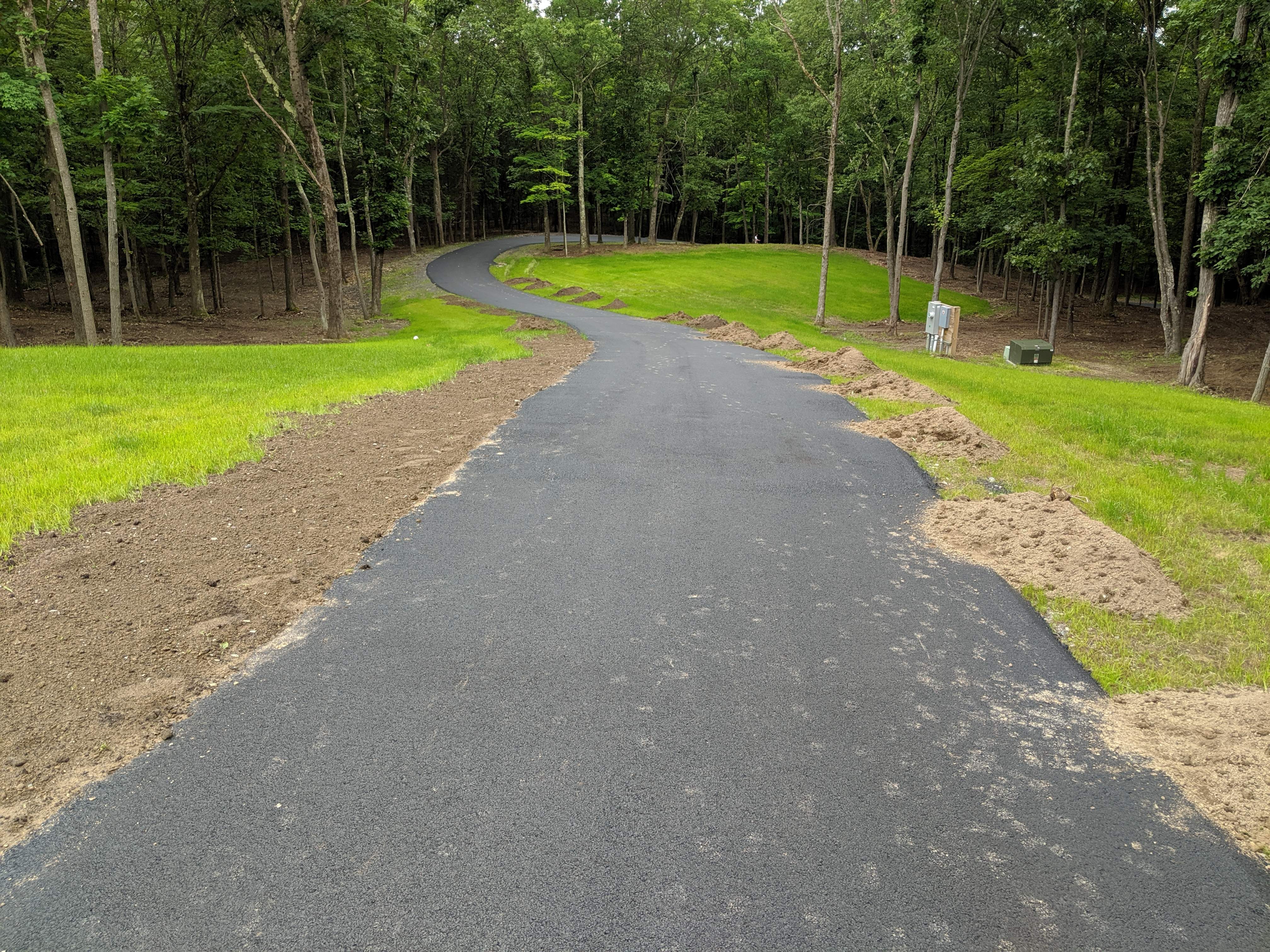

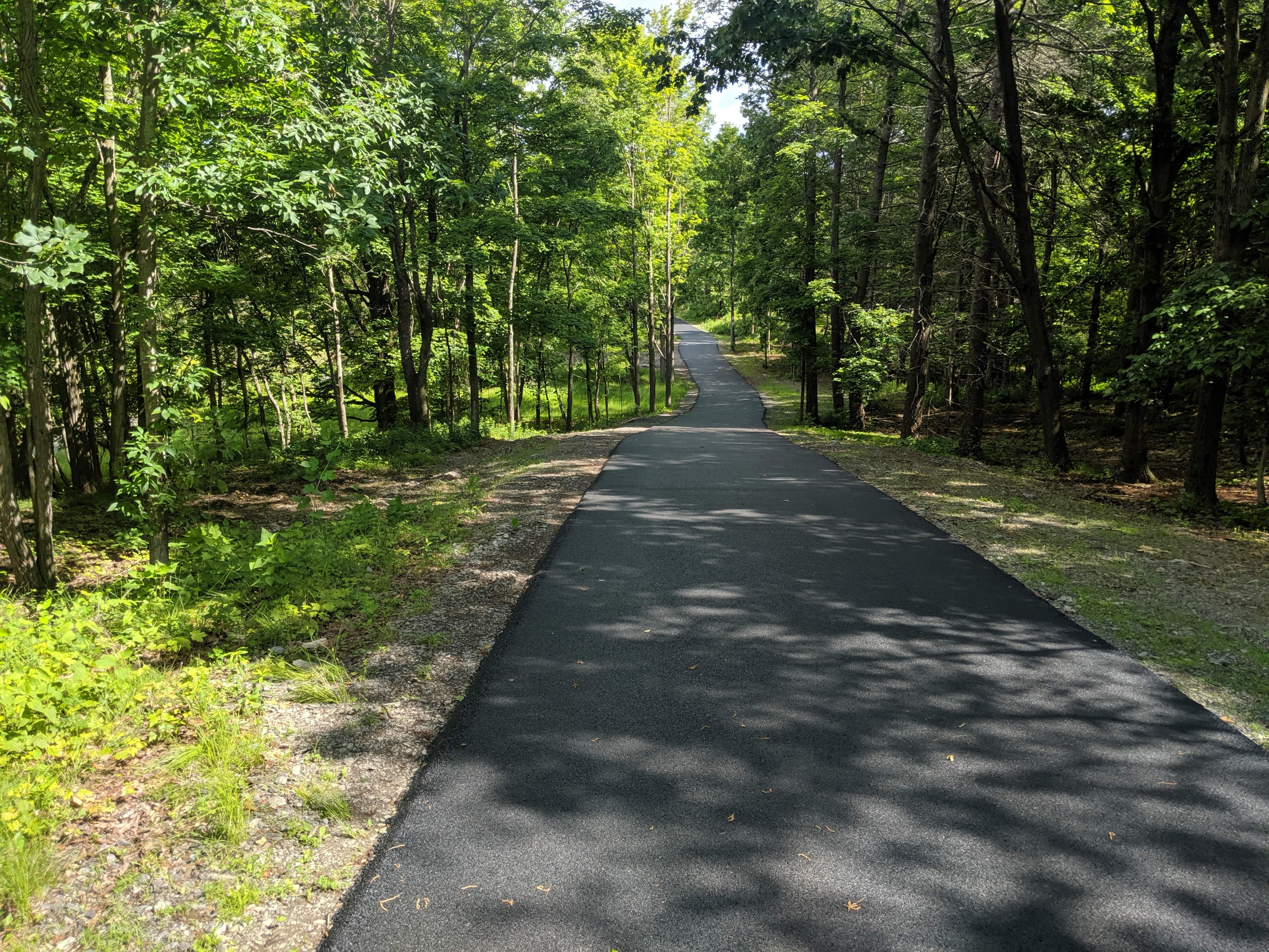

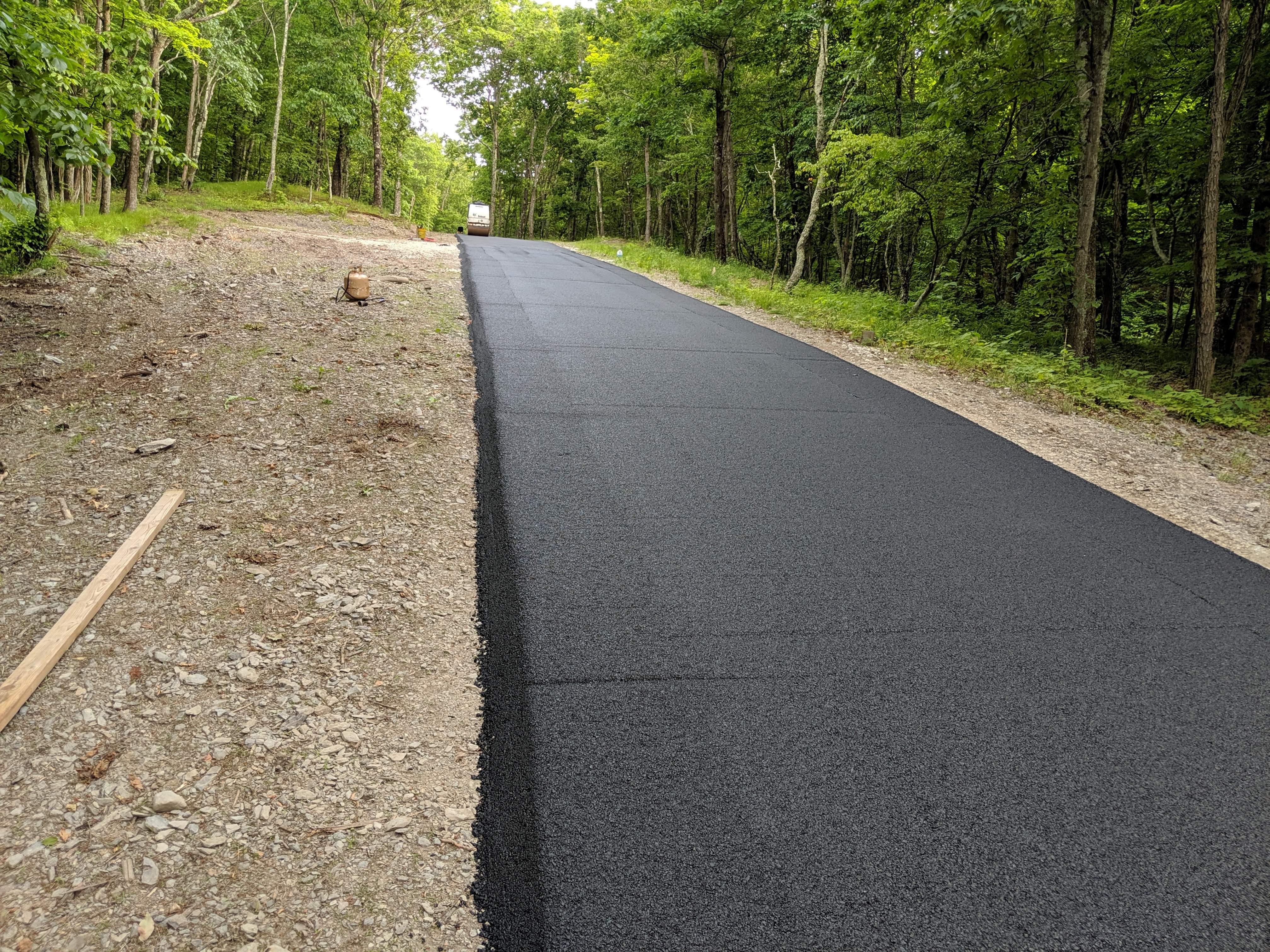

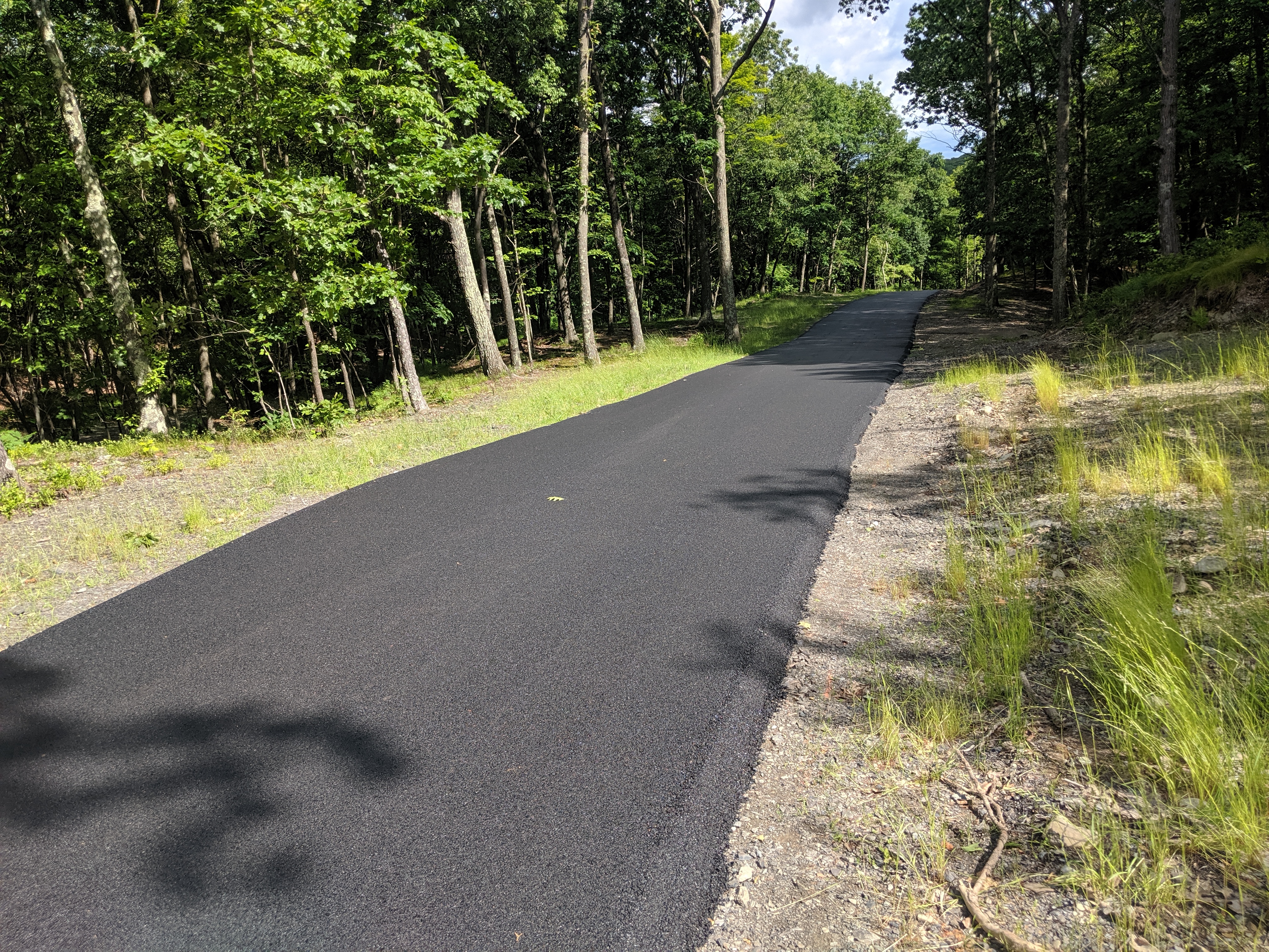

Im definitely getting turfs. I had them on my last tractor and liked them. I also think they are the preferred tire on snow. Its going off the edges that worries me the most. I did the dirt shoulders on a few hundred feet up near the house where there is grass. But there are a lot more exposed edges. Here are some pics of the edges that I'm concerned about.

Nice driveway.

Ah...a turf tire guy! I had turfs on a couple of tractors years ago and sure did like them. Very stable and low center of gravity. Noticibly better ride, too. And although there are times then they have less traction than Ags, there are just as man times when turfs pull harder. It helps that I don't do any real field work like plowing or springtooth where Ag tires are needed because they sink into the loam. So I stick with industiral and turfs.
But I see where your concern is. The driveway looks nice, but there is no hard edge to the asphalt and in fact it probably feathers out at the edge. And that dirt edge is sure to compact.
I'm not sure I see a solution except for time, and maybe some sharp gravel at the edge, but having turfs is gong to help in every way.
