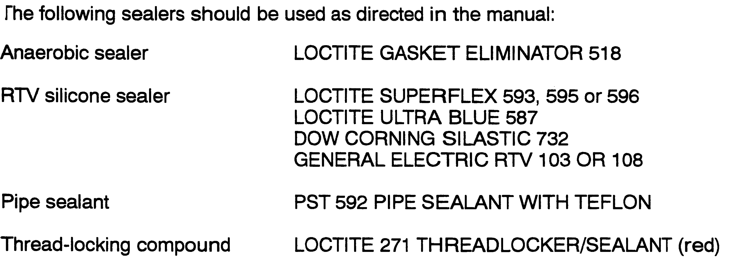

Indian Head will not provide a good seal.
From my New Holland service manual;
