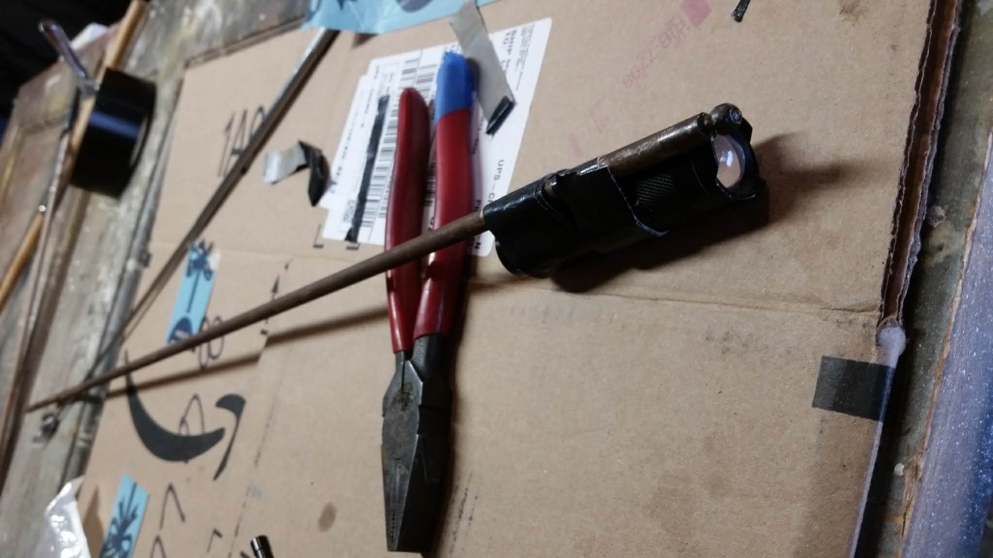

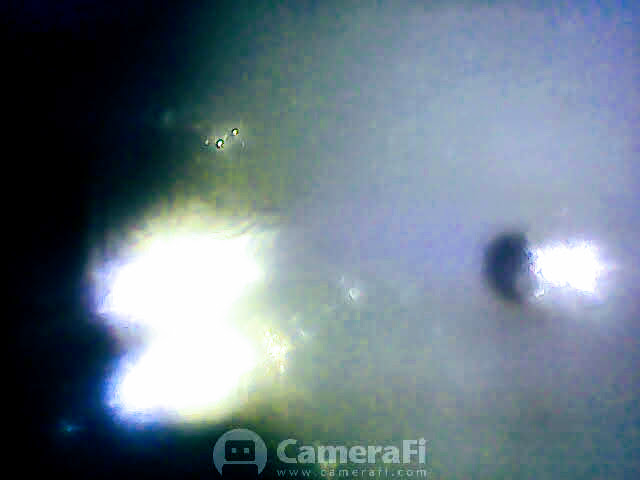

I think I may have found and fixed the problem. :dance1:I put the scope in the tank and there was some sort of cylinder where I thought the outlet should be. I couldn't quite make out what it was. I blew some air into the outlet hose and something rattled in the tank. I looked again, this time with a flashlight on a stick, and the cylinder had moved. Of course, I couldn't find my mechanical gripper so I fashioned a piece of bent wire onto a stick and fished it out. It looks to be the broken top off one of those auto shutoff gas cans. I have a new lift pump and fuel line on the shelf if needed in the future.
This is what I fished out of the tank. It was sitting right on top of the outlet.
Light on stick
Unobstructed opening
