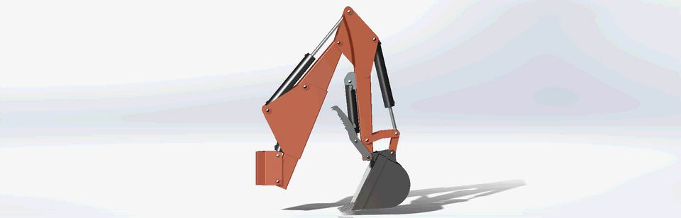

You mentioned 'computer skills' in a few threads back, but if you're comfortable with new things, try Onshape. (do google search, don't know if mods will allow link to source page). It is very similar to full blown Solidworks and ProEngineer, yet free*, read the free policy before you get terribly excited - wasn't a show stopper for me yet.
It allows full top down design with movement and animation - very powerful!
I am using Solidworks as my primary CAD, however, I have played with Onshape a good bit and there is a lot of similarity between the two. Modeling with motion almost takes all the fun out of fabrication in the garage...almost! I am currently working on an add-on thumb function to my BH7500 and a 'mini' Gannon style box blade with movable scarifiers: (separate threads will be started soon, once construction begins)

Very timely ... was just about to start a search for something that has forward and reverse IK that will run on my computer equipment.
I think this package came up at some point during conversations with a friend of mine that is a designer and is still doing 3D work.
Sounds like just what the Doktor ordered ... thanks for the heads up.
LOL ... :thumbsup:
Building it in the "virtual world" is sure a lot easier ... :laughing:
:thumbsup:
It looks like it will run (mostly) on the version of FireFox I have installed ... I'll check it out.
