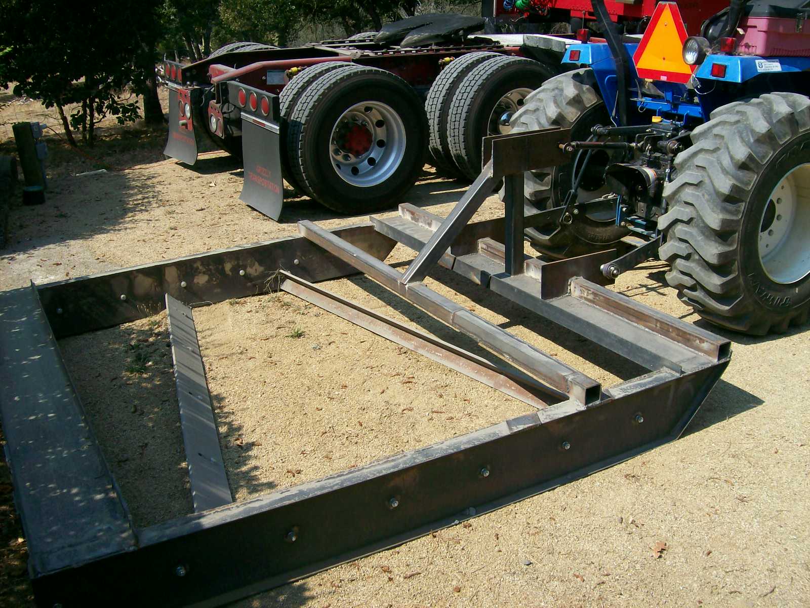

I have 2 that I have made, one about 7' wide and the other is 4 1/2' wide. Both have 4 crosses 2 on a angle and the back 2 stright. The 2 front ones have old grader blades turn around so the edge well cut better with the angle iron at 45 deg. I set the 3pt hook up to float and use the 3pt to do my adjusting while gradeing. I added 1' of skid plate after the last cross and as I get to the end I raise the 3pt up slow until it rides up on the 1' add on. That way I leave no piles, also the 1' add ons are turned up a little. I also made places to mount weights when I need to.
   / LPGS For Kubota B2910 #140

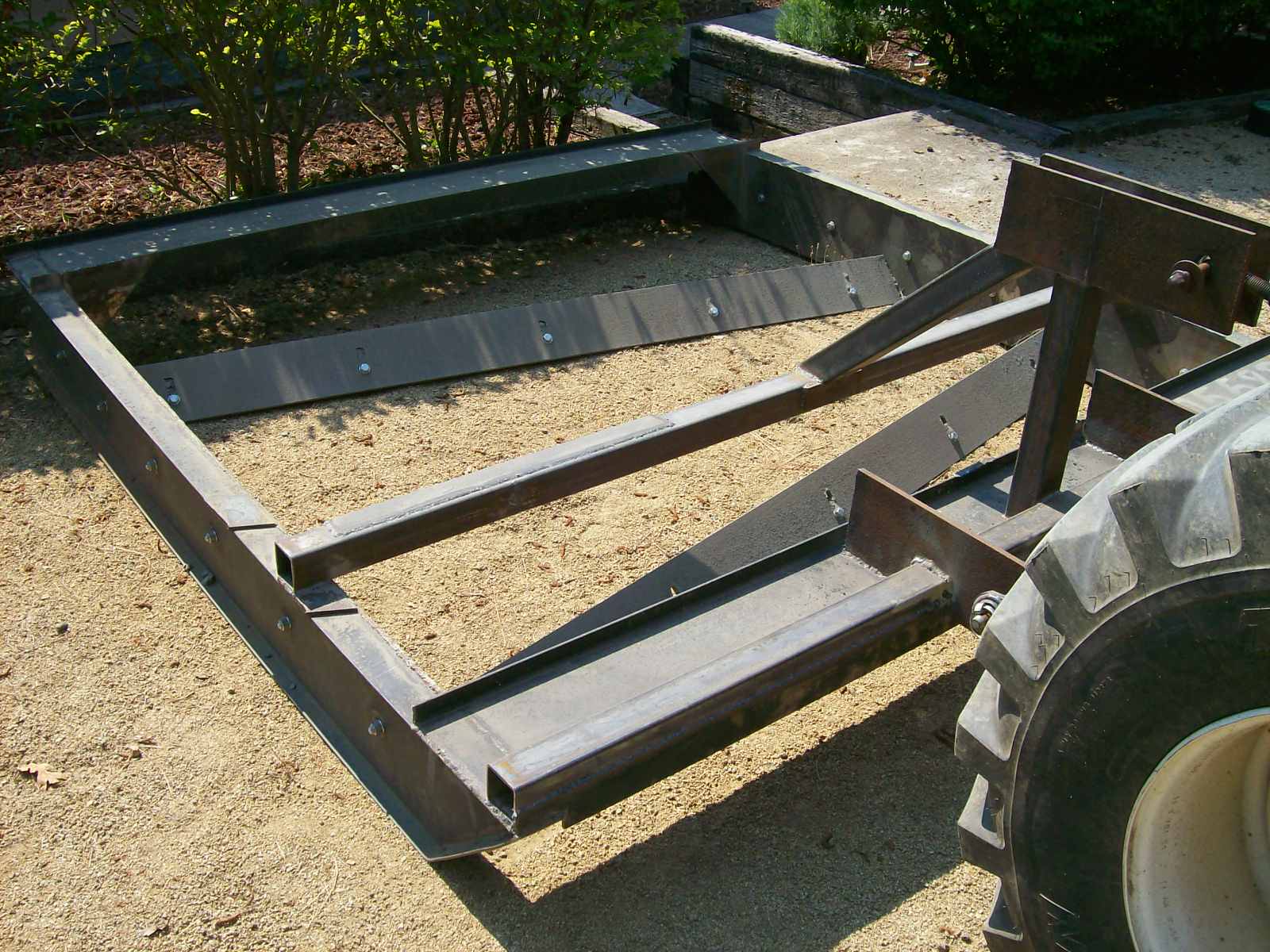

The one I made a few years ago , I used 12" I beam from a hitch off a moble home I think ?? ( it was in the scrap yard , So I bought it ) . Added 1/4" plate on the inside to create a flat surface . Used 3/8" x 3.5" x 3.5" angle for the blade mounts . Blades are angled back at around a 25 degree angle and angled from side to side at something similar I think . Blades angle opposite of each other when looking from front to back . For Blades , I used 1/2" x 6" stock . Did not even grind the edge . Driveway is shale at over 800 feet long . I run it up the driveway maybe 3 or 4 times a year , make around 8 to 10 passes during each of those outings . Have barely wore off the rust on the flat steel that I used for the blades . Move Rock ? Well Blades are only set for a 1/2" depth and that is the most I will run . Tried 1" and tractor did not want to pull all that rock up the 14% grade at top of driveway .
Not sure what it all weighs , but You know it when You pick it up with the TC30 . I have added a 2' piece of chain link fenching at the back as a sort of " Drag " , that takes out any minor sort of rock clump .
