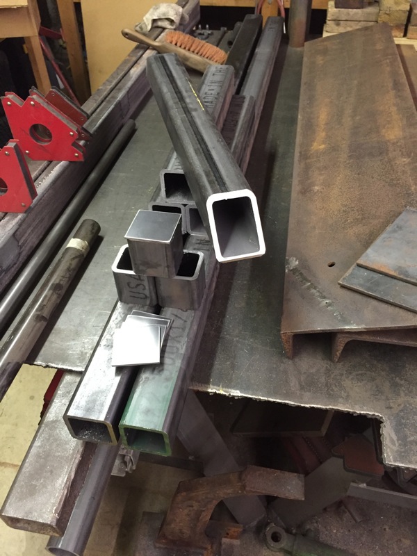

Got the 2 1/2" square tube for the 3PH frame all cut yesterday, including the caps for the tubes which I cut out of a 10 gauge drop I had lying around:
Also got the 6" x 10" x 1/4" "extensions" for the side plates trimmed to size:
May work on trimming down the 6" x 3 1/2" angle to 4" x 3 1/2" and splitting the drops into flats (6" x 1/2" and 3" x 1/2") today.
Looked at my Woods box blade yesterday and 1/2" thick material is what they used for the pin mounts on the 3PH hook up so I'll probably use the 3" x 1/2" for that.

Got bevels ground on the square tube for the 3PH frame for the LPGS, got the tube laid out and fitted up, and got it tacked together:
Probably weld it up today (so it can be moved without coming apart) and then work on cutting the angle.

Got the tubes on the 3PH all welded together today.
Also got one of the drops of that big angle split and cut the four tabs for the lower hitch points and got them drilled.
Tomorrow I'll get those welded on and probably stick the caps on the ends of the tubes.

In the picture above why is the rear long cross member lower than the front one? It is important to design for the least amount of twisting as possible. To plane well you need it to be as ridged as possible.
   / LPGS For Kubota B2910
#129
Because the front cross member on sits on a pair of risers made out of 2 1/2" square tube that are 2 1/2" high ... ;)
No doubt.
