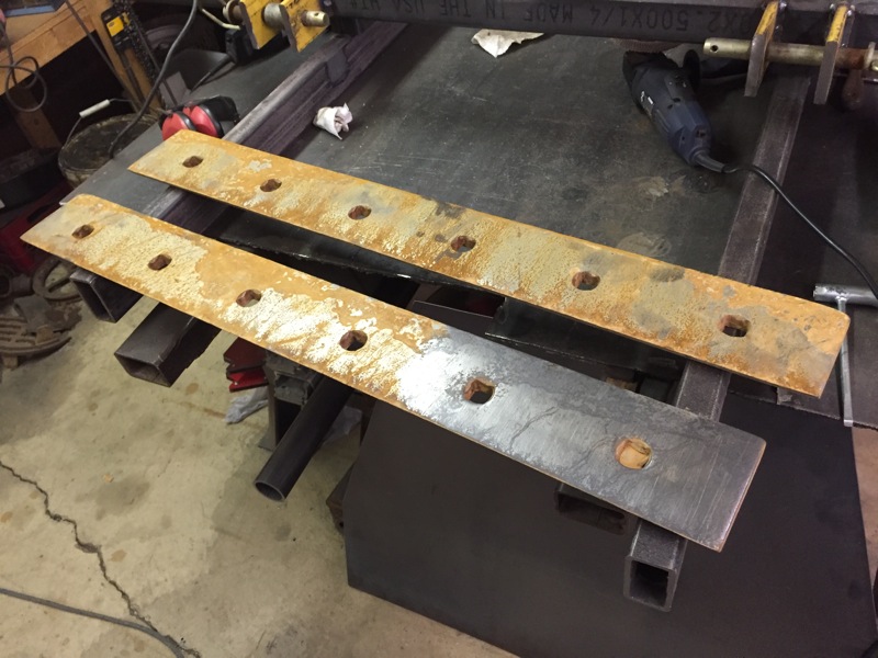

Next door neighbor - the heavy equipment wrench - stopped by this evening bearing gifts of treasure.
They're 37" long x 1/2" thick ... holes are on 6" centers. He didn't know what they came off of, and they're worn down a bit (4 1/2" wide) ... one side is considerably more worn than the other ... 1 7/8" from the center of the bolt hole to the edge vs. 2 1/2" from the center of the bolt hole to the edge on the other side:
The backs are kinda crusty ... probably work them over good with the needle scaler and then hit them with some phosphoric acid:
   / LPGS For Kubota B2910 #149
Hmmmmm.... Not sure what they would have been used on. They are from a cutting blade of some kind. Look how the end is worn off more. Almost rounded. That's been a leading end of a moldboard of some kind. But they should work great for you.
   / LPGS For Kubota B2910 #150
They look like a reversible boce from a backhoe. (front bucket bolt on cutting edge) Should work if they are worn close to equally on each half. I'd put the point in front to do the cutting.
