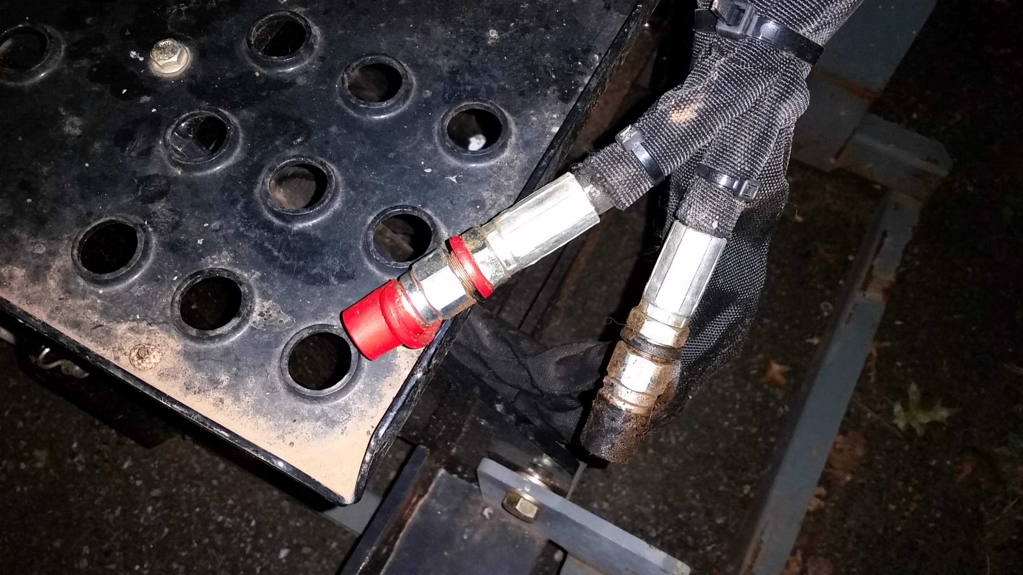

Speaking of remotes ... It looks like my rear remotes are 1/2" but the female quick disconnect end on the backhoe looks like 3/8". I've read in the past about heat issues ... should I just replace the backhoe hoses between the backhoe control valve to the tractor remote with 1/2" hose and fitting? Going from 1/2" to 3/8" restriction will bill up heat will it not?
   / LS backhoe questions. please post pics of subframe mount. #32
Yeah, use 1/2" hoses and QDs for the supply and return. Since you plan to use the
AUX valve to power the hoe, it will also add restriction (and heat) to the oil. You
can reduce this by routing the OUT from the hoe directly into the tractor's tank somehow.
Some tractors have "extra" ports on the rear gearbox to do this, or you can return
oil thru the filler/vent neck.

I may be OK. I just used a caliper and verified that the female end on the backhoe hose to the tractor is 3/8", they measured the same size as my FEL connections.
The main backhoe hose to the tractor measured .670" OD and the hoses on the cylinders of the backhoe measured just under .500. So now I'm thinking I might be able to just swap the 3/8" female end for a 1/2" one???
I could get my caliper on the outside threads of the backhoe hose and they measured .660".

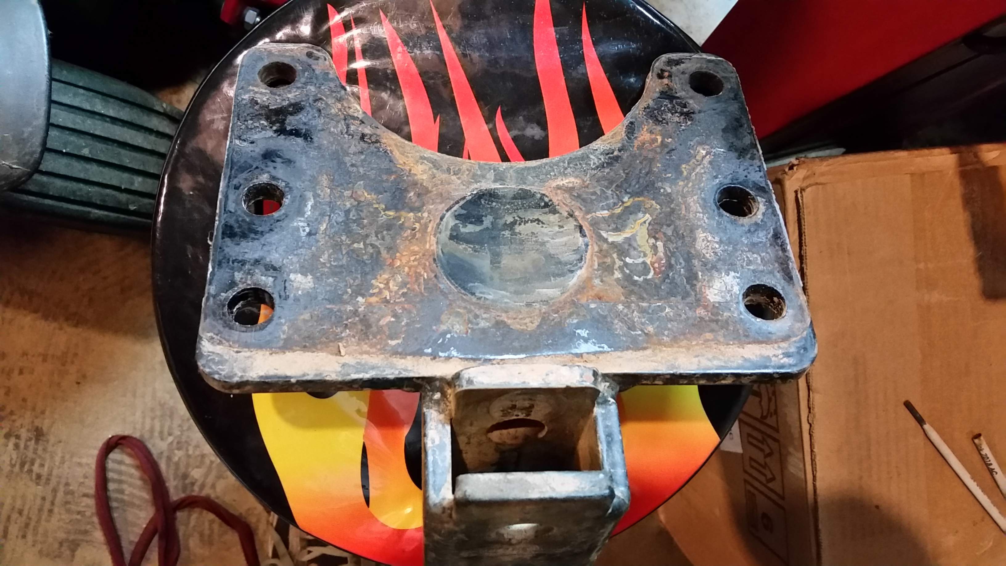

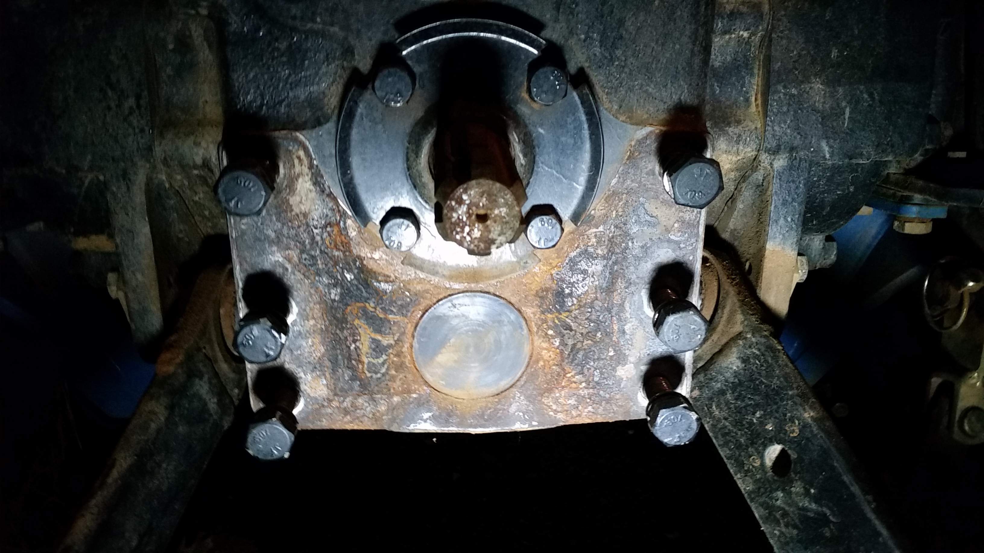

Well, tonight I took off the drawbar mount around the PTO. Hey look, they slapped bare metal together and then just painted over it ... cool!
Took the drawbar mount off to use as a pattern to trace onto a 1/2" plate that will be cut out to make the rear of subframe mount. I decided to go with a hybird type mount (I'll post another crude paint drawing of it soon to explain) and this mount will hold the back of the 2x4 structural tubing.

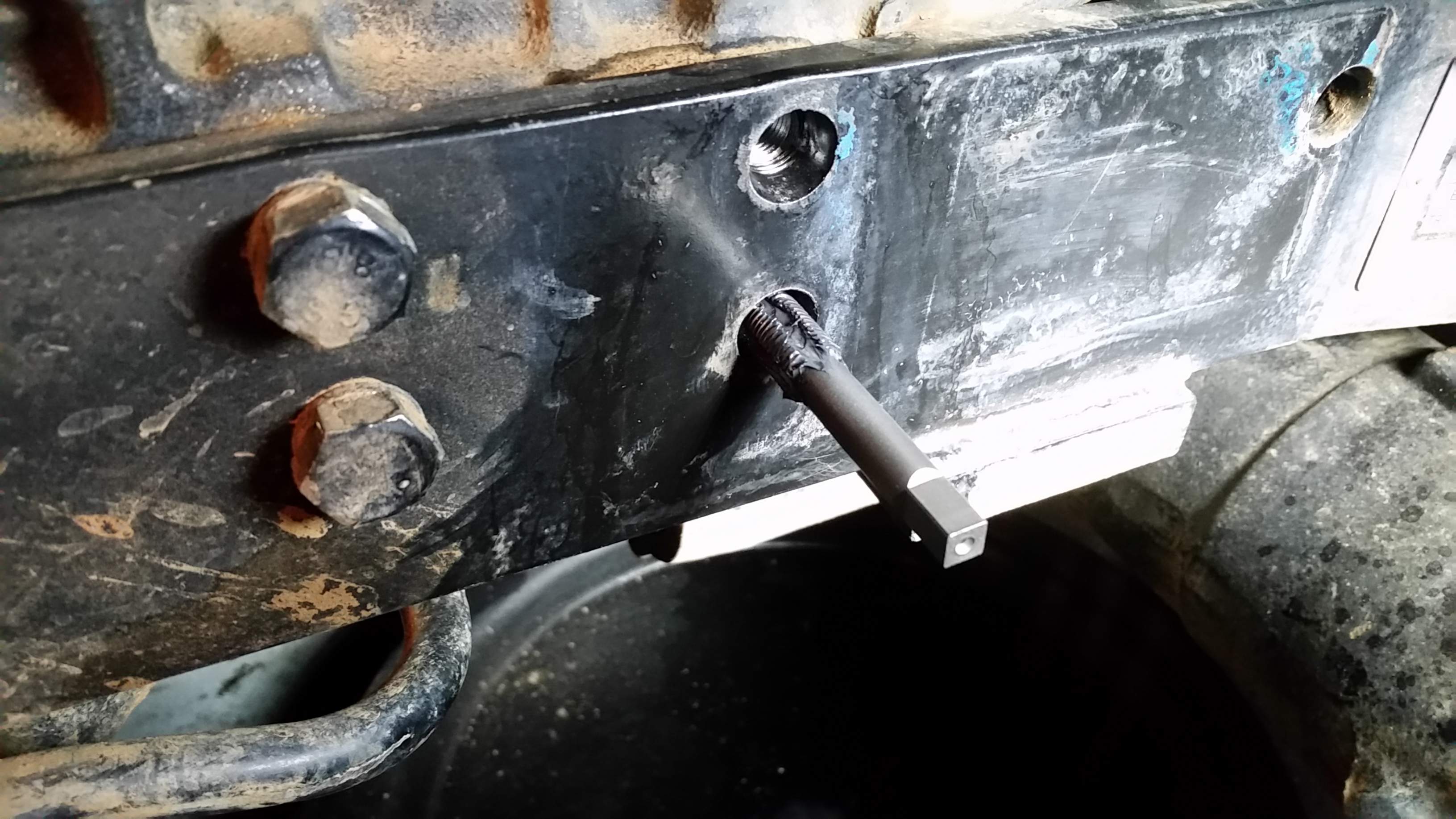

Next, loaded up a M12 1.25 tap with black molly grease and chased the threads of the holes where I found the rounded threads. The grease was to both lube the tap and encourage crusty crud to stick to the grease to be drawn out with the tap. Next was a good healthy dose of brake cleaner!

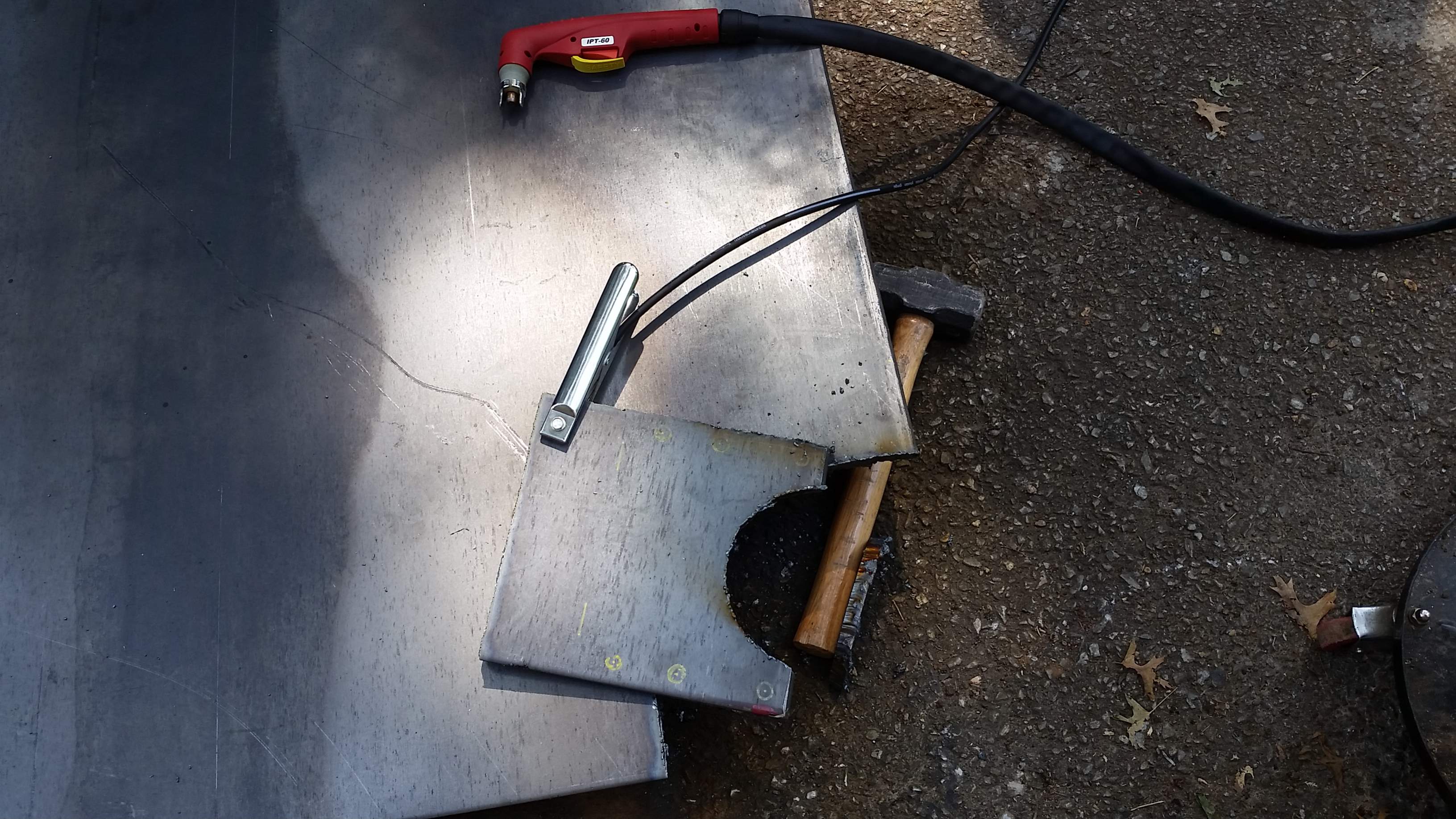

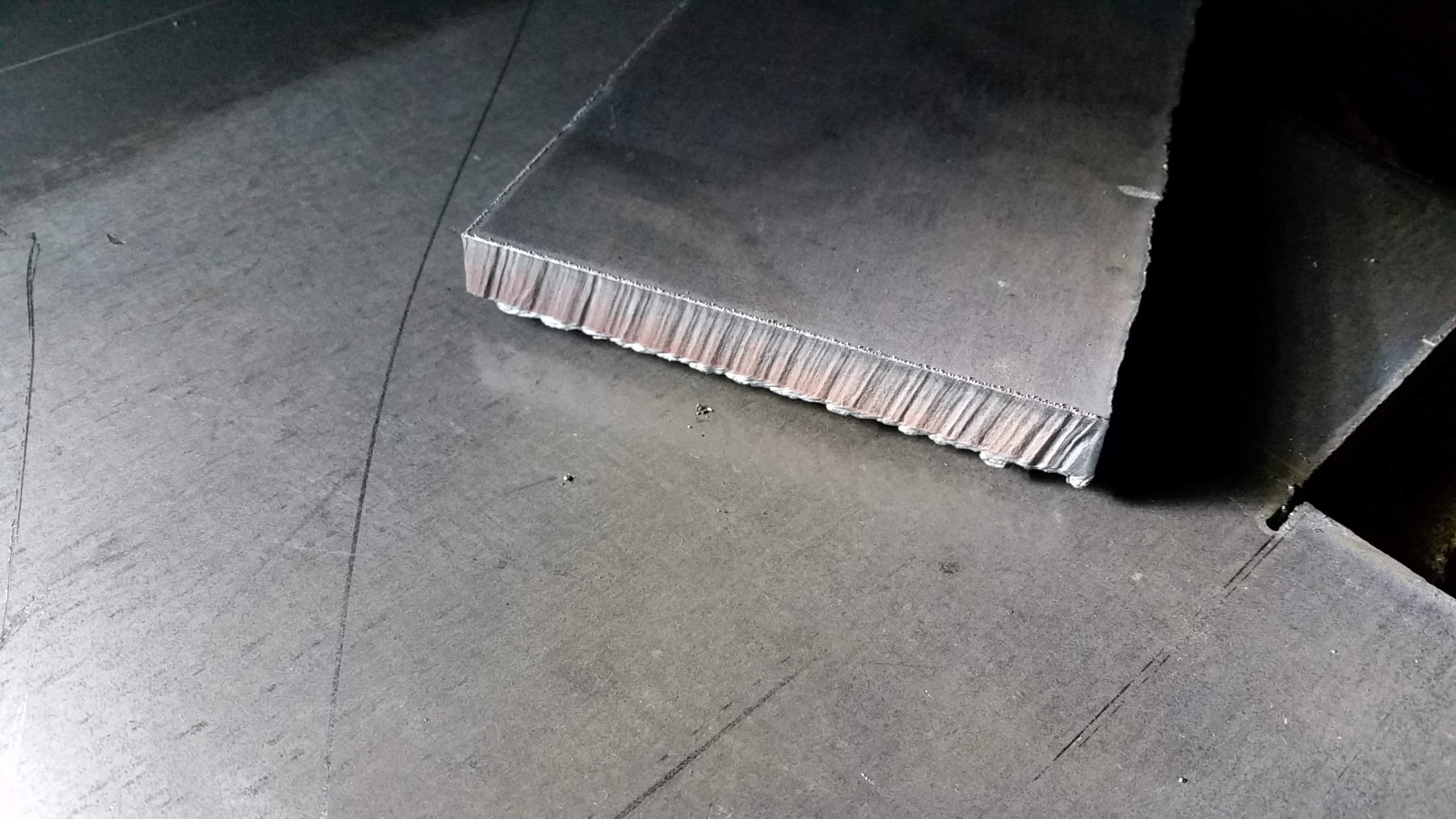

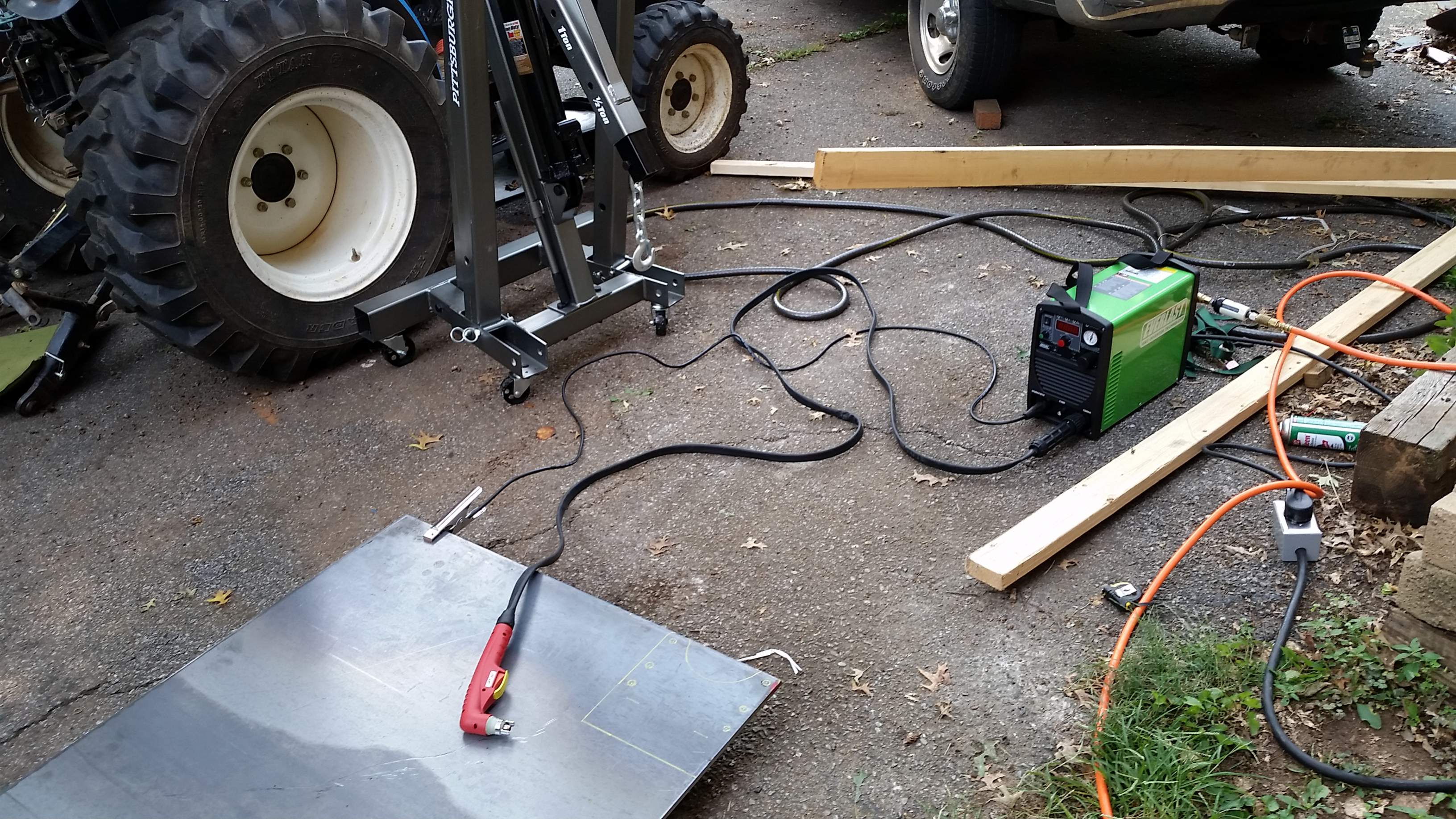

Plasma action
Dragged out the plasma cutter and cut up some 1/2" plate (A36). Started making new rear mount that goes around PTO. Also cut some 2x4 structural tube and the plates that will be used to mount the tubing.

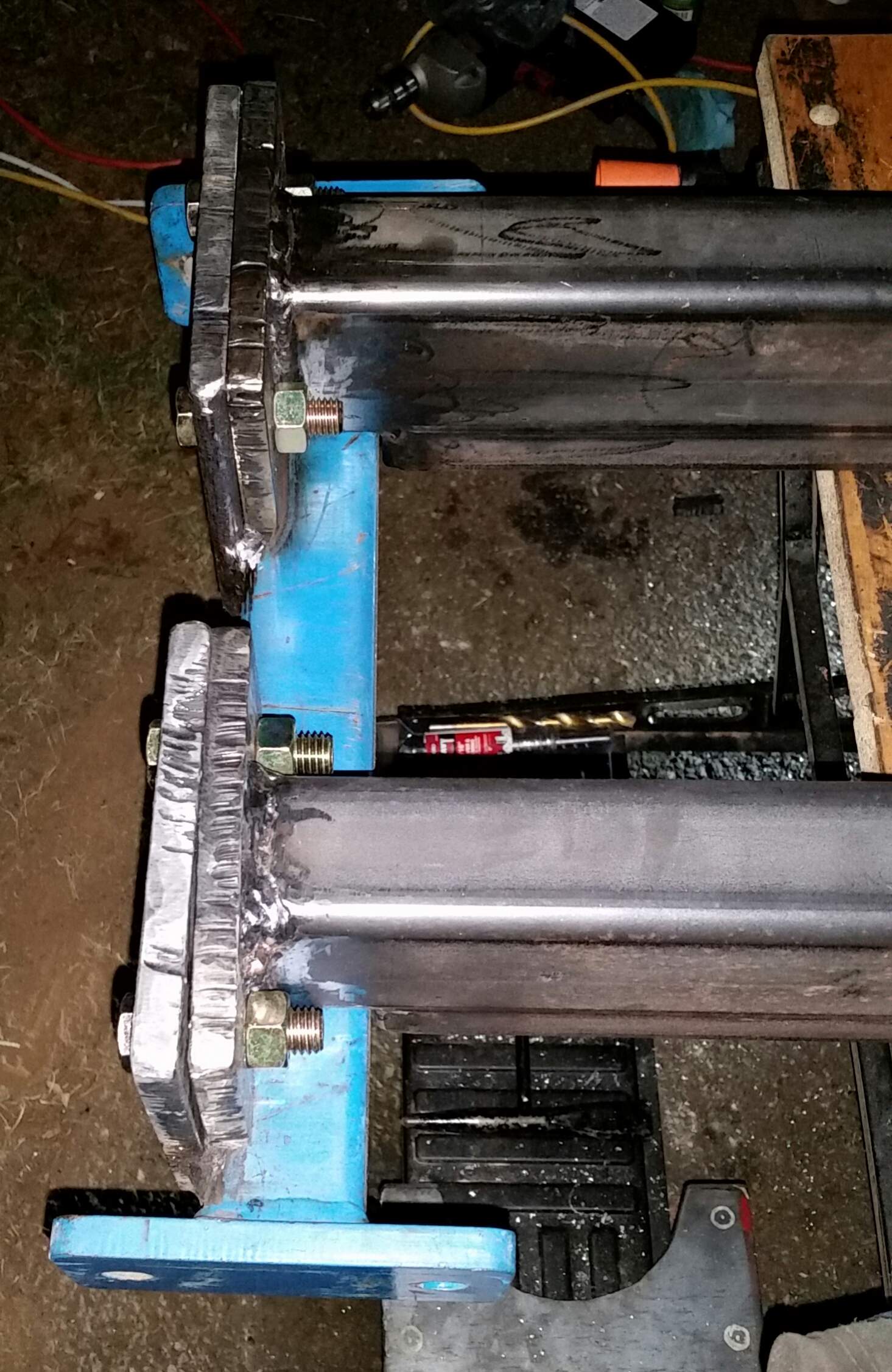

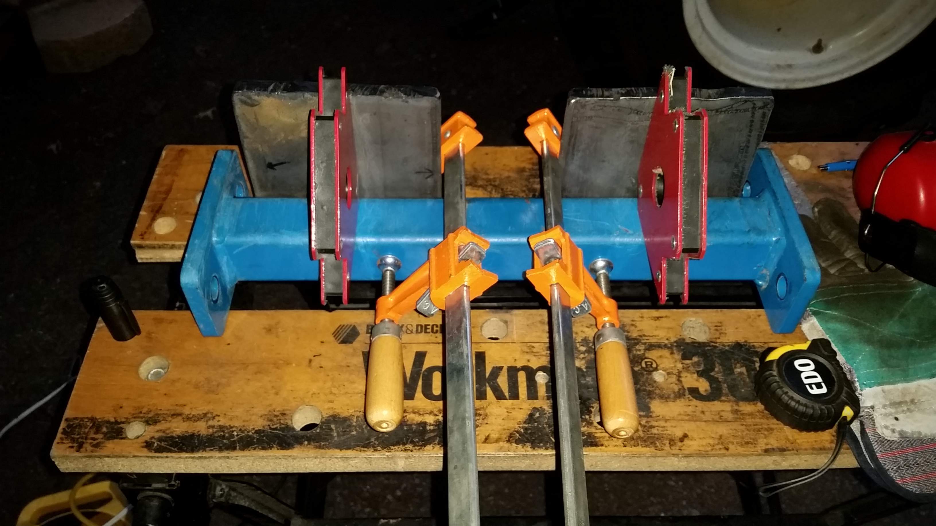

Backhoe rails tied into FEL cross member
I haven't posted a crude drawing of my hybird mount idea yet but basically the backhoe frame rails from the FEL cross member to the rear will look similar to the LS factory mount that is unobtainium but with a twist ... the portion under the tractor will be permanently mounted and support the 4 point backhoe mount on the rear of the tractor.

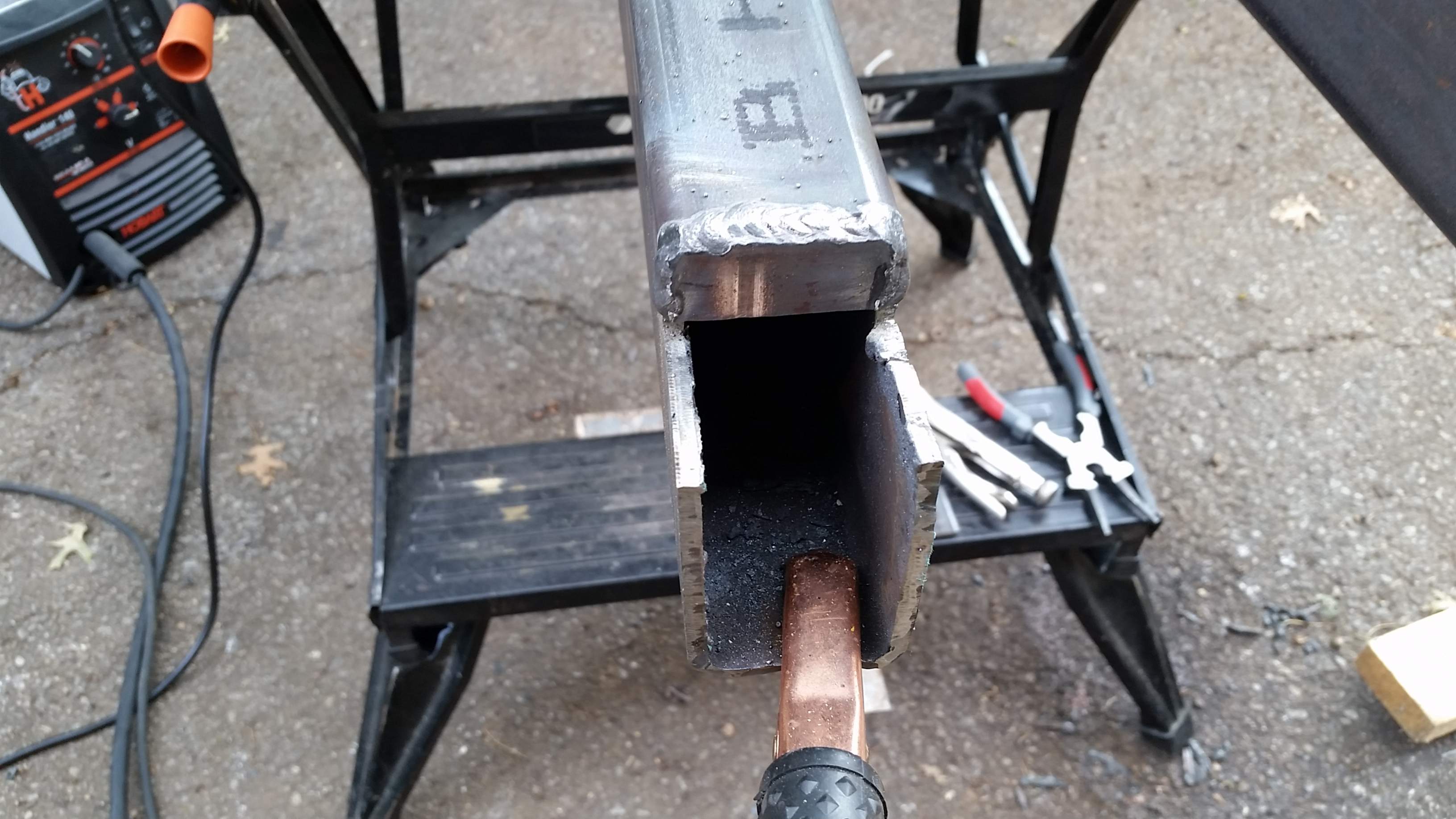

I cut a notch out of the 2x4 tube to mate with the FEL cross member that runs under the tractor between the FEL mounts. The forces from the backhoe will push up on this member and try to lift the front of the tractor spreading out the force.
Here's a picture while closing the ends with some 3/16". I used my small MIG with flux core for this since it wasn't structural ... everything else is 6011 & 7018 stick:
I welded 1/2" plate to the FEL cross member so I can fasten the rails to the FEL cross member with bolts. These 'ears' stick down about the same distance under the tractor as the FEL loader mount that connects to the ROPS/transaxle housing in the rear:
The backhoe rails in the front also have 'ears' to mate with the FEL cross member:
View of the modified FEL cross member sitting on the rails. In the side view you can see the two plates against one another. I had fun drilling bolt holes in that tonight:
Now I'm figuring out how I want to go about mounting the rails at the rear of the tractor ...
This is my first project with my plasma cutter so don't laugh too hard at my rough parts ... I've still trying to get my technique down. It's not the machine ... It's all me. When I was cutting 1/2" plate I kept tripping breakers and quickly learned 20Amps wasn't enough so I had to modify my extension cord to use the 30Amp dryer plug (which makes the wife real happy).

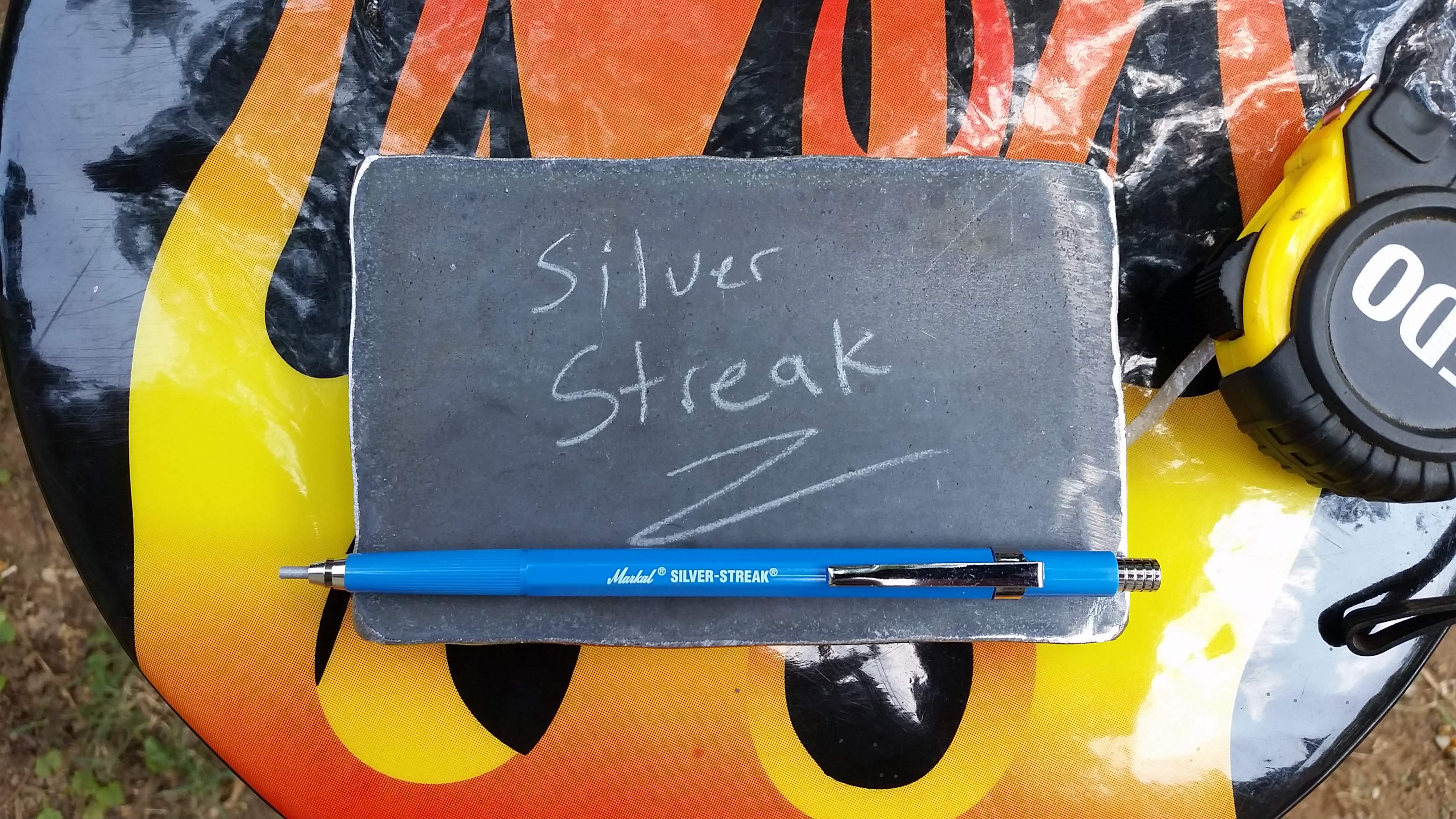

Oh yea, I'm a sucker for trying new markers so I picked up this "Silver Streak" marker. It's like a drafting pencil but with silver lead:

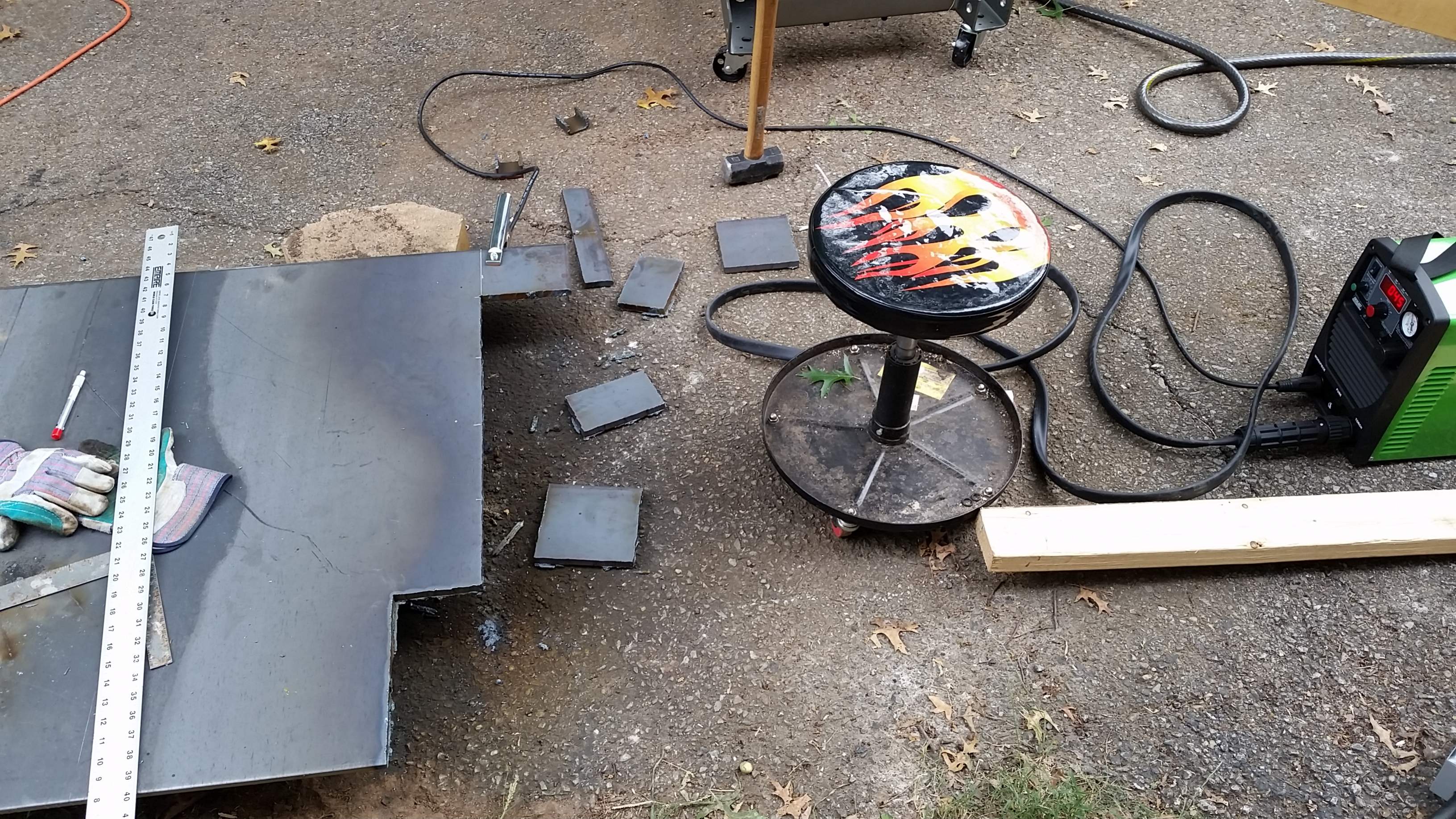

Finally finished drilling 4 9/16" holes in basically 1" (or 8 1/2" holes) plate. I like drilling holes in thick metal about as much as I like painting windows. The is the bottom view of the mount ... pics probably aren't the best because I'm always working in the dark after work.
My first session trying to cut 1/2" plate didn't go so well since I kept tripping the breaker. Never noticed the problem cutting thinner stuff. Tonight I cut some more 1/2" plate to start making the brackets to mount my backhoe subframe to the ROPS/transaxle. Using the 30A circuit from the dryer was the key. Oh, and I used a straight edge (the cut on the right is from my last session that was free hand). I was pretty pleased with how my cuts turned out tonight:
... there has been no cleanup of the dross etc., ... that's just how she fell.

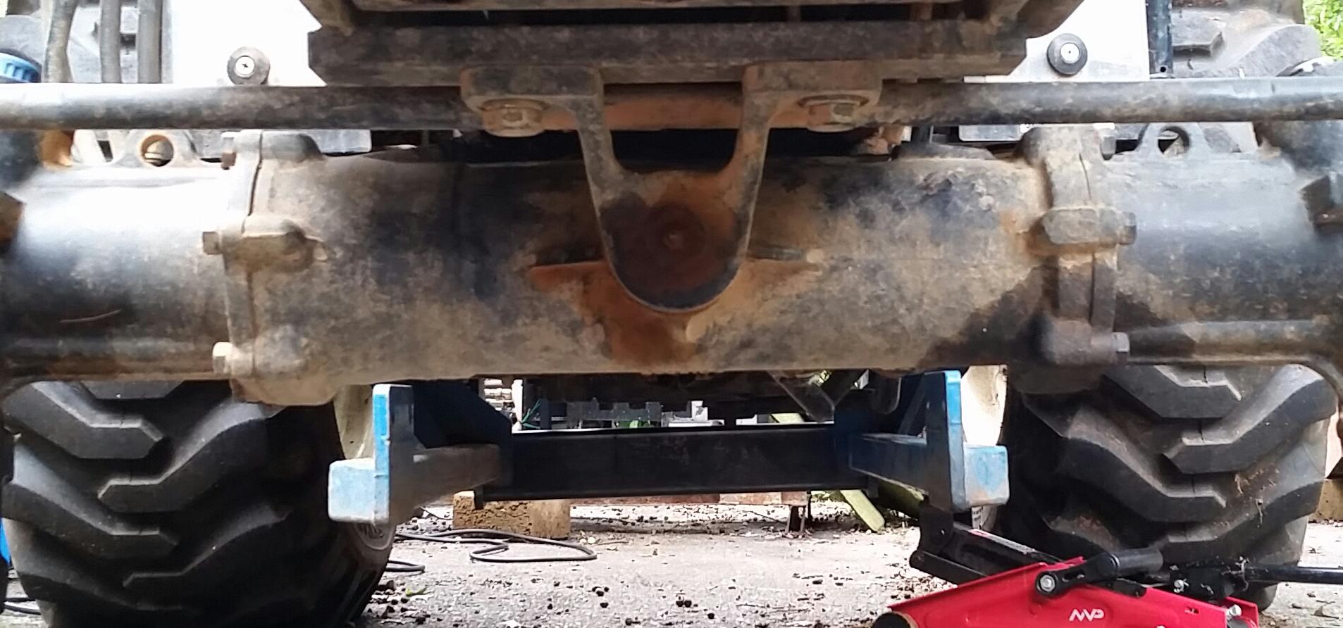

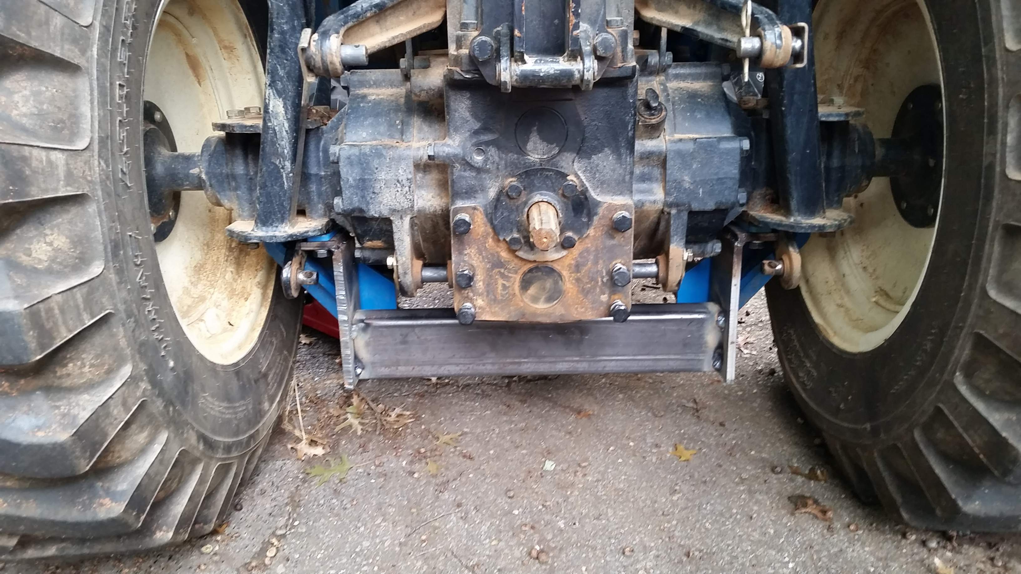

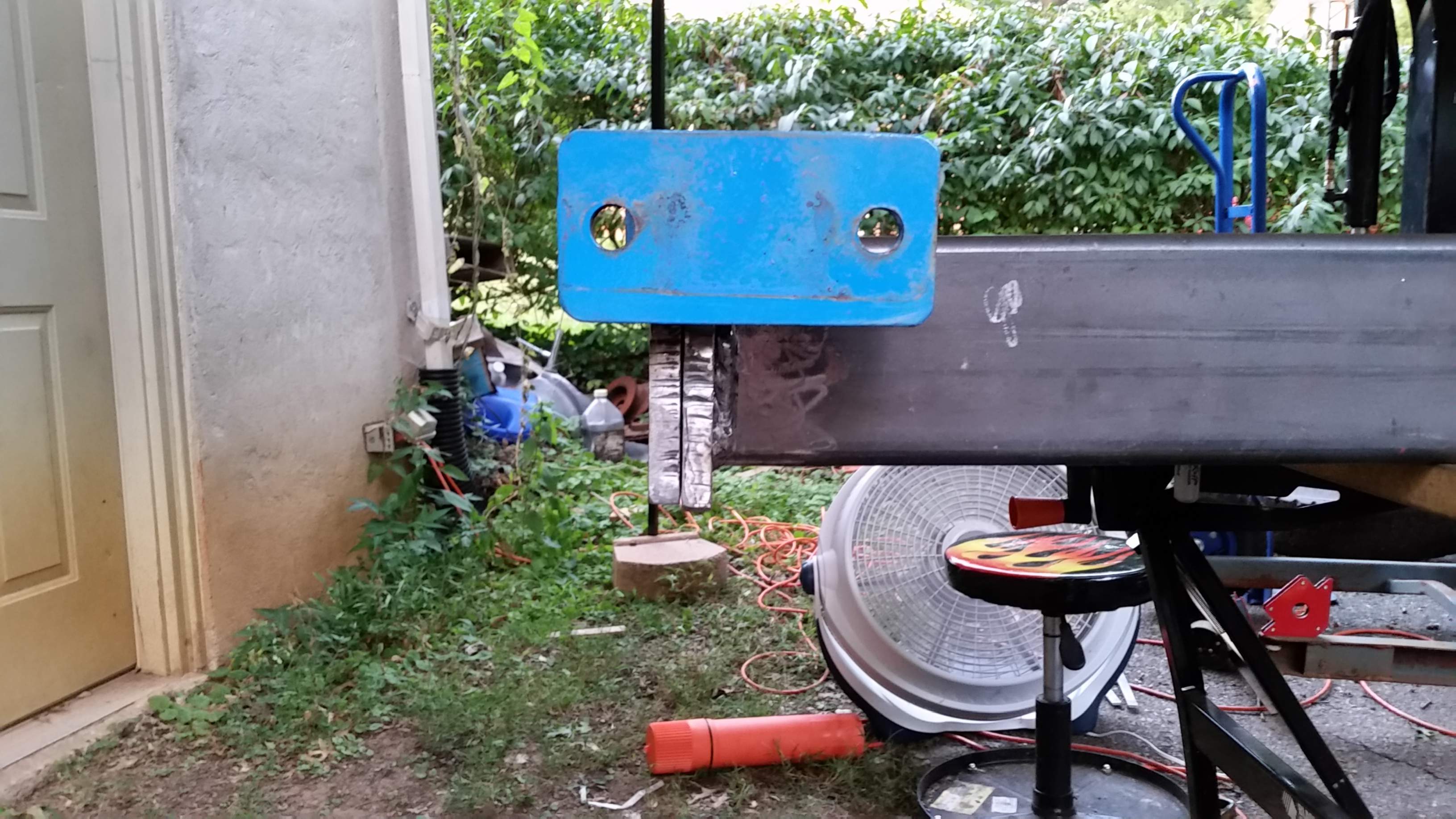

Tractor side starting to take shape
Tractor side is starting to take shape.
Tack welded a cross member between the ROPS/transaxle mounts I made after I got it squared and lined up:
If I straddled objects between the FEL rails under the tractor I gained 4-5" of travel. With the cross member I lost that ability. The backhoe subframe hangs down 1" below the lowest point (where it connects to ROPS/transaxle) of the FEL mount:
... note the front FEL cross member is removed which hangs down the same amount.
I was kind of upset about losing clearance but not much I could do about it with the materials I bought to make the frame. One good thing is now if I hit something or get hung up it is on 'my' frame and not bolts under the tractor or hydraulic lines, valve body etc.

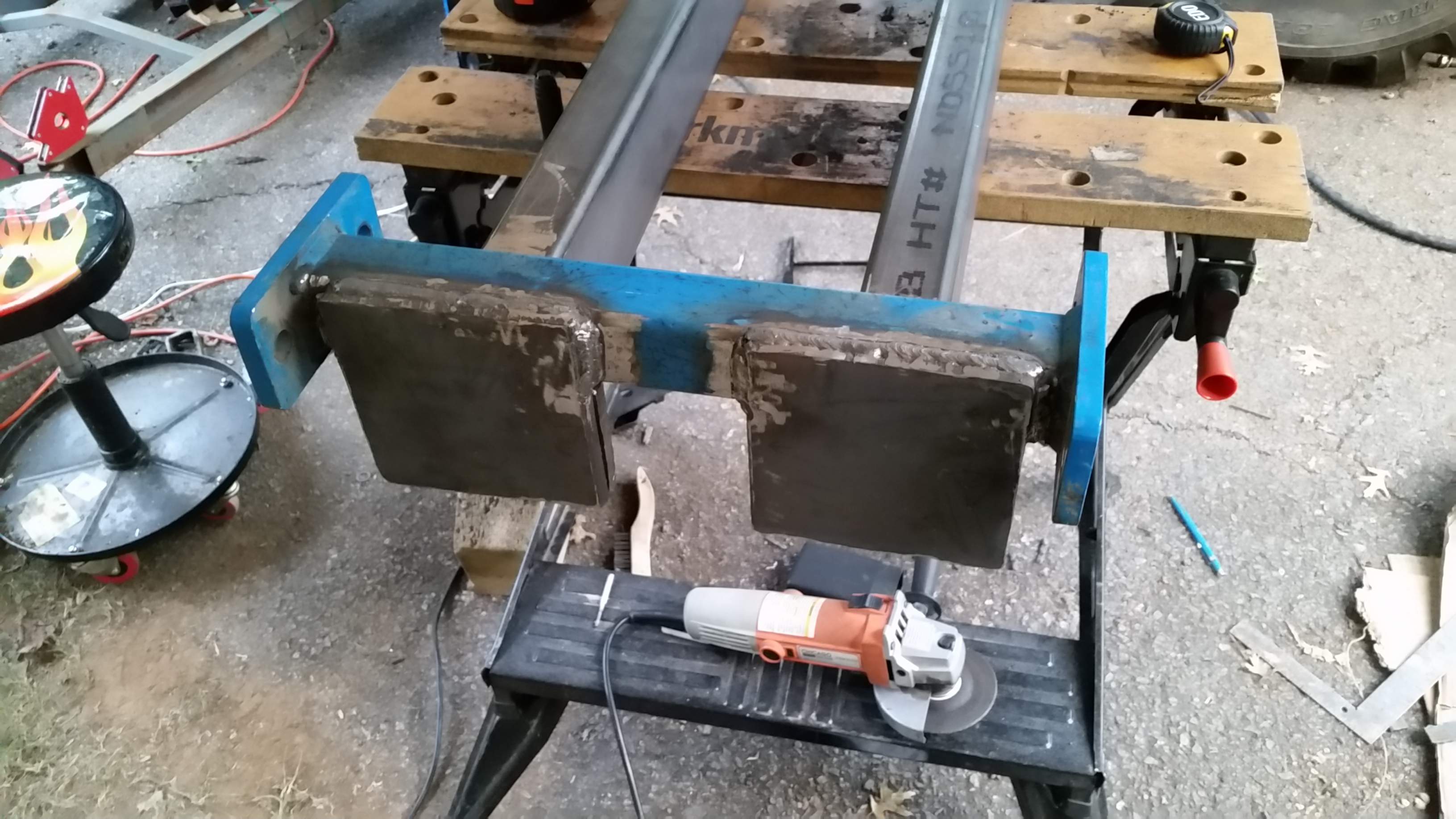

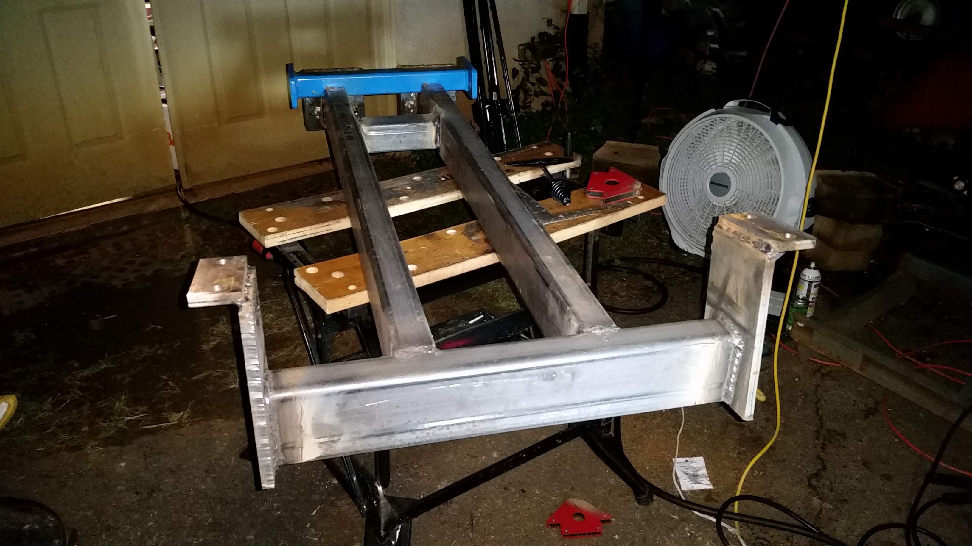

Tack welded the rest of the frame together while bolted up and then took it off and did all of the root welds. I had some gaps to fill in on ends of the tubing. I just finished a little while ago so I didn't clean it up or anything yet. Next, a few beads of 7018, make a template and cut out the 4 point cradle parts.
Here's the tractor side frame starting to take shape (right after finishing root welds):
