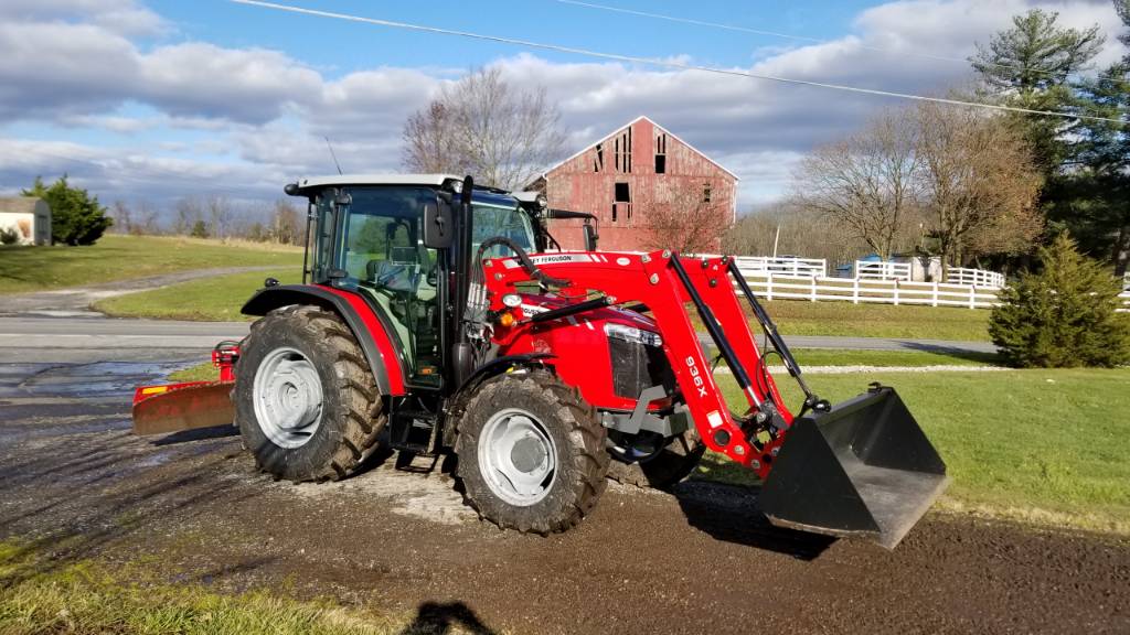

I agree with Daugen. I have a new MF4707. Fit and finish is top shelf. Air seat is as nice as a 200 hp tractor. This thing is built like a tank, weighing 10,000 plus with 936x self leveling loader. It's a global tractor: Norwegian tires, Finnish engine, Italian transmission, US built loader and front axle, French designed cab, and final assembled in China at an AGCO owned and managed plant. I am extremely happy with the design, value, and build quality. It's as nice as tractors costing $25k more in every way. 20181203_140504.jpeg
