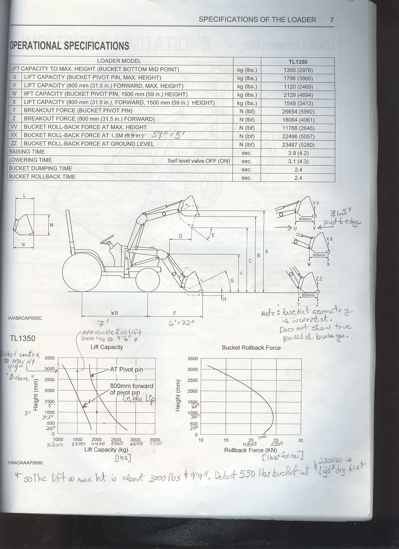

OP was originally concerned about loader capacity, some loaders you can sacrifice reach of loader and pick up more down low, two different mounting points for loader. But I hear the OP, when I bought my L Kubota I was immediately disappointed in its FEL lift capability and thought to myself, should have bought an M. If I had I still might have it...
I personally don't have a lot of faith in those loader ratings. Turns out my loader is a Quicke apparently and have second means of
confirming ratings. It handles my Long grapple just fine, about twice as fast as prior loader.
You sure don't want a super strong loader on a moderate weight tractor without lots of counterbalance though...

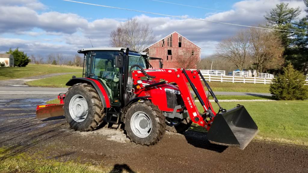

I agree with Daugen. I have a new MF4707. Fit and finish is top shelf. Air seat is as nice as a 200 hp tractor. This thing is built like a tank, weighing 10,000 plus with 936x self leveling loader. It's a global tractor: Norwegian tires, Finnish engine, Italian transmission, US built loader and front axle, French designed cab, and final assembled in China at an AGCO owned and managed plant. I am extremely happy with the design, value, and build quality. It's as nice as tractors costing $25k more in every way. 20181203_140504.jpeg
