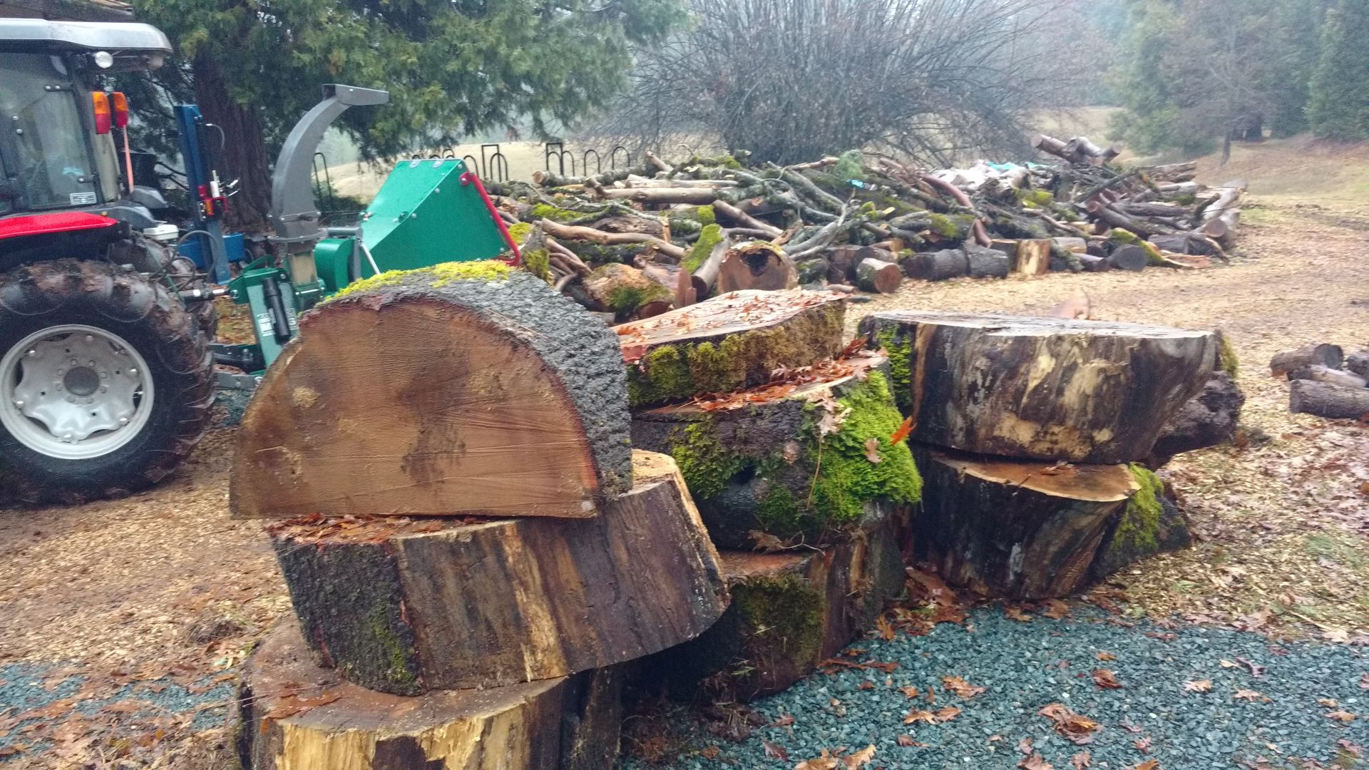

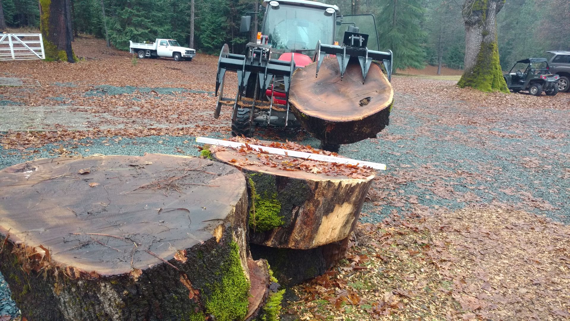

I was out moving black oak rounds today and thought I'd post a picture. Getting everything in one place to start splitting next week.
Don't know how much the rounds weigh but I know they are quite heavy plus a bit more since they have been sitting in the rain lately. The level in the picture is 4 foot. btw I started with a Massey GC1710 SCUT. Then added the 1758.
