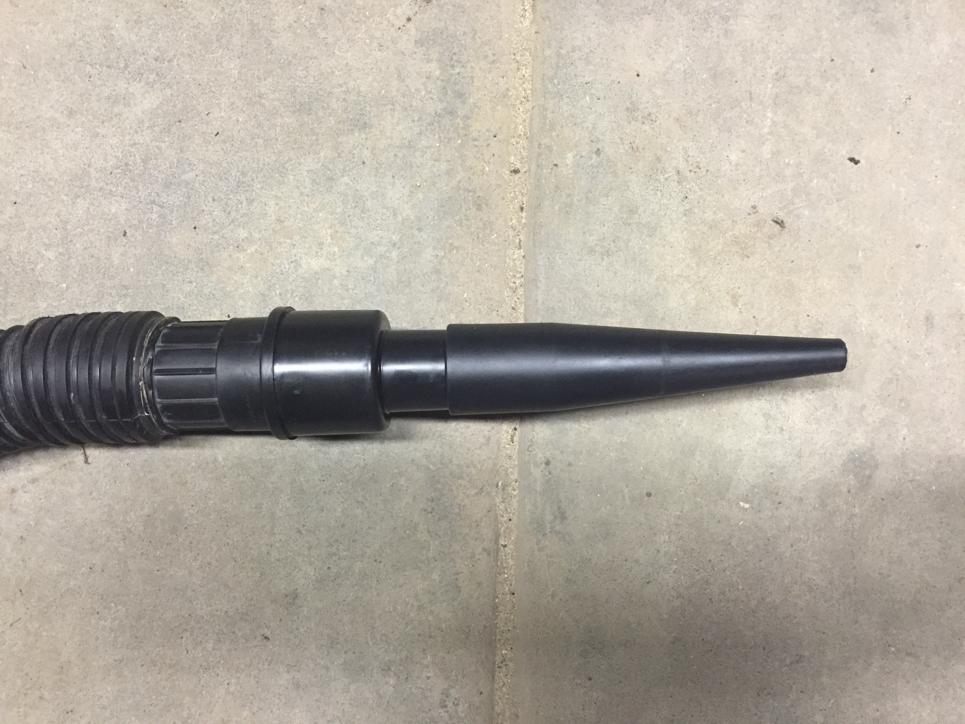

Just wanted to let everyone know how great the shop-vac works when changing the hydraulic filter.
I did it today and the only oil I lost was what was in the filter. The last time I did it I lost a gallon and had a big mess.
I bought a cone shaped adapter and put it in the fill hole. What a great method, kudos to whoever thought of this trick.....thank-you, thank-you, thank-you!!!:thumbsup:
