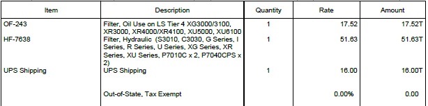

I just completed the 50 hr service on my LS XR4150. Here are the filters I used. Purchased from RCO tractor in Austin, TX
Apparently you can use the same filters from the 4000 series according to their description.

A little update on realhunters post since RCO doesn't put the actual filter numbers on their invoice. They substitute baldwin filters for everything the y can. I have a 2016 LS XR4150HC so here is the list I have of filters which also includes the HST filter:
Hydraulic filter: Baldwin bt839-10 or wix 51551MP
Oil filter: Baldwin B243 or wix 51516 or 51516XP
HST Filter: No Baldwin match, Wix 51715
