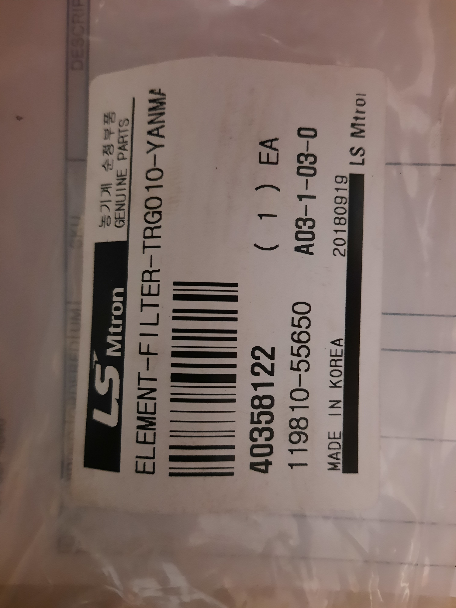

I have the 25HP Yanmar motor model # 3TNV80F-ZK and trying to find a fuel filter for it. Can't cross reference the numbers TRGO 10 Yanmar or 40358122

What does the filter look like?
That engine is used in other tractors, like John Deere for example. Get their part number and find the cross reference.
   / LS Tractor Oil, Gas, & Air Filter Information #363
Long & round. I finally found them.

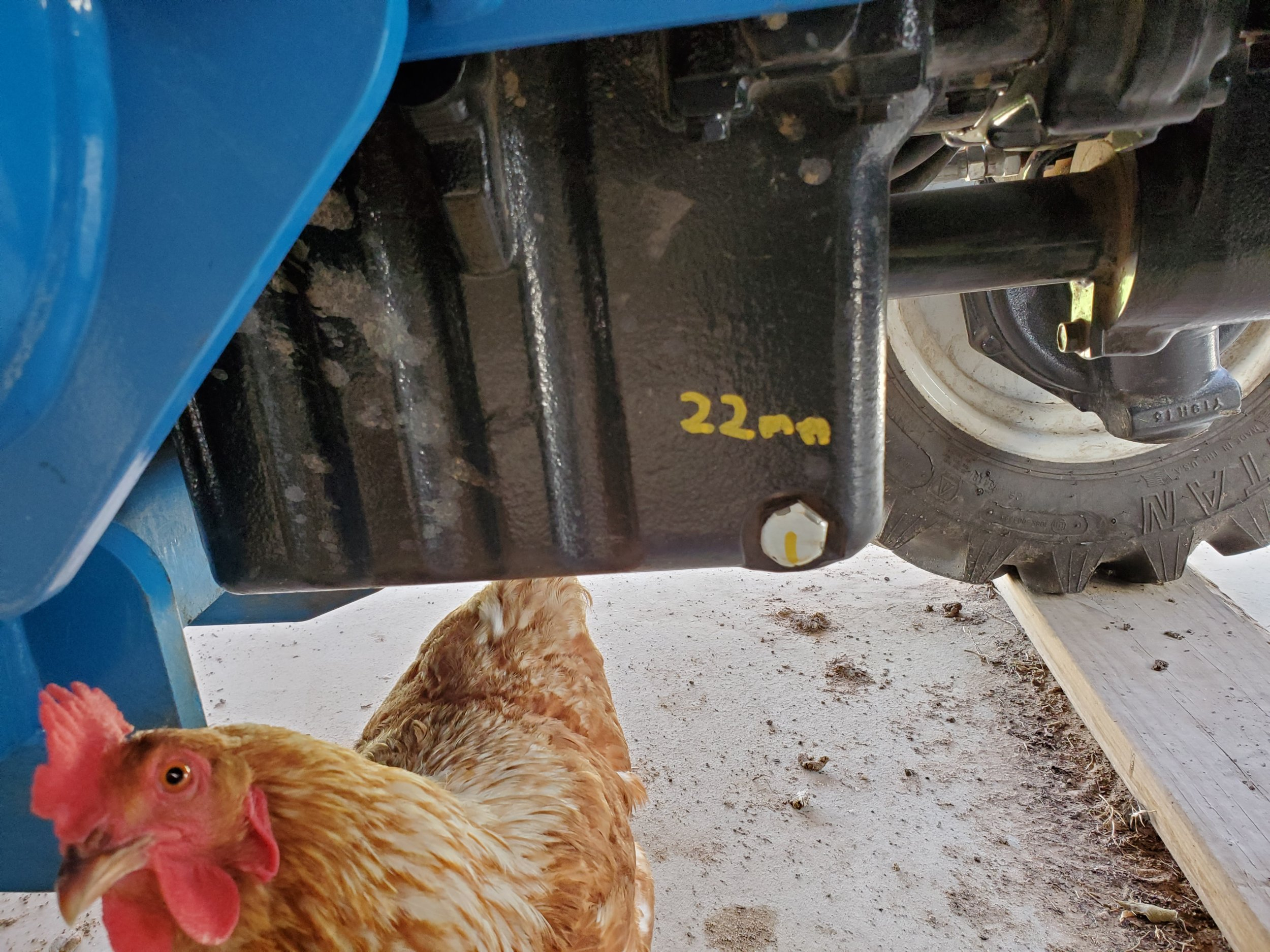

Hello, I own a LS MT345E and I am coming up on 300 hours and will need to change the transmission/ hydraulic oil.
I see that this tractor takes metric wrenches and sockets. I do not have large metric sockets and I see that the head of the bolt on the reservoir pan is large. Does anyone know what size socket it will take? Thanks in advance for any help. Cal

Well my MT240 takes a 22mm.
They may be the same size.
I can never remember the size when it comes time to do maintenance so I mark a lot of them like this.

Hi, thanks for the reply. My oil pan takes a 22MM but the hydraulic oil is much larger. It is just a bit smaller that 1 1/4 socket.

DOH! sorry, yes, you did say hydraulic/transmission fluid. My mind went else where once I got to the tractor. I'll go see if I can size it. :)

Well I'm not sure. It's larger than my 27mm socket and 1-1/8" but like you say, smaller than a 1-1/4" so a 1-3/16" might work so a 29mm or 30mm should be the correct size. I may just use my 15" adjustable wrench when the time comes.

Yes I think You are correct. I found a 32MM and it is a little large like the 1 1/4. I think it would be a 30MM. Thanks very much for your help and info. Cal
