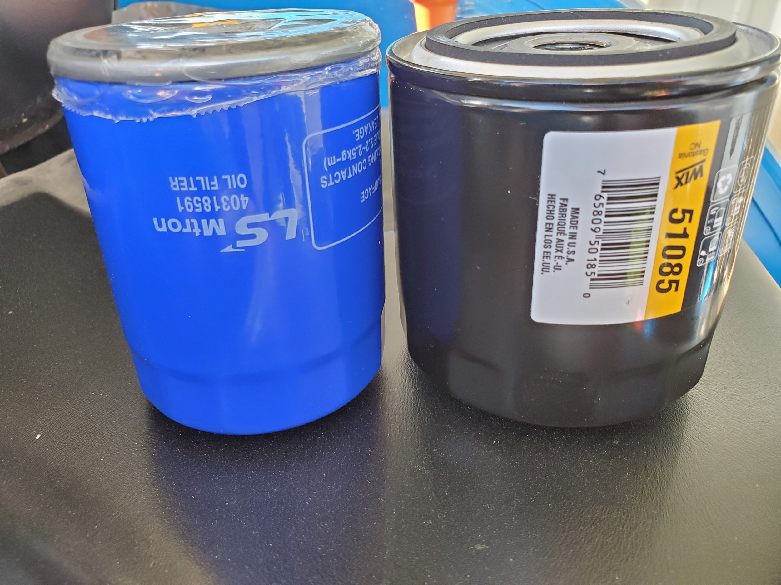

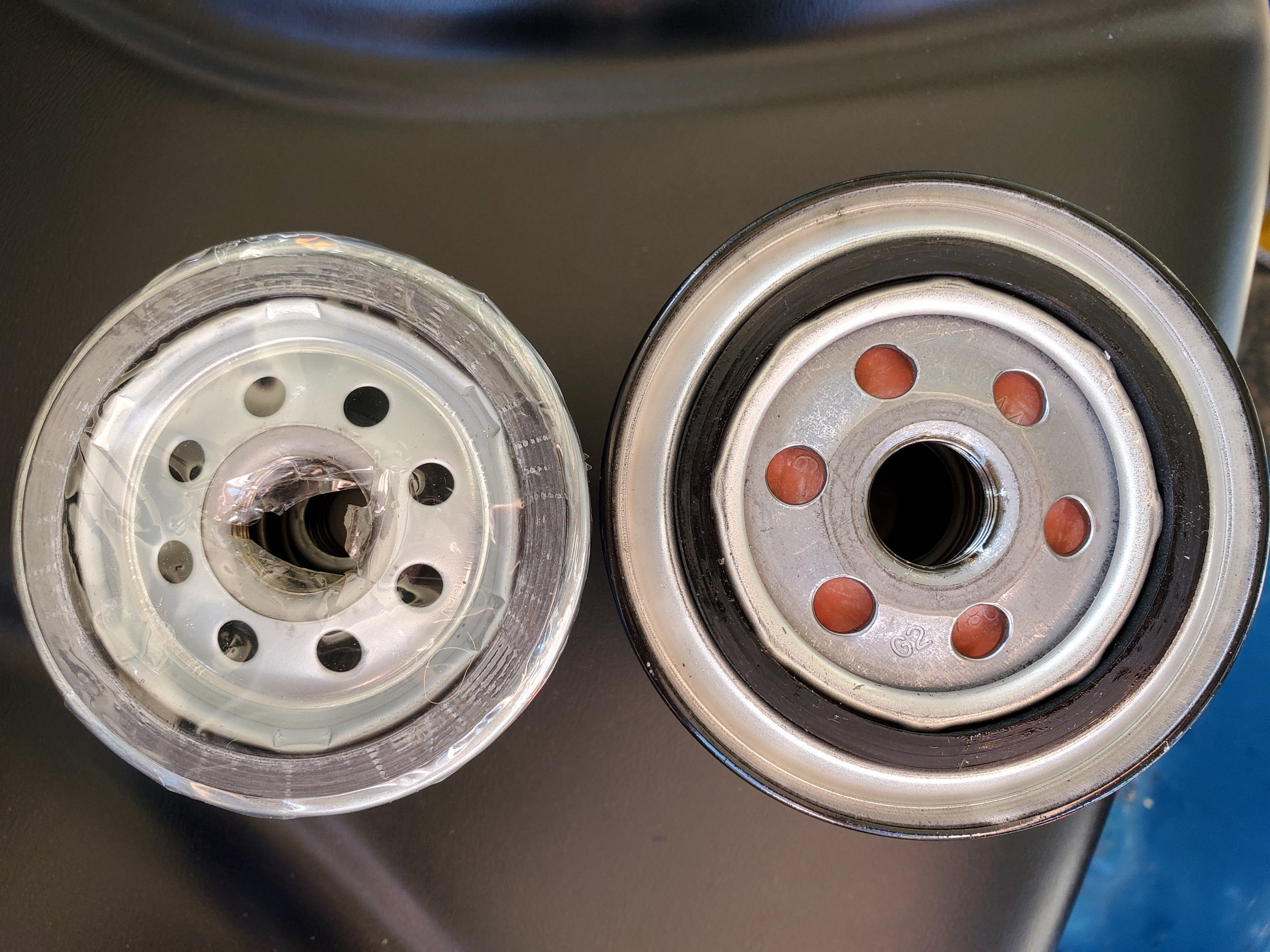

I tried a Wix 51085 and it seems to work on my MT240HE. I threaded it on and off a few times and compared it to the LS one and it feels exactly the same as far as threads go. The Seal is the same diameter. It looks like it may have a little more filter media as it's larger in diameter. I did run the engine a few minutes after replacement and filling with oil and no leaks but that was only at idle.

the filters look similar but what worries me is the bypass valve setting the same or does it even matter.this is why i use a factory filter on my 4155
The reason for the bypass circuit is in case the filter plugs up (or oil is really cold and can't flow through filter normally) there is a bypass circuit in the filter so the engine is not starved of oil. Not all engines run the same oil pressure and the filter is generally chosen with this mind. If you have a normally higher pressure system and put a filter on that has a low bypass spring rate you will continually bypass some of the oil around the filter media. Vice versa, if you have an engine with a lower engine output pressure and put a filter on it that has a higher than spec'd out bypass spring you could run into oil starvation issues if the filter does plug or the oil is very cold. Not sure how the WIX filter compares to the LS filter in this regard. Is there some document stating they are replaceable with each other? Looks like the WIX is intended for gasoline automotive engines. It may fit the connection to the block but not the engine application. Then again, it may work just fine.
