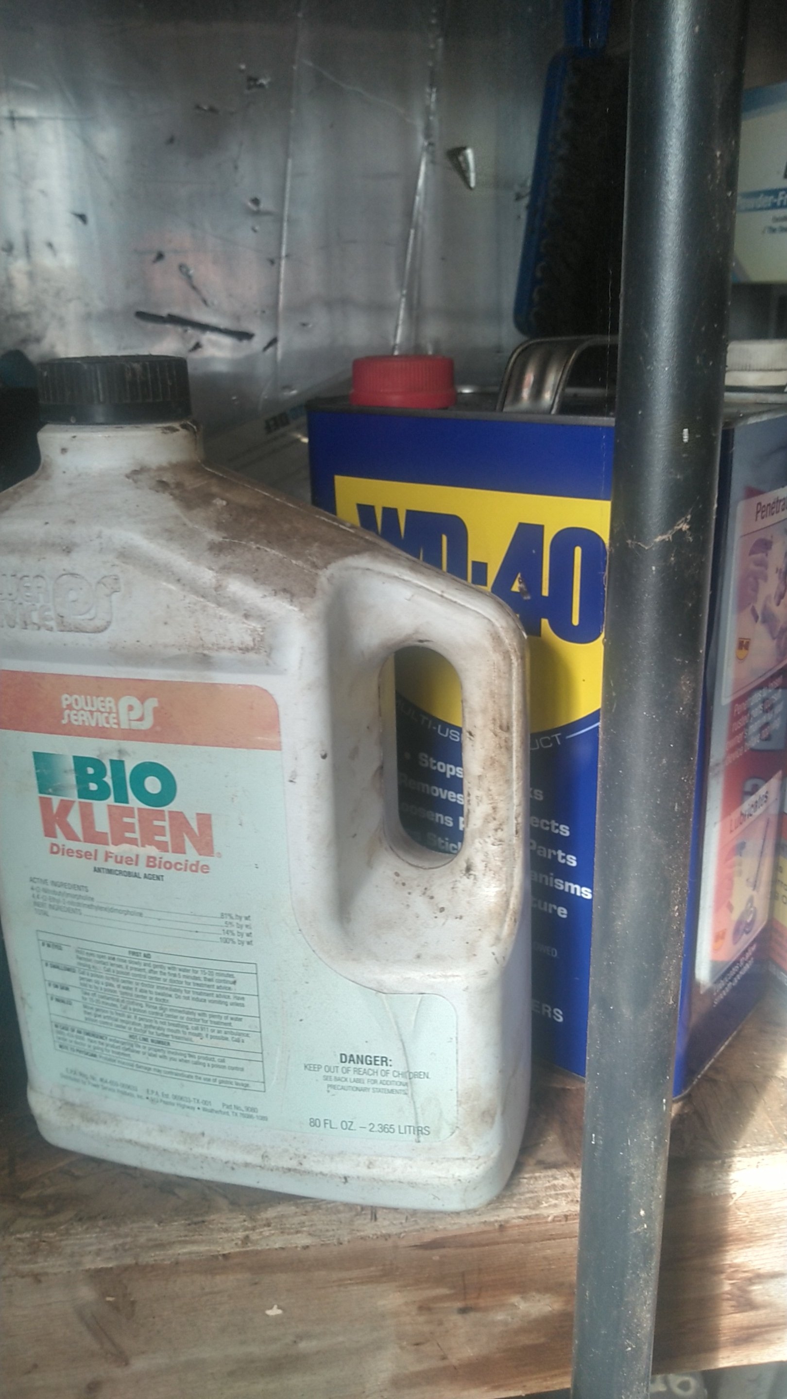

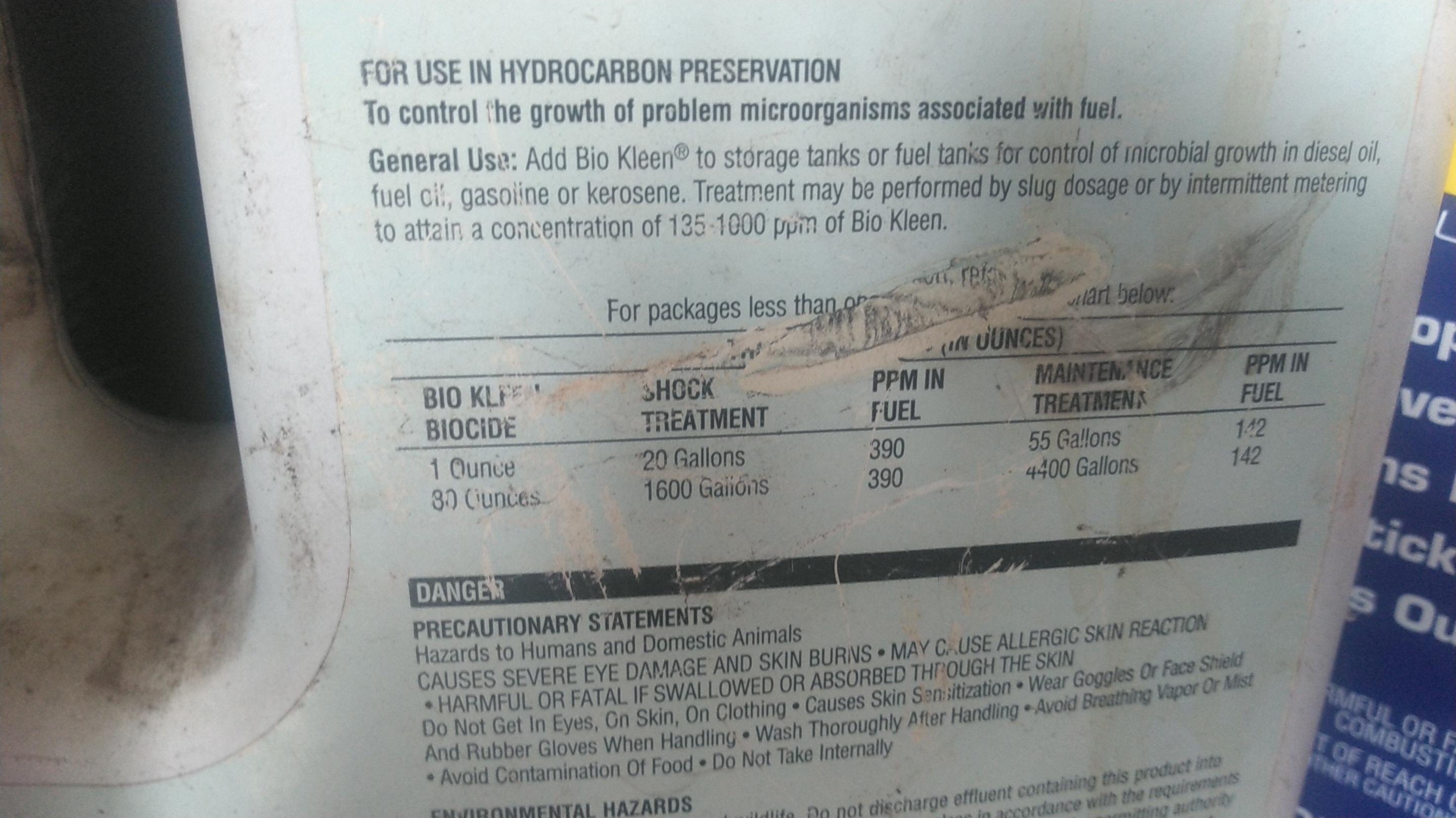

On top of marvel I usually put some biocide in diesel that won't be used frequently.
I’ve been having problems with algae/microbes in my tank. What kind of bio side do you use?
   / Lubrication additives for Diesel Fuel in older tractor #90
Bio kleen made by power service I believe if I get to my shop I'll post a pic on this response.
