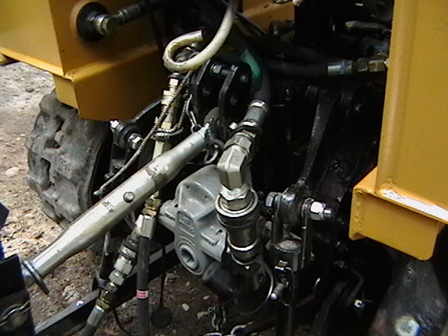

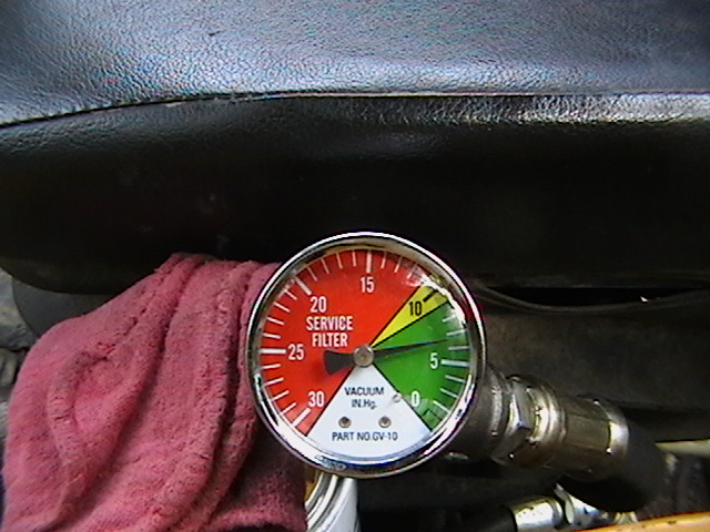

... I removed the stock suction banjo fitting on the tank and had a welder enlarge it and weld in a 90 degree 1.25 inch elbow, put a 25 gpm filter inline with a vaccume gauge that reads zero when normal running and one at stone cold.
No growling from pump
reservoar is not too low, about an inch from the top of tank, less as this went on.
I am not sure how I can do this, please explain, look in the tank with a mirror while running only one function?
I have to write more to get this to post, I have a pressure gauge on the 3/4 hose I put on the pump, it sticks at 2,200lbs
I can look through the fill hole of our oil reservoar and see the return oil stream above the oil surface. A growling pump causes disturbance in this stream and bubbles occurs.
Your pressure seems OK though, the PRV is working. But a bit surprising, still hearing no growling and you get this foaming?
Remove the filter from the suction line
But, it seems we have a somewhat different setup; I have a tank return filter, while you have a suction filter.
(See my illustrative sketch, however with some text in swedish.)
However, there is a suction line strainer (mesh filter in a plastic housing) in our hydraulic reservoar. I've checked/replaced it once, after a long season of digging, and it still was in mint conditions.
My recommendation therefore is simply to remove your suction line spin-on filter & holder, since I think it's causing more pain than gain. If you're going to add any filtering at all, do that on the return line only.

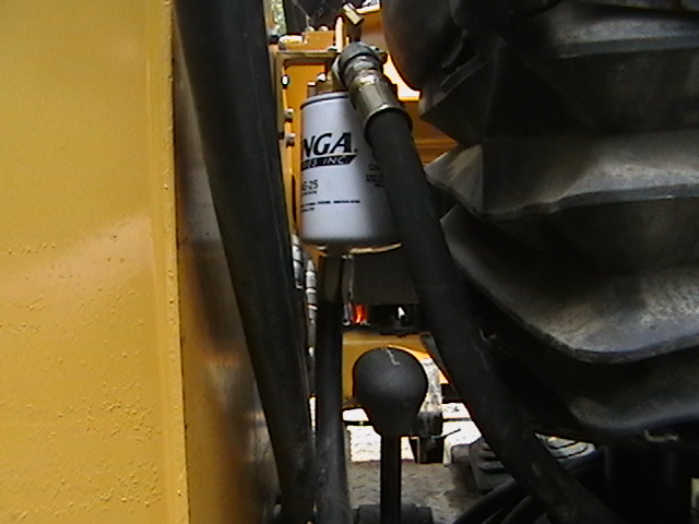

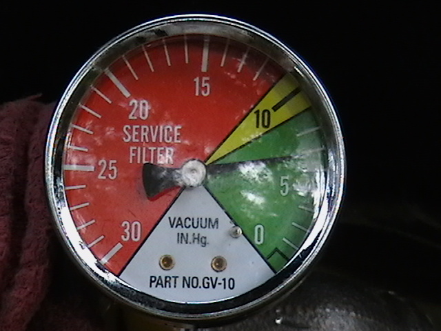

OK you guys, a very simple test is in order to validate my point.
John, if you will install a simple vacuum gauge on the outlet side of your suction filter (between the filter and the pump), you will know in an instant if your pump is starving/cavitating.
I had an identical setup on my dozer with the Prince pump and a LW-6 backhoe (which I replaced with a LiTW BH7600 backhoe and still use the same suction side setup). See pics. (Engine speed was ~1,200 r/m with ~ 50 degree F cold AW ISO 32/46/68 multi-grade hydraulic oil.) It should also be noted that I'm using a 25 micron suction filter that has a 25 gpm rating - on a 7 gpm pump that's only putting out ~5.5 gpm. I'm also a big fan of Machinery Lubrication, plus Facilities Engineering, etc. In Brendan Casey's article he demonstrated extreme worst case scenarios, and never once concluded that suction side filtering was a bad thing. The article is seven years old, and I believe there have been several SAE white papers on the subject since.

What filter are you using?
New ZINGA. Spin-on type element. Ports 1 1/4" NPT.
SPECIFICATIONS
■Suction Line Applications 25 Micron
■25 GPM
■5 PSI bypass
■950 sq in filter area
■5 1/3" dia x 9 1/3" long
Prince calls for a suction filter for their pumps
