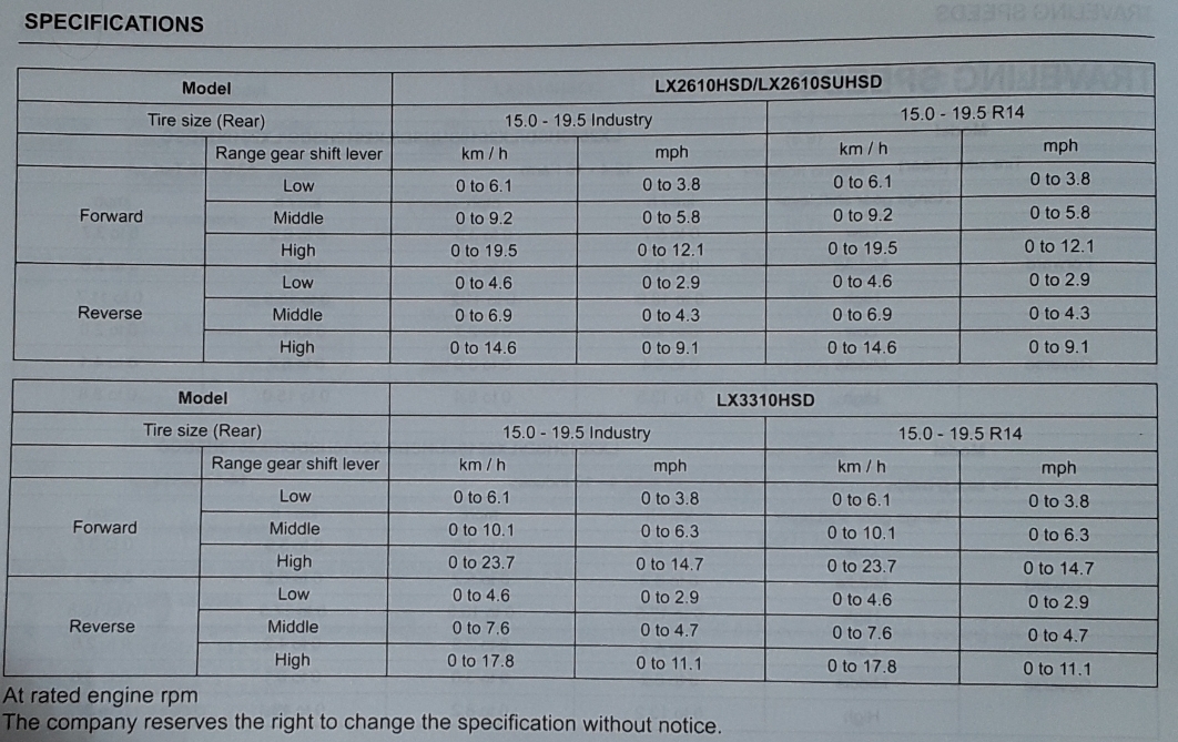

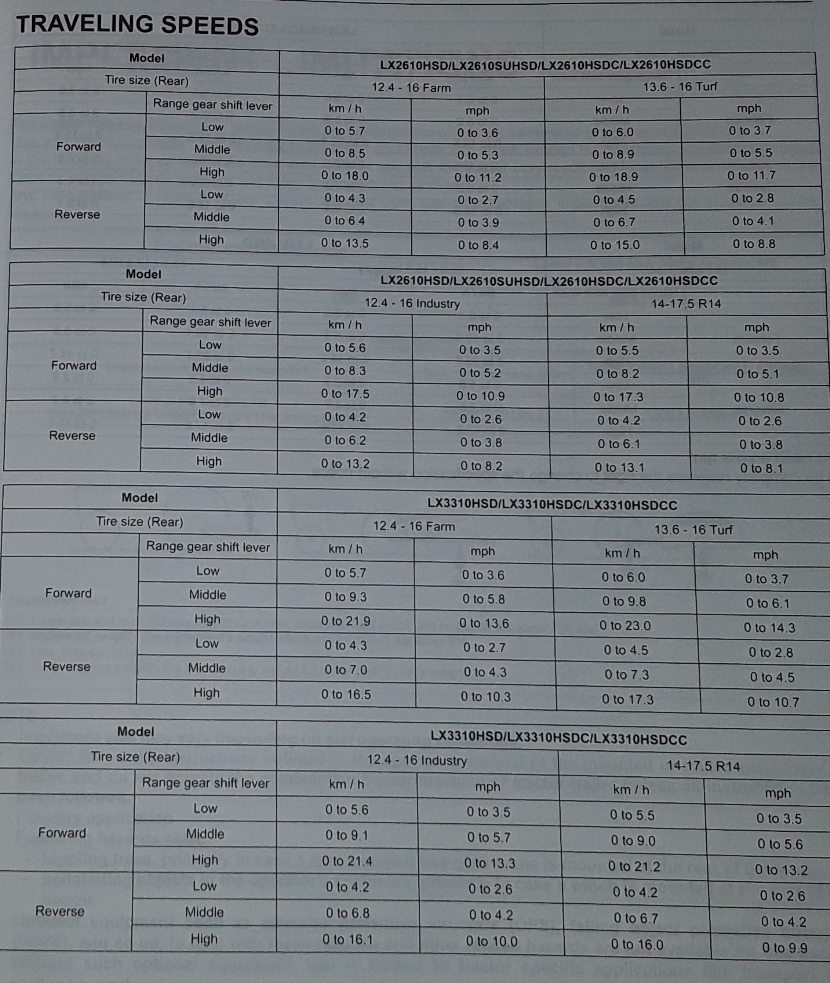

Do they modify the gearing with the larger tires on the LX models? With the B2650/3350 models they did not change the gearing with the larger tire option, and it resulted in a notable reduction in torque at the wheels (Kubota was upfront about this if you talked to the right person). That is the opposite direction I would want to go in with a tractor if it's used for pulling or pushing, or in a hilly area. I seem to recall someone here on the forum went with larger wheels on a Bxx50 model and had issues mowing on hills, not enough guts. I would be sticking with the standard size wheels and tires if it were me.
They do not, and the over sized tires increase ground speed significantly. If loaded, weight is also significantly increased.

Increase ground speed ...significantly...? If his post is accurate and the L-sized tires are 7.5% taller than the standard tires, the LX3310s top speed goes from 13.6 mph to 14.6 mph, 1 mile per hour. A few PSI in the tires could move that number in either direction....

I believe Kubota has a typo on their speed specs (among other things they don't show the SU model to be faster and it should be). I recall they had this typo on the B50 specs too. The owner's manual should have the correct numbers if it uses metric units (means the numbers are coming out of the engineers in Japan). If they have been converted to US units then they may have typos too, since the US folks would have messed them up.

I only draw the comparison to the two machines as the standard rear tire on the L is the optional tire on the LX, both run at the same RPM range, have virtually the same gearing, and both have virtually the same speed specs. My LX3310 TLB weighs the same (or 200 more) than a L3301 TL. Those are both factory optioned configs, and we can absolutely compare gearing between those 2 examples and the inflated road force does not come into play in that example.
Kutoba doesn't re-gear these tractors when they offer an optional size tire on this model, or when they hang an 1100lb backhoe on them. Kubota is comfortable with both tractor's performance specs irrespective of how they're optioned (weight, taller tires, etc.).
The difference between the standard tire and the optional tire size on a LX appears to be approximately 7%, so unless the tractor was operating on the ragged edge of some performance need in motion, that small difference would likely never be noticed, and for ...my.... application I gladly traded it for the significant increase in stability and traction with the larger tires. But this is my tractor for my needs, YMMV .

I believe Kubota has a typo on their speed specs (among other things they don't show the SU model to be faster and it should be). .
Or that more bare-bones model could actually be geared lower. IDK But you're right, the speed specs on the SU are lower..
