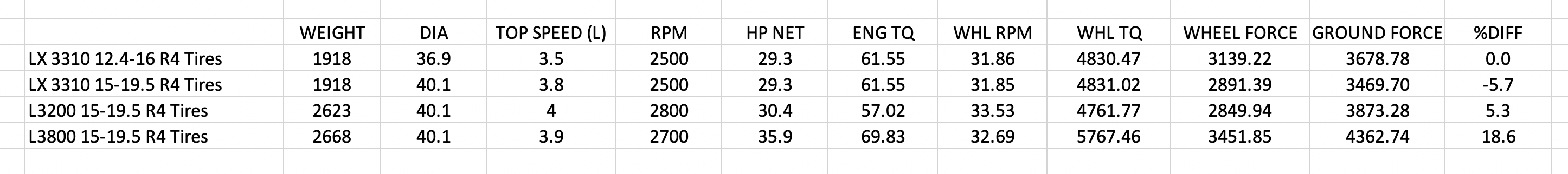

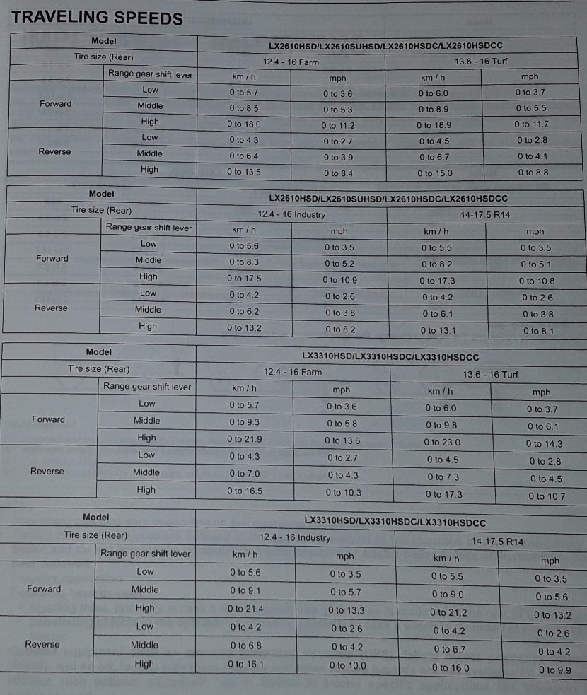

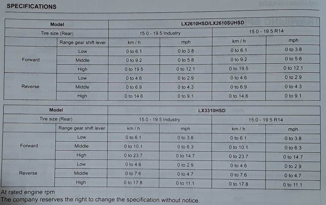

LX series travel speeds and tire options
Thanks for posting these. So knowing the correct speeds, it's more like a 7.9% reduction in wheel force and 5.7% reduction in ground force with the larger tires. That is not so bad, but seems like a step in the wrong direction to only gain 1.5" ground clearance.
Nominal side-slope stability will be reduced with the larger tires, all else equal, since the tractor is moving up 1.5" but the tire center stays in nearly the same place (for apples to apples I assume spacers or no-spacers on both options). Or interpret that to mean you should really add spacers to the larger tire setup in order to offset the loss in stability from the height increase.
Where the big tires may help is flotation on soft ground, since the big tires will have a larger contact patch. Of course if they are fluid filled then you need to take that into account as well, since it will again push you in the wrong direction.
I guess I had a hard time seeing a favorable impact with the large tires on the B50 series and can say the same with the LX. I think at best there is a mixed benefit. Normally with tractor upgrades we see compelling benefits and that does not jump out at me here.
I included a screenshot of my spreadsheet, revised from the B3350 to LX3310 with tire options. It has the older L models for comparison (the newer L3301/L3901 are close but slightly heavier and slightly more power). I assume Titan-brand tires on all of them (only feeds into the diameter spec).

The overall tire width (outside edge to outside edge) increases with the 19.5" rear tires which increases stability at a given height. That would be offset to some degree by the higher center of gravity due to the taller 19.5' tire option.
Not sure why moving to the 'Kubota-approved and sold' optional sized tires is the 'wrong direction', that would suggest that putting on short BX25D tires is the 'right direction'. Everyone has different needs, there is no wrong answer here, they are all approved configurations. For me, in addition to the R4 19.5s, I'm adding wheel spacers, just because.... ;)
666385d1597593158-lx-series-oversized-tires-screen-shot-2020-08-16-a
It's not all about ground clearance, for me the upsize tires would help with flotation but also help with obstacles due to the larger diameter. The added ballast can be a bonus.
If the tractor only had a 2 range I could see it being a problem but the Kubota has a pretty decent low range.
If I lived on a mountain I probably wouldn't be looking at taller tires though.
