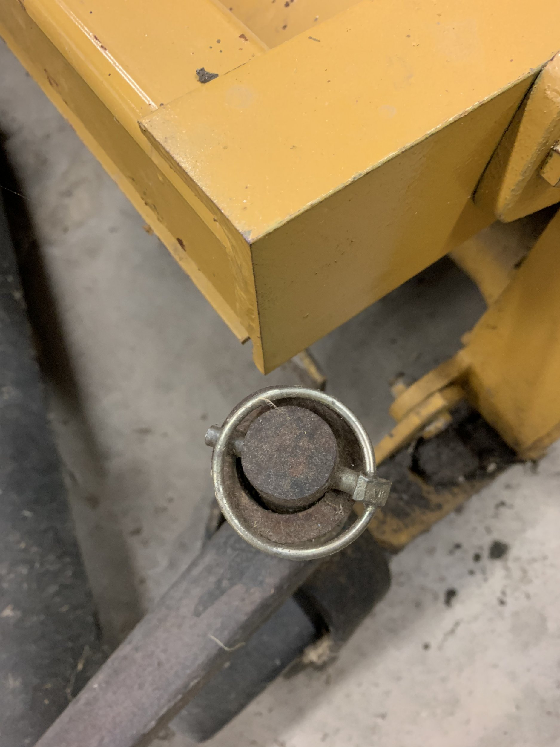

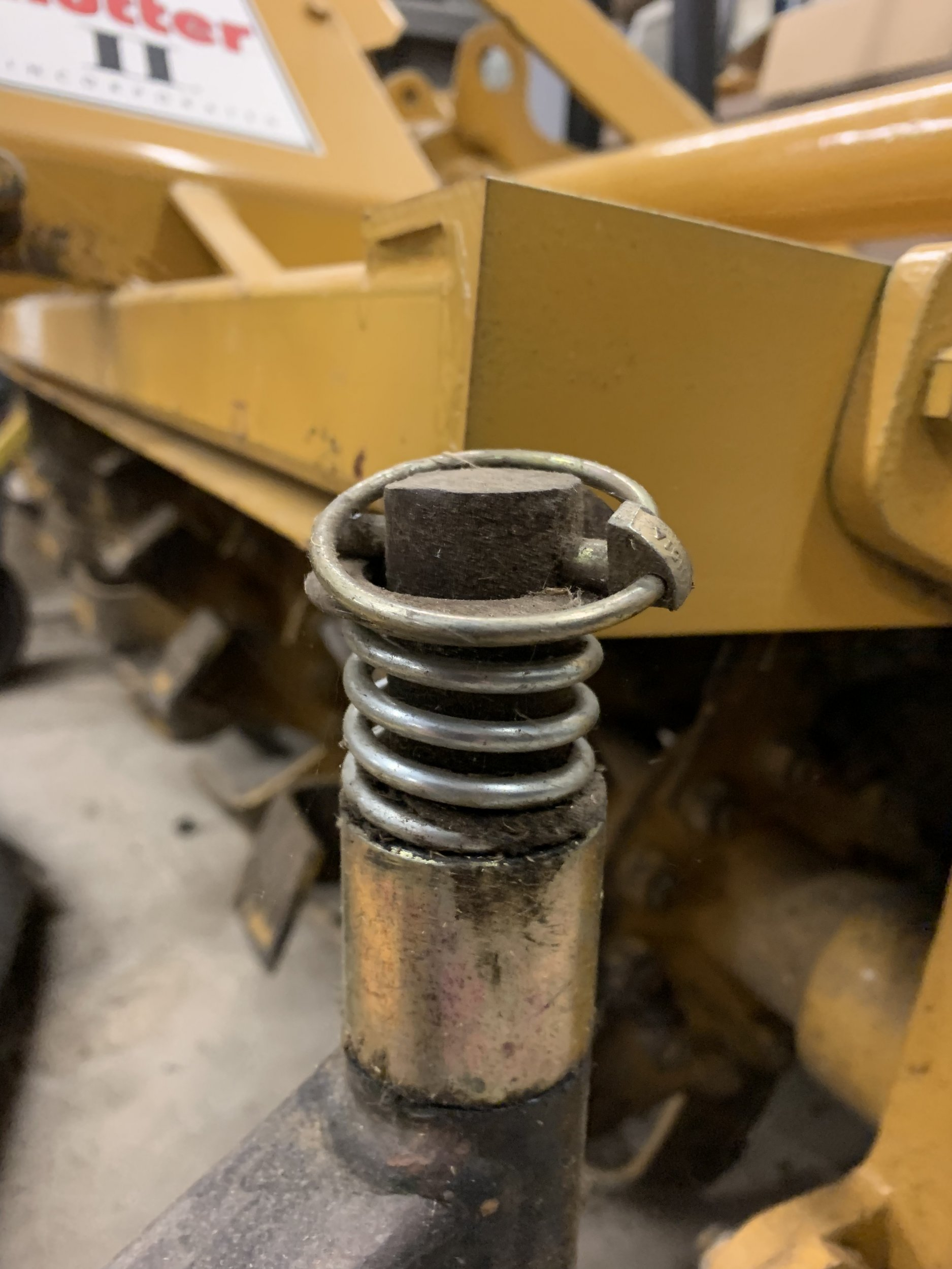

Before applying the springs the pins would rotate on their axis which made it very easy for them to come off now they have tension and stay flat or horizontal and have never lost another pin sence, hope this makes sense.
