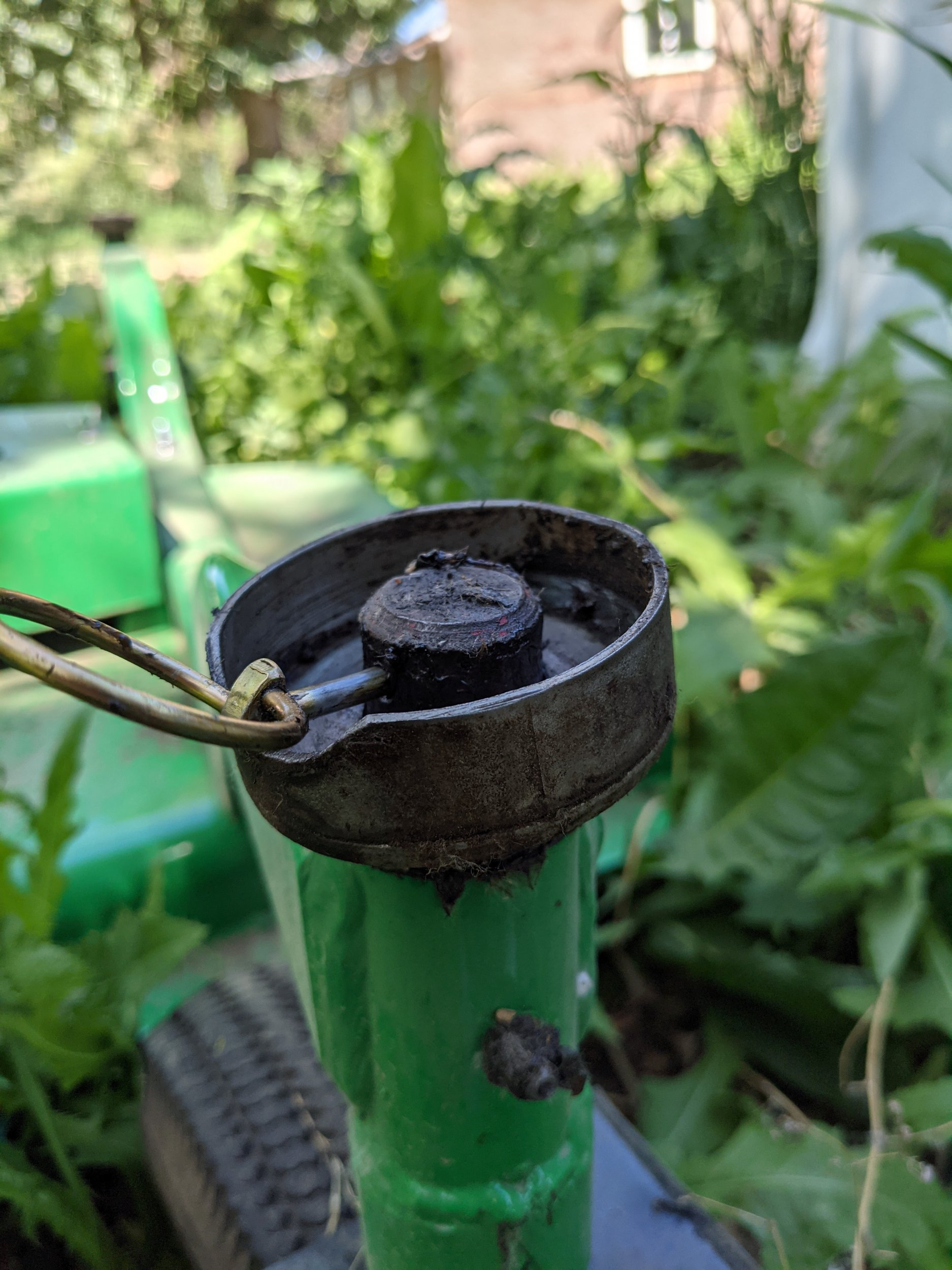

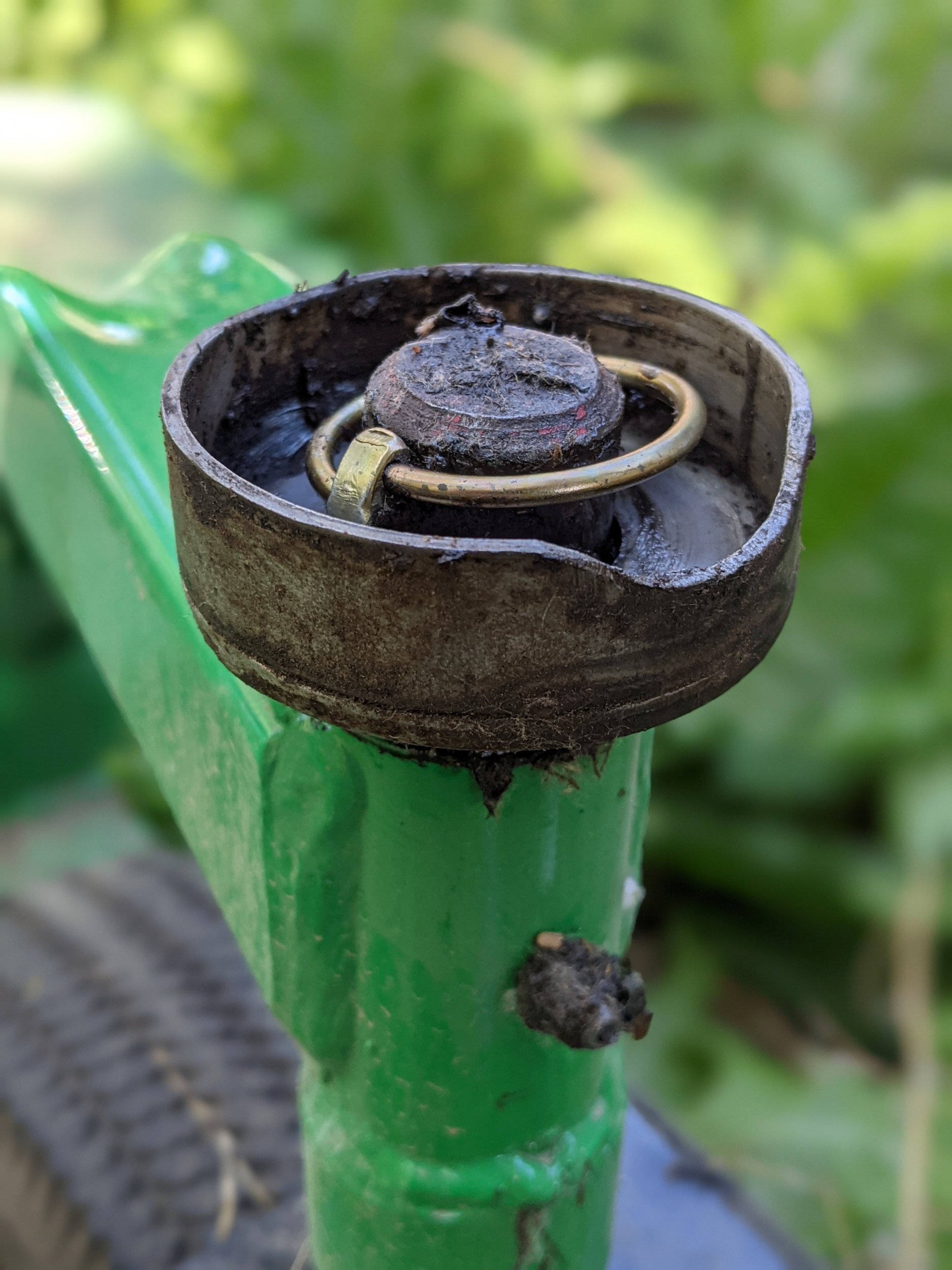

I've mentioned this earlier but a picture is worth 1000 words. These are easy to make and use and easily prevent the lynch pins from being pulled out by branches and weeds. Also no tools needed.

What is it made of, is it just a big washer and a cut-off piece of 2" pipe?

A large 1" washer with a piece of 2 1/2" OD muffler pipe welded on. The washer also has a 2 1/2" OD. Each piece of muffler pipe is ground out to fit a particular lynch pin setup. You'll notice in the second picture that the washer is tilted to enable the lynch pins removal. If the washer isn't tilted the lynch pin won't come out. It's a bit of a pain installing the lynch pin until you realize that the washer needs to be tilted just a little less before the lynch pin will slide in. Also everything needs to be alligned just right for the lynch pin to be removed. The chances of that happening I figure are pretty remote.
